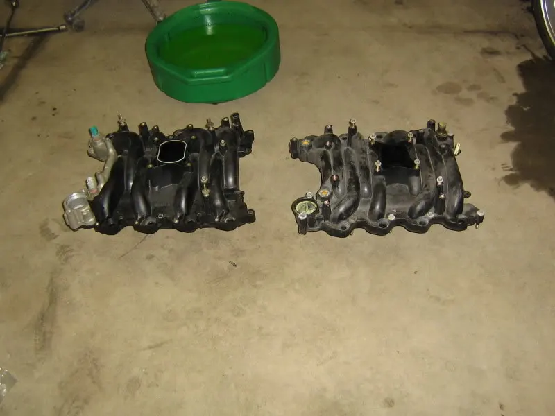

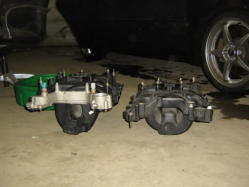

this is from my swap about a week ago

Great pics.
