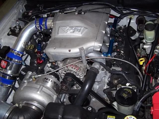

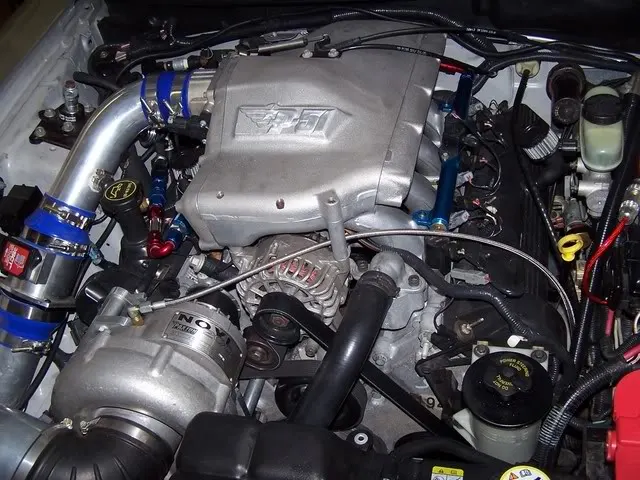

exactly what he said. you will also need a retune.
Maf will have to be like mine. just before the TB

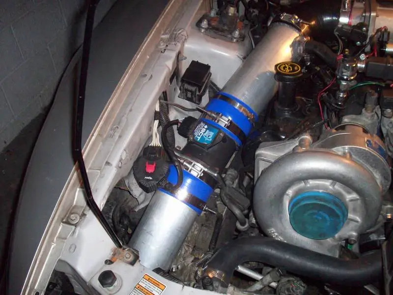

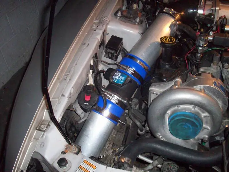

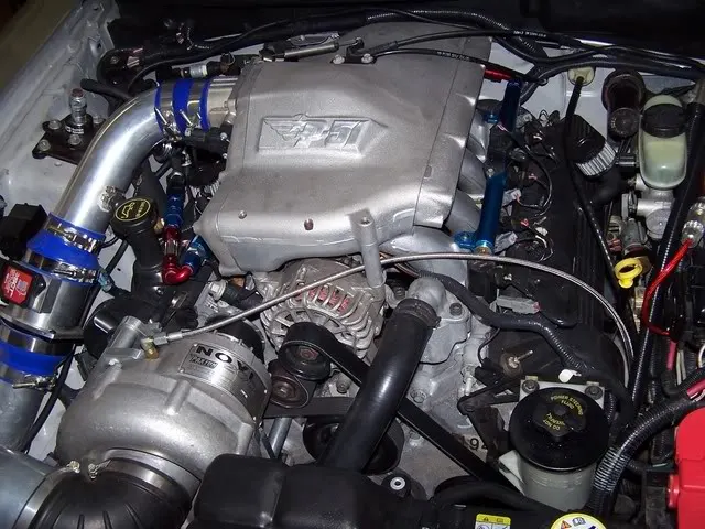

How hard was it to tune with you reducing the diameter right before and after the maf? Mines ugly, but I used 4" pipe 1' before and after the maf.
Did you also use a maf extender to support 750 rwhp with that maf? I understand your's has more range, but that's also determined by the size of the pipe it's in and the size of the pipe directly before and after.
