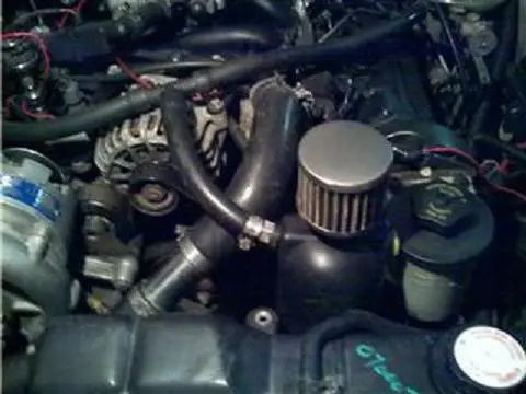

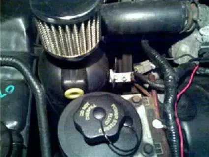

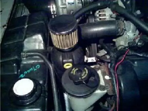

I tee both covers to a vented catch can with pcv valve gutted and everything else plugged.
I have had 3 motors in this car the stock one, a brand new stock one after that, and now a forged engine. First one blew, the second I still use the heads off of, and sold the shortblock. It's still used and drag raced in a 95 T-bird. All would put oil in the power pipe if only using separators.
Even without excessive blow by, some oil mist gets through. Especially after the little element inside the separator gets saturated. All motors have some blow by and just spinning them at several thousand RPM's kicks up of bunch oil, then your SC is sucking it out.
Have you guys every seen the inside of an intake on a stock motor after 50 k there's always s few Oz's oil in it. If you have the pcv system hooked up in the stock set up there will be some oil mist that gets through
This what I use it's a 1QT vented catch can
A link to it.
http://store.summitracing.com/partdetail.asp?autofilter=1&part=SUM-G1504&N=700+0&autoview=sku
