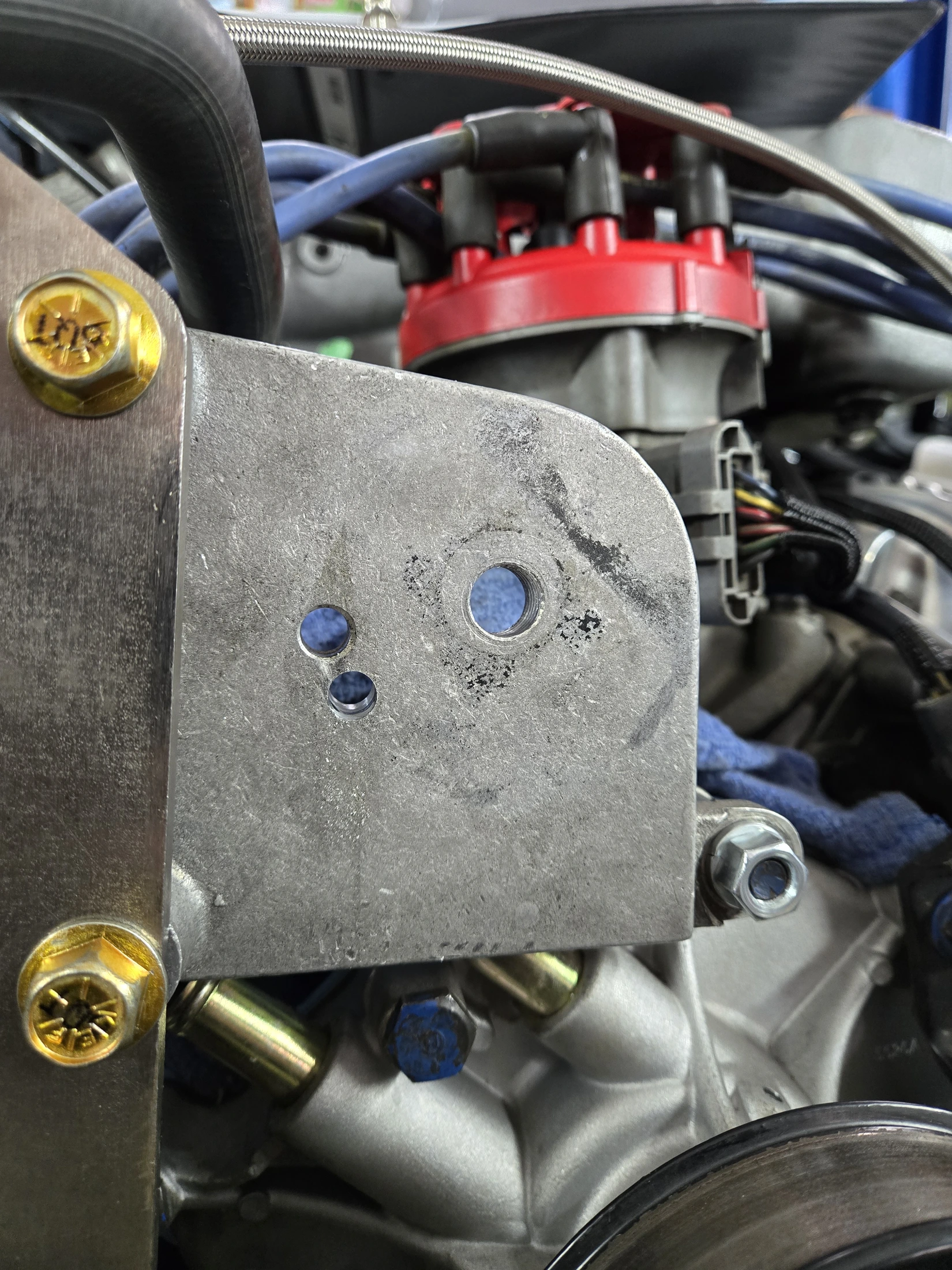

Update,
I drilled a new hole for the tensioner pin to reclock it upward, with a longer belt that slip easier on the wp pulley i have to take off the small leftover slack. I did shim the vortech alternator bracket but did not like the way it was seating and it was very difficult to put the belt on again. So i ordered the adjustable alternator bracket just like TOOLOW91 and everything should be fine. Didn't even have to change my original wp pulley for the 93 cobra !
