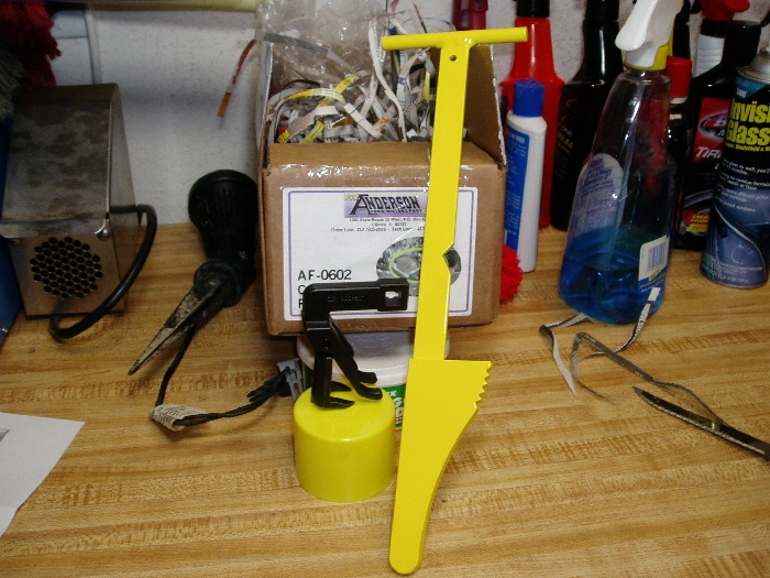

What is your impressions of the Anderson Cam Chain tool.
Did you have someone help you with the cam install. I hear that you need someone to hold the tool and the cam gear while the other installs the cams.
Curious as to how you did yours.

The anderson tool is worth its 30 bucks. I had my buddy hold the gear and the tool while i took out the stock cam and slid in the new one. It tough to get the cam into the gear the gear has to be walked off. The gear has to be almost to the front cover because the cam wont slide out through the back. I was shaking when i was trying to slide the cam into the gear. One slip with it and there goes a day job to a week job. The only complaint i got with the tool is its not that stong. doing the second cam it started to bend near the notch on the tool. :eek:

Thanks for the info. The details are very helpful. I'm about to go through the process myself.

I personally dont reccomend the anderson tool at ALL. I bought it and tried to use it...but before we could get the cam unbolted fully from the cam gear the tool slipped off to the side TWICE! Had the cam been removed..= hello removing front cover. When your moving the cam around, the cam gear follows...and the side to side motion is what caused this. Its not stable at all.
Much safer alternative. Vice grips on drivers side( NO holes in cam gear) and a nice rod (something like a jack handle, or even the end of a rachet) through one of the holes in the Pass side cam gear.
This keeps it VERY stable, and worked like a charm. I wont even sell the anderson tool to anyone, unless they absoluty insisted upon it. To me it was that dangerous. JMO though :)

Genius!!.. Would this work as well with the VT Stage 2 and vavlespring install?? :D
Well Jason, with the stg 2s your pulling the cam gears anyways...but when your ready to go back with the cams/cam gears then sure it will definatly help at that point :nice: . I dont think you can use the anderson tool anyways when doing stg 2s...its designed to work with the front cover on.(IE just pulling the valve covers to install mild cams)
I would just use vice grips on both cam gears for your application. :nice:
