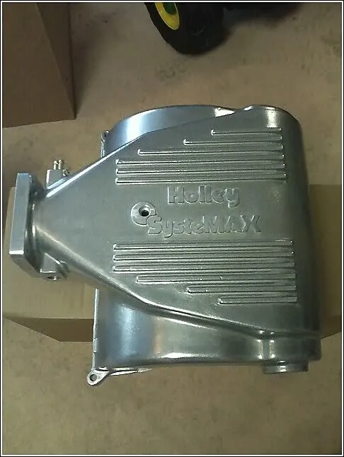

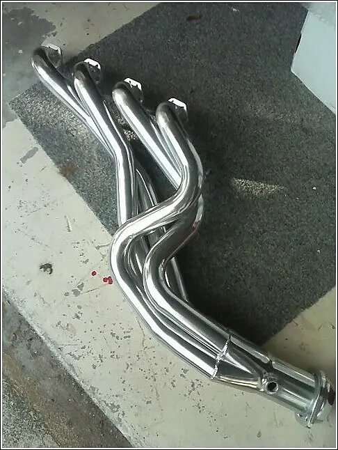

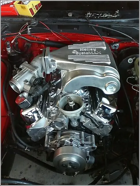

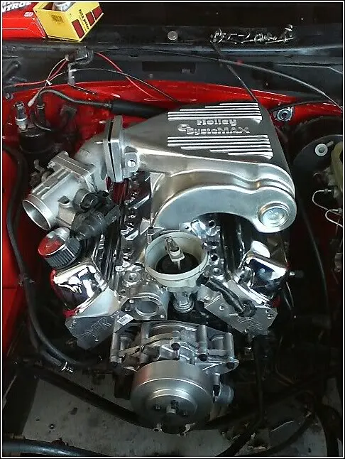

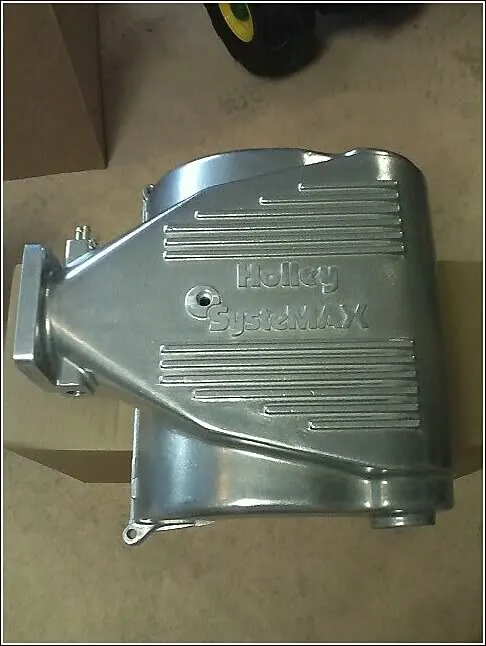

Systemax Intake and retune and I'll be you hit that number. I've had both intakes and there was no way I was putting the Edelbrock on my 347. I also went overkill on the exhaust 1-3/4" Ceramic LT's w/ 3" Collector and 3" exhaust all the way back. This would also benefit you as well.

I'm not an Edelbrock fan because they are impractical. I do recognize that the intake does perform well though. It's pretty hard to beat a Systemax though.
