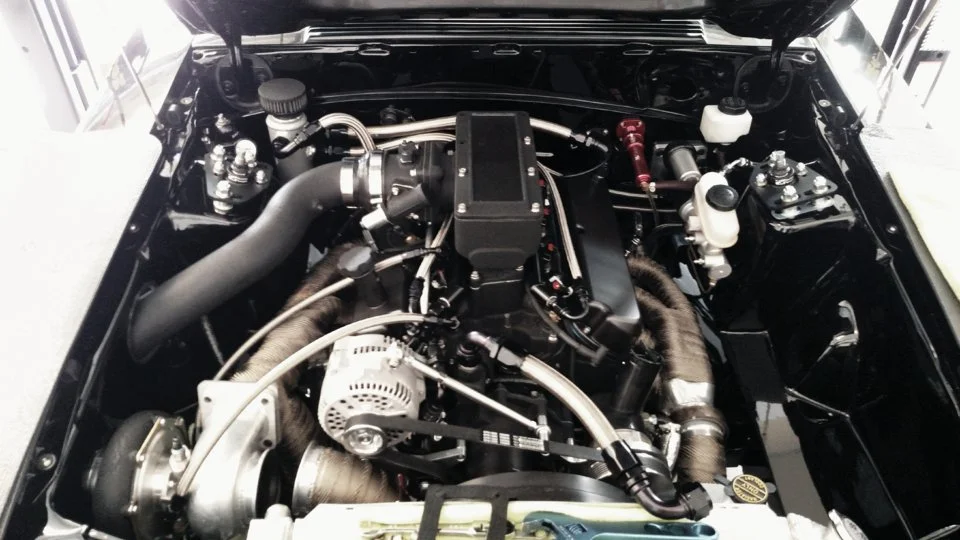

Progress has been painfully slow, but it's almost ready to fire up. Hopefully in the next day or two. I really want it drivable for this coming weekend.

So she started up tonight. Not right away, and not perfectly smooth, but she started nonetheless. The cold idle tune wasn't finished the last time I was at All Out, so I had to keep my foot on the throttle to keep it running. I also wanted to do that to keep the a/f from going too rich. There was so much crap burning off the headers, that it was hard to tell if the breather was smoking or not, but my other half was watching the tailpipes and she said that she just noticed some gray smoke when I burped the throttle. No white smoke other than the very first time it fired up. Nothing wreaked of fuel, unlike last time when I couldn't even stand in the garage for more than a few minutes without getting dizzy. I believe the rings and cylinder walls are safe now.
It's breaking up real bad above 2500 rpm. I probably have the timing off a bit. I also think the #5 plug wire wasn't all the way on because that plug was cleaner than a few of the others that I checked. The boot was also not sitting as far down as it should be. Those damn plug boot heat covers make putting the plugs on all the way a real task.
The water pump seal is leaking like crazy. It's not the water pump to timing cover gasket, but the actual rubber seal between the pump motor and pump housing. I took it apart when I painted the pump and put in a new seal. Something is off though. I'll pull it apart when I take apart the hotside. I'll probably run a thin bead of rtv around the seal to put an end to that mess.
The good news is that the oil is clean and so is the coolant. I also haven't seen any signs of coolant running down the block. I'll let her cool off and then I'll tackle taking things apart tomorrow so I can torque those heads down to spec.

So the driver side was a breeze. Disconnected the header from the crossover, removed said header, removed valve cover, loosened each head bolt and re-torqued to 110ft-lbs one at a time. Everything was apart and back together in around an hour and a half. The passenger side was more of a hurricane and not so much a breeze. Taking apart all that junk just is not a whole lot of fun. I did manage to sneak the turbo and header out without needing to completely remove the downpipe. That saved a good amount of time. The one damn header bolt on the #2 primary put up a huge fight. There just isn't a lot of room in there to work with.
I got as far as torquing down the head, but that's it. Getting to that point took about 2 hours. It will have to wait until tomorrow to go back together completely. I then need to drain more of the coolant so I can remove half of the water pump without drenching the crossover pipe in coolant. I'm also going to change the oil. I'm not taking any risks this time with fuel contamination. The car did get a little rich at times when I was first trying to start it, so I feel better knowing there is fresh oil in there. Once all that is done, I can play with getting the timing all synced up.
