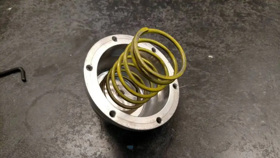

So, I opened up the wastegate today and I believe I found the problem.
I knew I had a yellow spring, which according to Tial is an 8.7psi spring. The issue is that spring pictured is not a large spring, it's a small one. The small yellow is rated for 2.9psi. When I originally checked the spring with my untrained eye, I didn't even consider the fact that there are large and small springs the same color. Duh! That completely explains not being able to hit the higher boost numbers.
