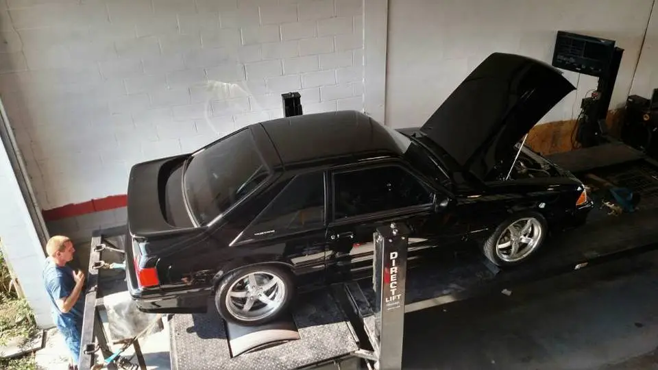

Yesterday went very well overall. The cooling system was put the the ultimate test in the 91 degree humid weather we had. She handled it quite well. That Taurus fan moves some serious air!
As with any dyno day, there always seems to be a little bad with the good.
The good:
- The driveability is excellent now. The car starts fine when hot and idles within 50rpm (900 rpm idle). It does great when on and off the gas in a parking lot and doesn't show any signs of randomally wanting to stall. I'll still have to see how it does with cold starts. Some adjustment may be necessary there.
- There is no excessive smoking on the dyno. She puffs a very tiny bit on decel, but it's hardly noticeable. The breather doesn't puff visible smoke at all. I think the rings are happy. I'll be doing an oil change this week.
- Nothing blew up or failed. That's always a win.
The bad:

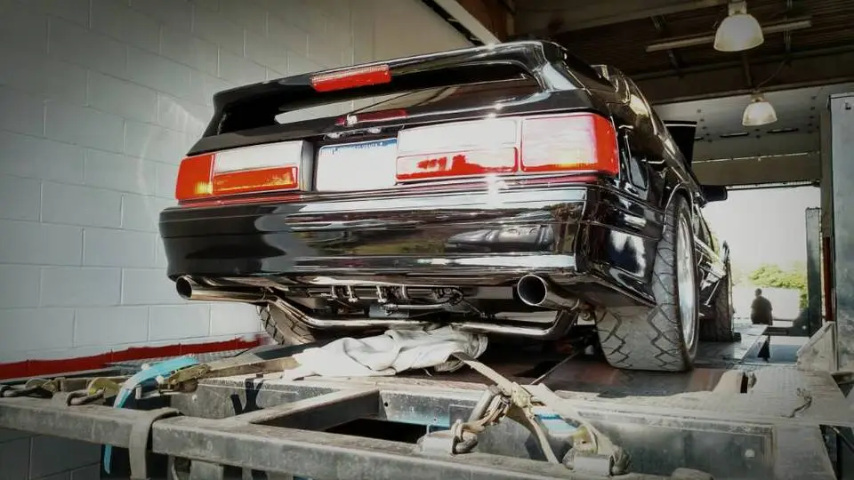

- I'm still having a boost problem. I thought it was due to the boost leak at the blow off valve, but the engine still isn't making boost off the wastegate like it should be.
The possible culprits could be a bad gate diaphragm, backpressure issues, as well as needing a higher rate spring in the gate. Frank, the tuner at PSI, thinks there is a definite backpressure problem. He blames the 2.5" catback and mufflers. We would increase the boost, but the car wouldn't make anymore power. His suggestion was to install an electric exhaust cutout if I'm interested in seeing how much power the car is really capable of making. I like how quiet and unassuming my car is, so a cutout would be a nice way to let the car scream, but only when I want it to. That will be a winter project. I'll need to fab a Y pipe and wire it up.
On his Mustang dyno, the car made 600/600 at 15 psi. Max power was only at 5300 rpm, which apparently is another sign that there are backpressure issues.
Despite the issues, which really aren't a big deal at all, the car rips. We took it for a drive to confirm the driveability. I rowed through the first few gears and could help but smile and nearly giggle. I can finally enjoy the car for the rest of the year. I'll shoot for big numbers in the winter. An exhaust cutout and probably some menthol injection will be on the horizon to get me close to that 800hp range on 20-22psi.
