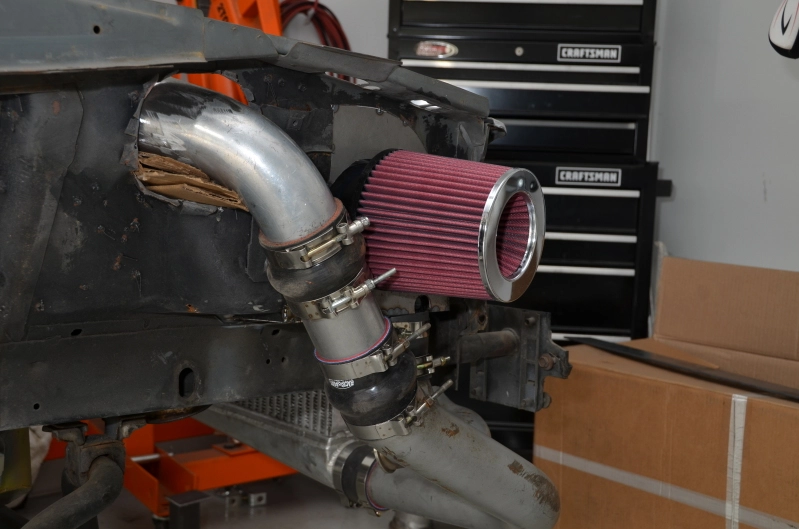

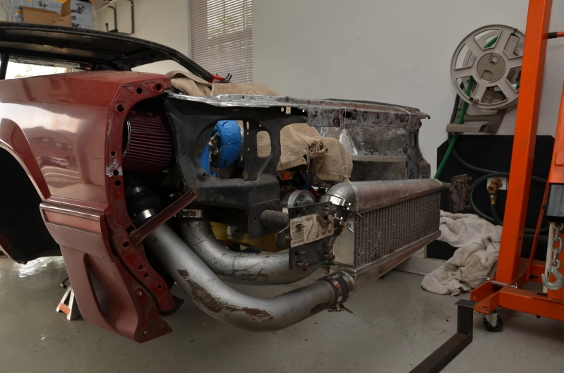

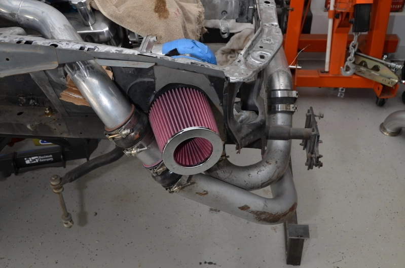

My S&B air filter showed up this week. Thanks to Rick for locating one with an angled neck. I test fit the passenger fender to make sure everything will clear inside of it, and I think I'm going to be fine. I just need to test fit the intercooler one last time to make sure my coldside piping will clear the inside of the fender. Pictures to come soon. My weekend goal is to get done what I need to so I can get the engine out and back on the stand.
LOL.....I removed a large portion of my inner fender and was plotting on using my fathers sheet metal roller to fill it in. I mught hold off and just weld portions around the turbo cut-out. Keep the pics coming:nice:

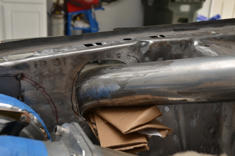

Got a small amount of work done today. I checked clearances between the air filter, coldside piping and fender. All is well. It's tight, but it will fit.
(that's what she said) :eek:
Here are some pictures:

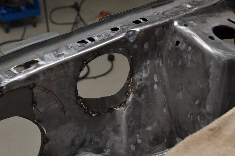

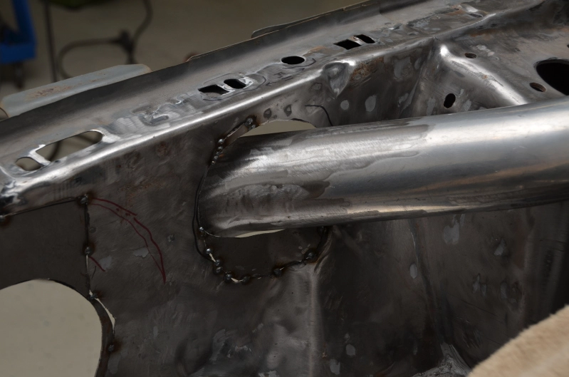

Obviously, I can't have pieces of cardboard filling up the space in the hole for the discharge tube, so I cut some pieces and welded them in to tighten up the opening.
Finally, everything is all tacked together and ready to be fully welded:

Definitely better than the big hole I used to ensure there were no clearance issues. I'd post a pic if I could figure out how with the new forum setup. How are you mounting the IC? I'm not a huge fan of HP's one bracket hanger like I currently have.
The entire coldside is 3". That includes the outlet diameter of the compressor housing.

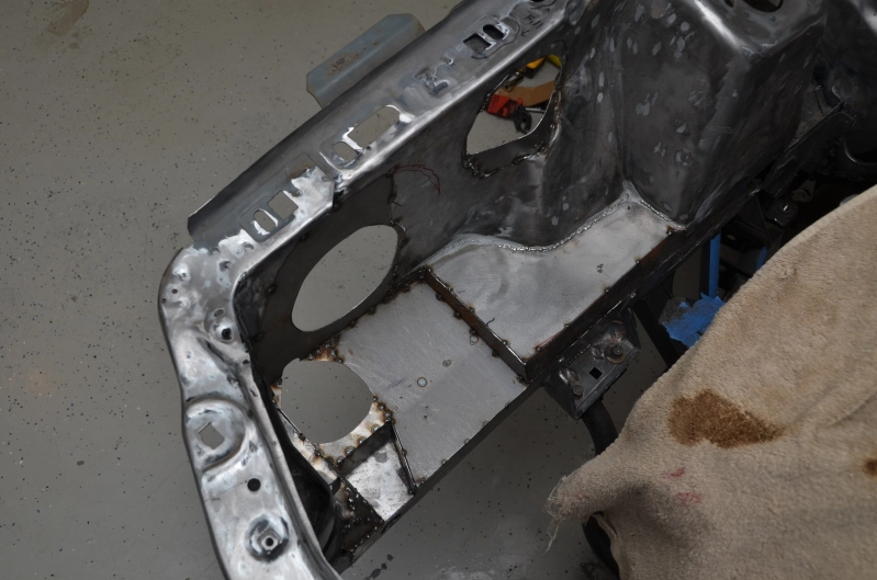

When are we gonna get to see a pic of what that hole looks like all blended in after you weld the **** out of it?
I hope I can weld the :poo: out of everthing this week. That includes the rest of the holes in the engine bay that will be smoothed out. I just need to pick up some 18 ga steel. I have some 16 ga laying around, but it's so much easier to work with 18 ga when trying to cut out circles with tin snips.

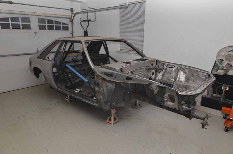

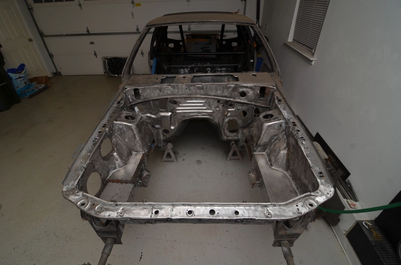

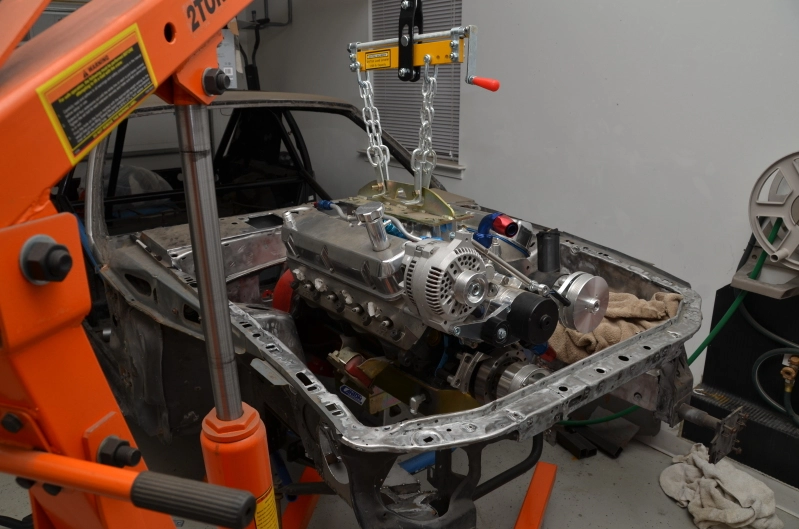

Engine is now out along with the trans, k-member, and IRS subframe. It's back to a shell...once again. I forgot that I had the cherry picker at the 1 ton mark instead of extended out to the 1/2 ton mark, so I was barely able to lift the engine high enough so the oil pan would clear the inner fender. I wouldn't have been pleased if I had to lower the engine back down again to adjust the hoist.

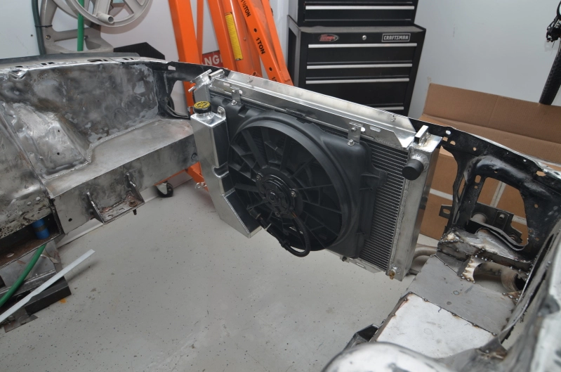

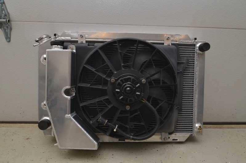

I did manage to fab up some brackets to mount my Taurus fan to my radiator. Took me longer than expected, but I move slow. I would be a terrible shop employee.

Yea, a member on here suggested it to me. I like it a lot. I think I'm going to have it powdercoated to match my intake manifold and valve covers. The brackets will be powdercoated as well. I figured the more natural aluminum I can avoid, the better. I really don't want to deal with the upkeep of it.
