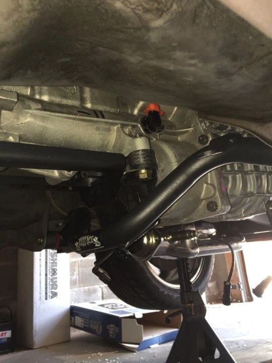

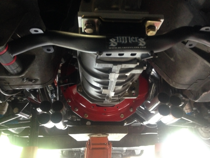

what size is the return? Also, a few dragweek guys are actually using transmission coolers as a fuel cooler with a fan on it for the long drives.
Is your crossmember backwards, or is mine?

8an return.
Mine wouldn't bolt up to the trans if it's facing the other way, so I didn't have a choice. I don't think it can be backwards. What trans is that? T56?

Liberty lsc 5100, i forgot you had a t-56, that explains it.

I don't, actually. I have a TKO 500. I want a T56 though!

hmm I have a 600 same case and mine fits the other way . Your not the first I have seen This with either

yea mine was also for a TKO-600 originally and i used a adapter to set the driveline angle and use the stifflers crossmember. Interesting the the 600 goes the other way.

Mine was for my t5 I just used the tko kit that came with it when I bought it

So I guess I'm the only one using a stock crossmember with a tko these days?
Other than the looks, is there any real good reason to use the stiflers over a stock one? I can't see it really being any lighter.

It's a nice solid piece and doesn't have anywhere near the flex my stock did

After looking on Stifflers site, there is a very good chance that I have the T56 crossmember. Oh well, at least I won't need to change it if (read: when) I switch to a T56.
