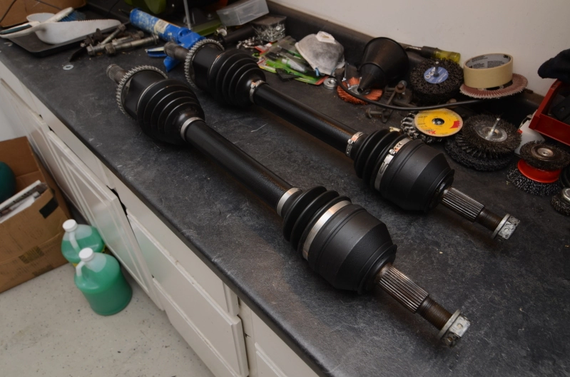

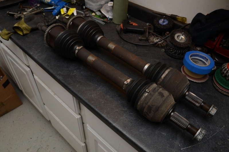

Cleaned up the IRS half shafts tonight.

Yes. Stock 03 Cobra shafts. They 'should' hold up fine. Most of the strength issues associated with the IRS are taken care of by replacing all the rubber mounts with delrin bushings. This will eliminate wheel hop, which is what kills the half shafts. I spoke to Bruce at FTBR about it, and he feels that I will not have any issues at all. There are guys with 700hp Cobras launching on drag radials and aren't breaking shafts thanks to better housing mounts and the delrin bushings. Most of my power will probably never make it to the ground anyway on the street.
