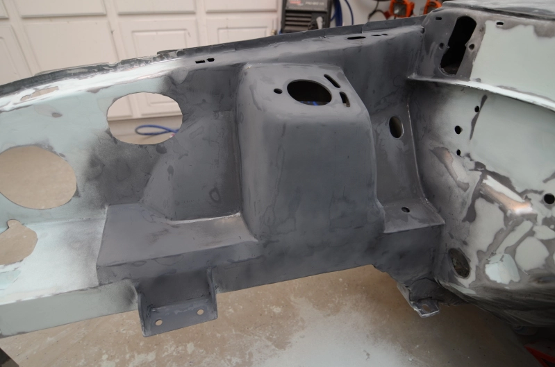

Put on a skim coat of putty. Was able to get the passenger side sanded down.
Shot the strut tower with acrylic primer just to get an idea how smooth it all is. The primer is not a filler primer, and there seem to be very few imperfections. Paint was still drying, so it looks a little wierd.
Should look real good when 4 coats of filler primer are put down on it.

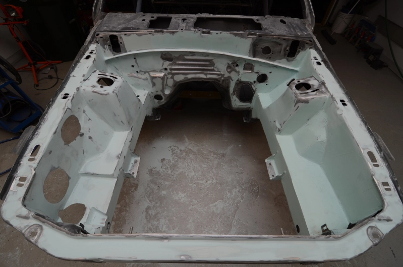

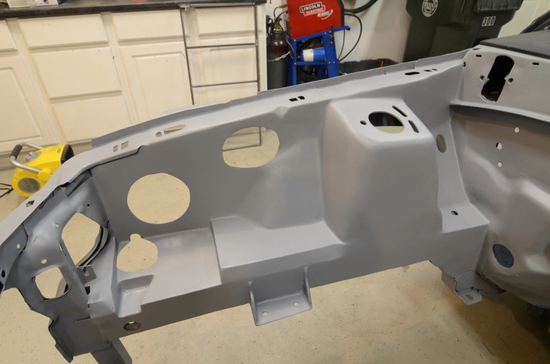

Been working on the engine bay for the past few days. Nothing picture worthy though. I've just been sanding and sanding and sanding. Trying to get it as smooth as possible before I shoot the urethane primer. The corners are the worst to get perfect, and I don't want to rely on the primer to fill in pits. Expect more updates on Sunday after the primer is shot.
Yeah, getting filler perfect with no pits, waves, etc can be a bitch. It is easier on a flat surface but you are right about the corners... Try doing it on motorcycle race fairings that have been down. THAT is a PITA.
Yea, its rough. I'm not trying to get everything in the engine bay arrow straight, but I do want it to all be as smooth as possible. I probably have about 30 hours of body work into the bay right now. At least another 10 left. That doesn't count the 120+ hours spent on cutting, welding, and grinding prior to any filler work being done. Labor of love I guess!

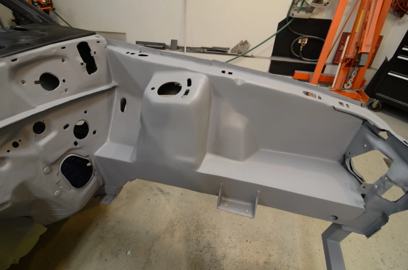

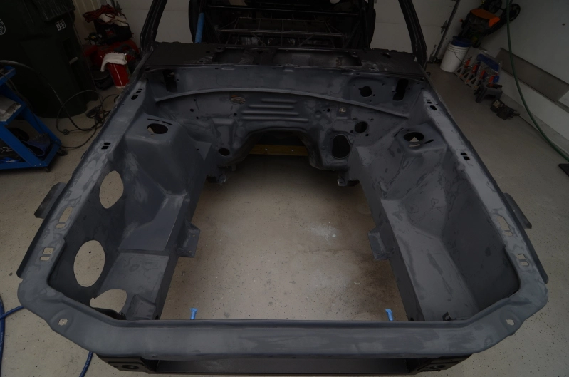

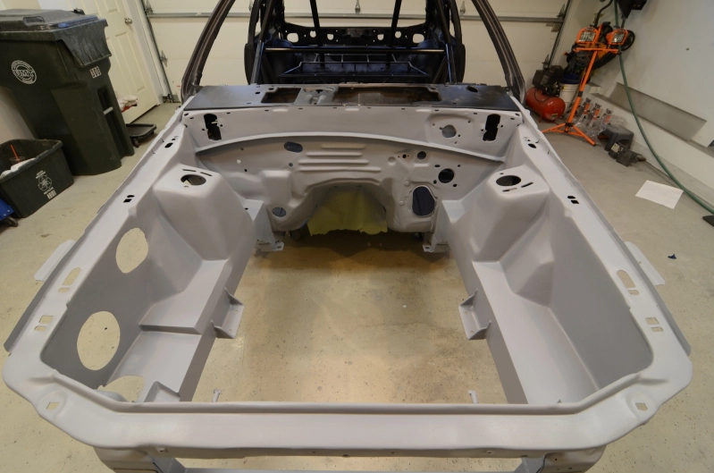

Shot the whole bay in a light coat of primer just to get an idea of what imperfections are still lingering. Not many, but I do need to touch up some pits along the inner edges. I'll get that done tomorrow and then on Sunday I can spray the urethane primer.

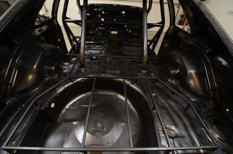

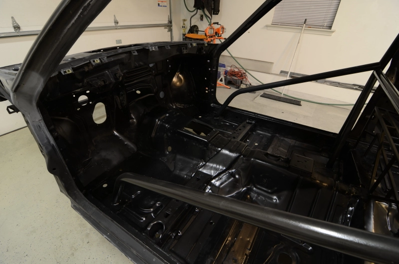

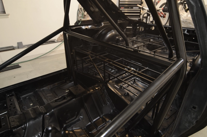

Shot the interior with some chassis paint today. Will be topcoating it with Raptor liner later in the week probably.

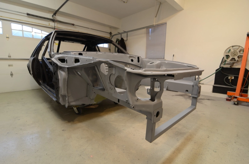

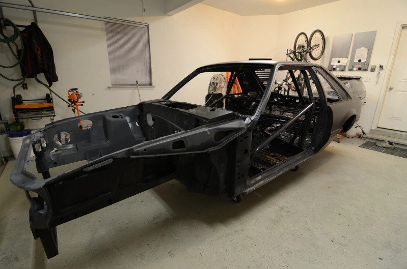

Car will juuuust about be ready for paint after I primer the front end tomorrow.

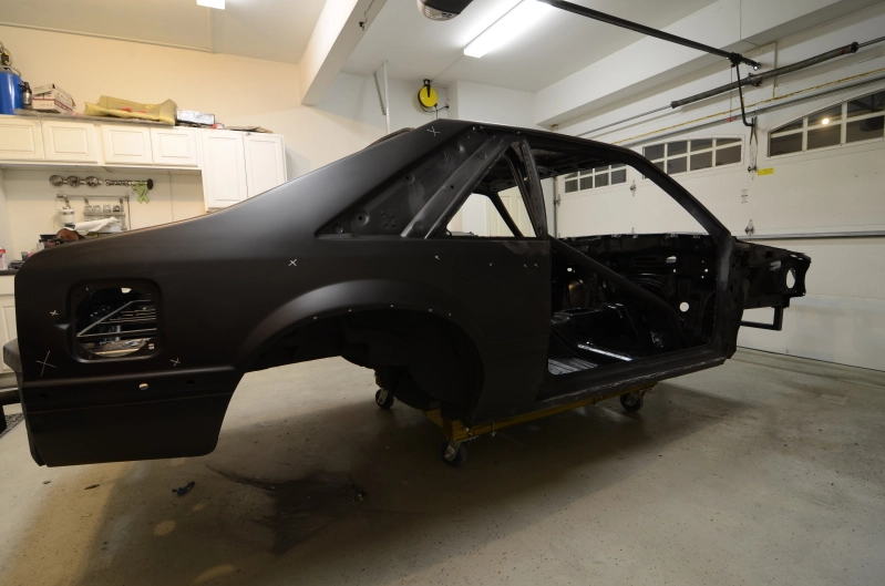

Marked up the dings and imperfections as I continued to find them. The body doesn't have anything major, but it does have a decent amount of small dings. My painter will be busy.

Shot 4 coats of urethane primer today. I have to sand it smooth and then assess how many imperfections are left. I can see a few right now, so I will probably a need to spot putty a couple trouble areas. Other than that, it looks real nice.

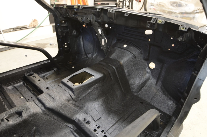

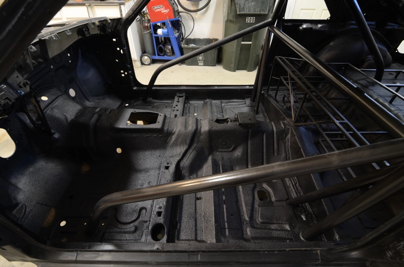

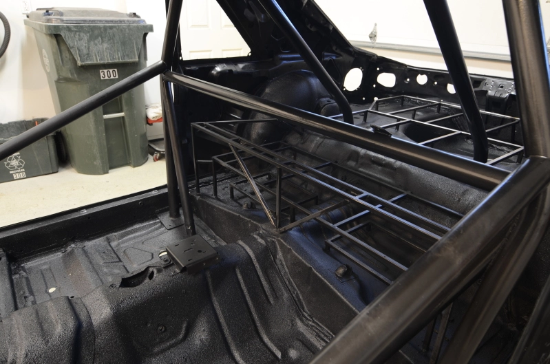

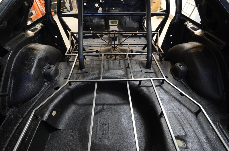

I was feeling ambitious after painting the bay, so I decided to shoot the Raptor liner in the interior as well. Came out pretty well. Still have to paint the rollbar and the mess of steel in the back seat and hatch.
