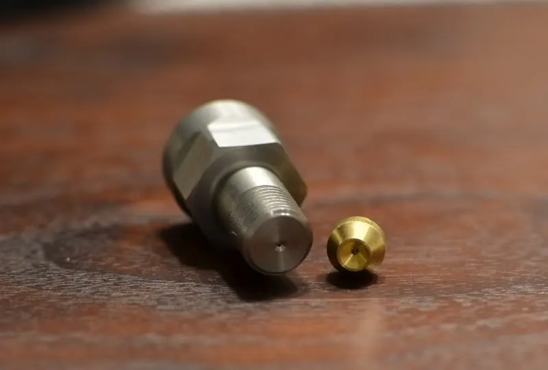

Yup. A tiny one at that. I ordered it directly from Comp. Here it is next to a typical brass journal bearing restrictor.

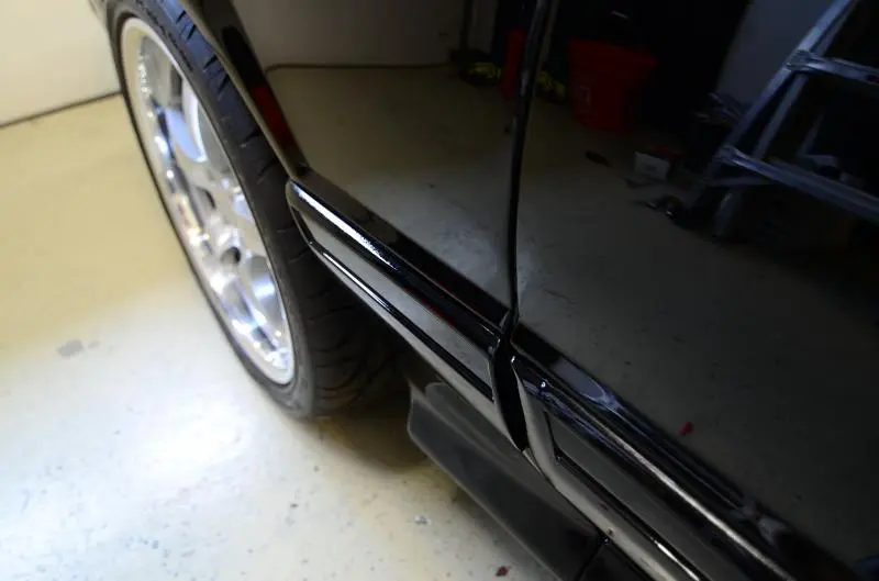

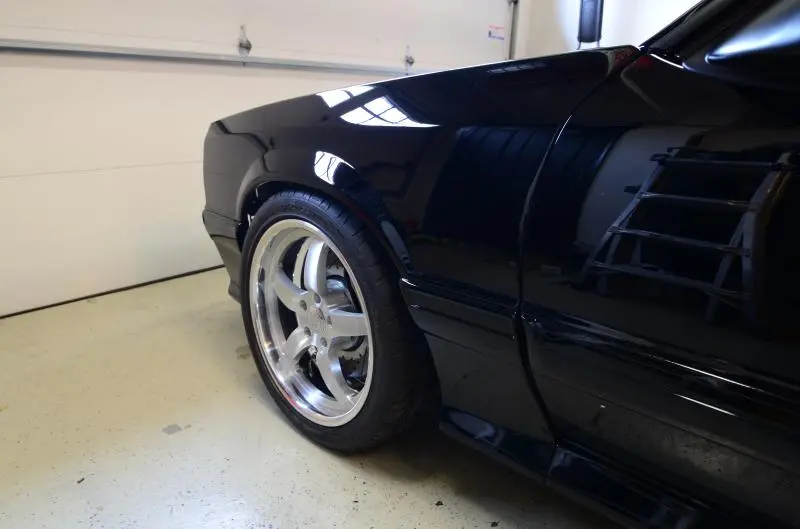

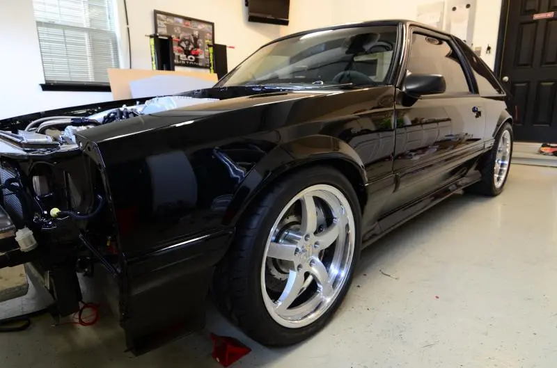

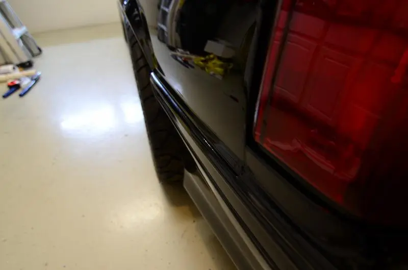

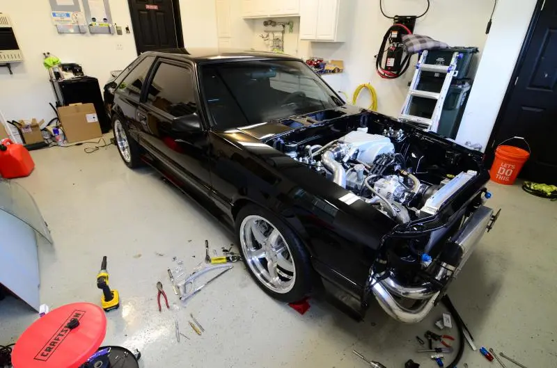

So I got the front fenders permanently mounted up. What a pain in the @ss. After I got the fenders somewhat bolted in place, I realized that the front of the doors were sitting too low. The molding lines were off a good amount. I had to raise the height of the doors in the front, which throws off the alignment to the strikers in the back. So, my previous efforts to get the doors to close nicely were done in vain. I had to go through the whole process all over again. It took quite a bit of time to get everything where it needed to be, but I finally got it there. The gap to the cowl on the driver side is a tiny bit larger than I would like, but I'm probably the only one that will notice. I also mounted up the rest of the Cobra fender extensions. I cannot stress how great the OEM stuff fits. The tops are tight against the body and fit great. No double sided tape or anything like that. All the gaps are perfect, IMO. I'm happy I ditched the Cervini's stuff a while ago. I was not impressed with their Mickey Mouse mounting points.

Now, let's see pics with the fenders on!

The gaps on all the Cobra pieces are great. Couldn't be happier with the fitment.

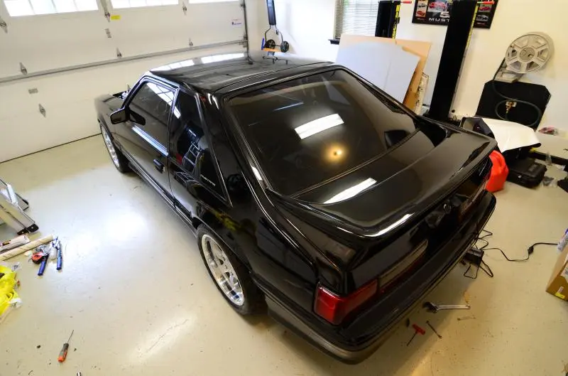

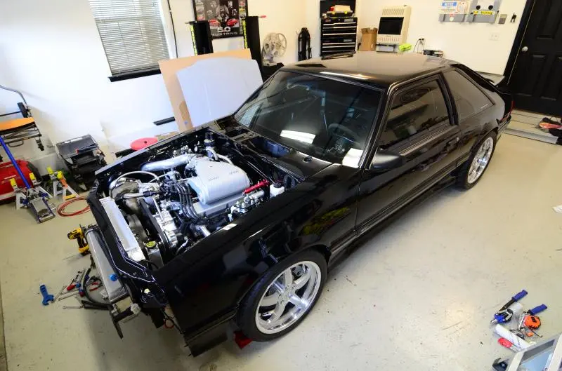

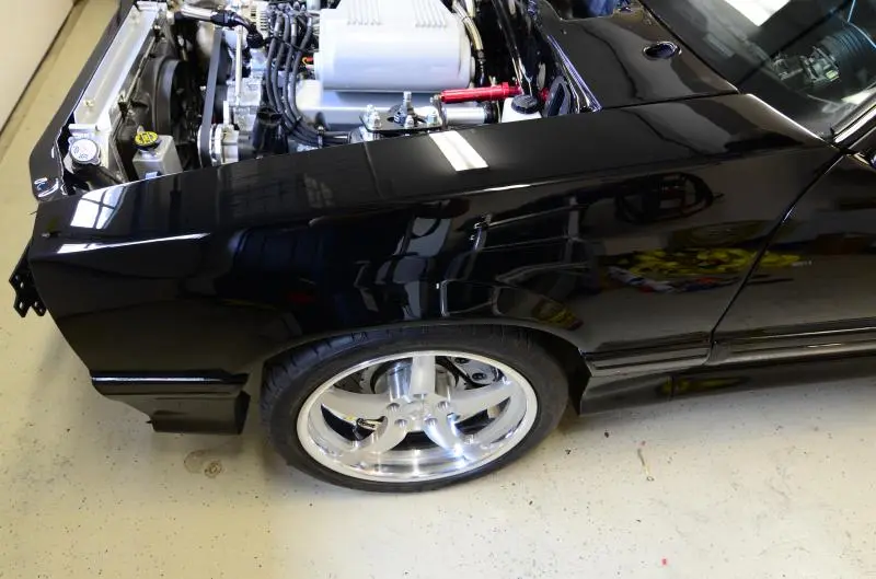

And just a couple of full pictures
