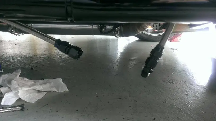

I can't wait. I'm real excited to just rip it around the block a few times once I get my fuel pump back and fix my return line that developed a "leak".

My little fuel line issue is taken care of.
