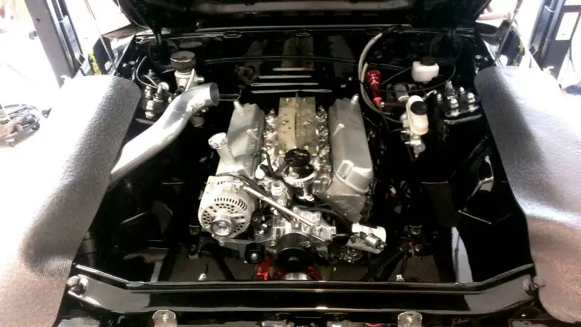

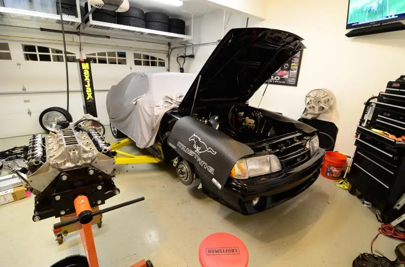

All ready to come out. I need to haul my engine hoist up from the basement, so that can wait until tomorrow.
While the engine is out, I'm going to use that opportunity to wrap the rest of the hotside. I'm also going to eliminate some of the polished parts in the engine bay. I have grown very fond of wrinkle black engine parts, so I may spray those polished parts with that paint. We shall see.

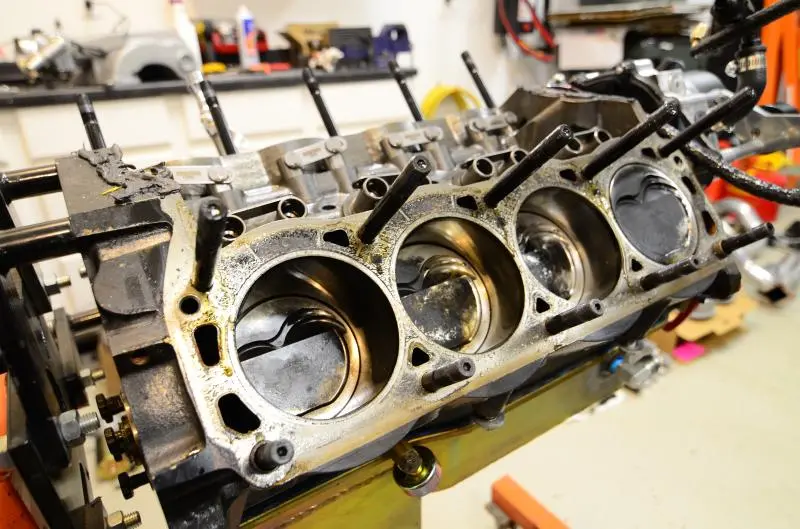

And she's out.

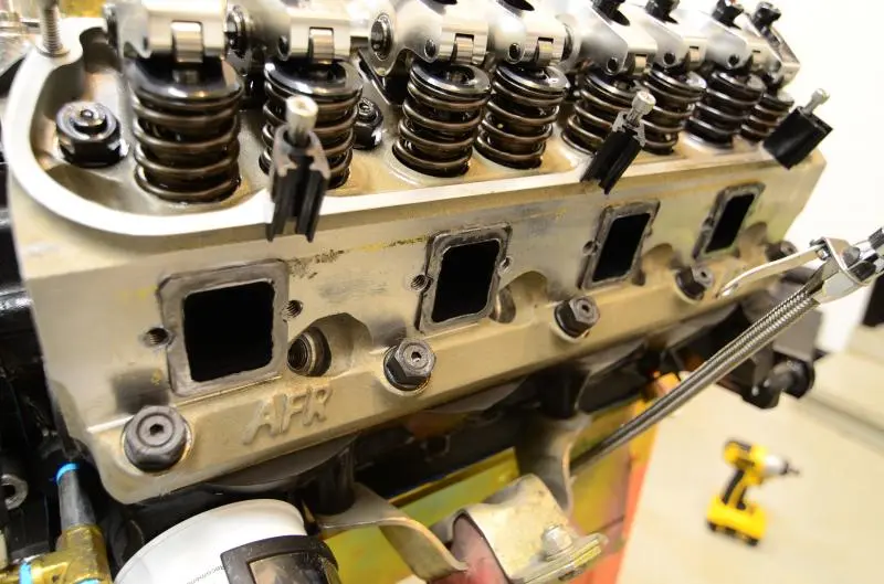

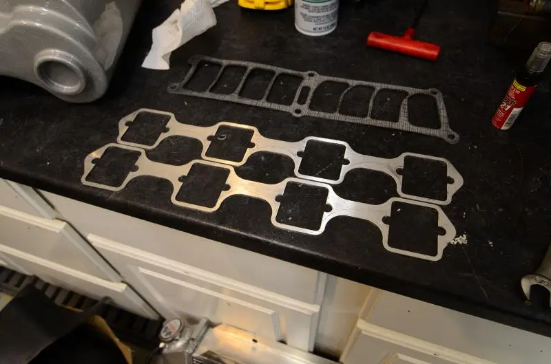

One thing I was curious about what how well the headers were sealed to the heads. The Earl's graphite gaskets I have are awesome. Not a single leak at the heads. I definitely recommend these things.
Got the heads off soon after.

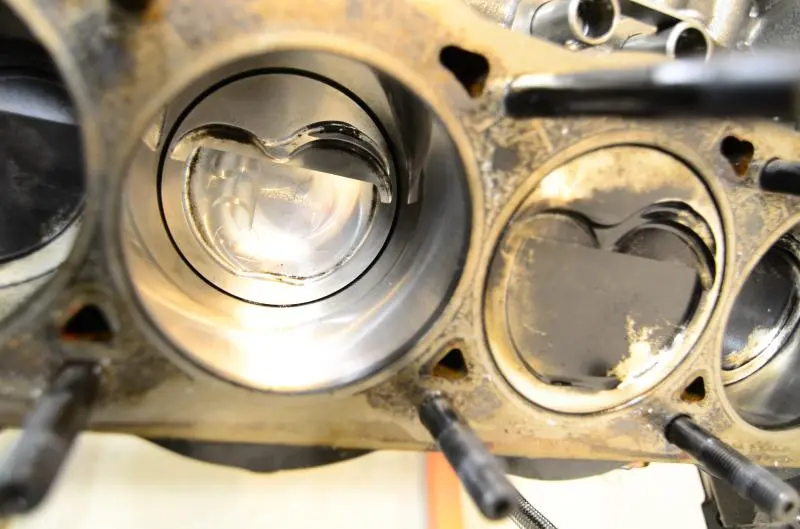

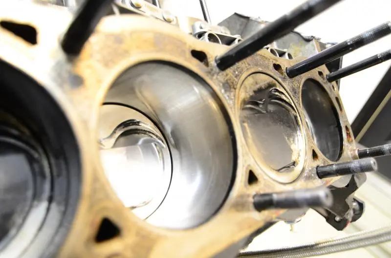

I cleaned up one of the cylinders to inspect the walls. No crosshatch to be seen anywhere. I'm no engine expert, but it's my understanding that the crosshatch should be visible throughout the usable life of the engine. There is also light vertical scoring in the bores.

Ouch man. Definitely on the crosshatch. For the sake of comparison, I picked up a 150k-ish miles 351 this weekend from @Boosted92LX and the cross hatch is still visible on the walls.

No visible cross hatch is definitely lending itself to your wash down and ring seal issues. Gil and Eric (at Davis race engines) are two of the best guys in the business as far as I'm concerned and you will be in very good hands there!
I really like those header gaskets too by the way. You have a part number for them? I would like to use something like that on my brothers 363 that Gil just finished up a few months ago

http://www.summitracing.com/parts/ear-29d03aerl
Once you have the aluminum frames, the insert replacements are around $18 for a set of 8.

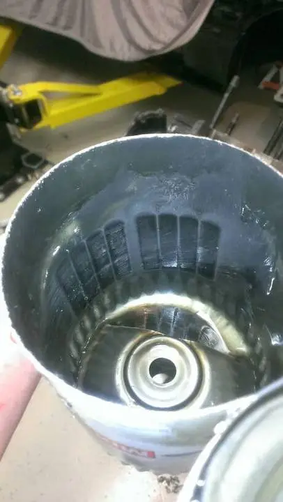

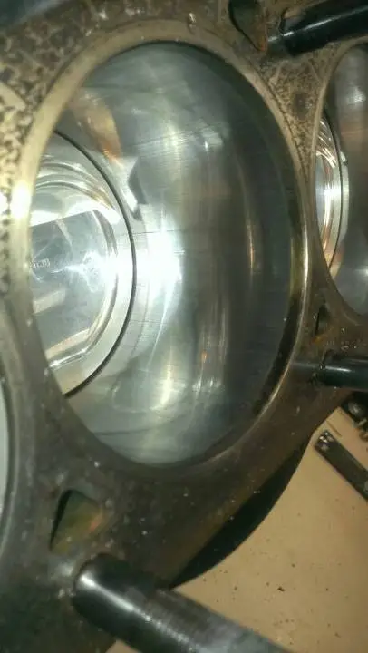

I know when I yanked out my 110k stock block, there were still crosshatch marks on the walls also. The vertical scoring is also concerning to me. Definitely tells me that oil isn't staying on the cylinder walls. Also, my oil pan plugs have magnets on the ends. When I drained the oil, there was a decent amount of metal "paste" stuck to them. I'm sure it came from the cylinder walls. I have a filter magnet on my oil filter, so I'm going to cut it open and see what that looks like.

So that's where my cylinder walls are hiding. That's even after I wiped the inside out with a rag to see it better.
Closer pictures of the walls.
