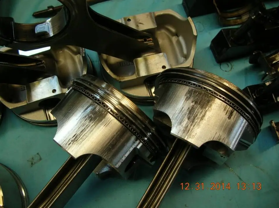

I heard from the engine builder today. Good news and bad news. The good news is that the rod bearings and cam bearings are okay. The bad news is that the pistons are not. There are signs of excessive heat and metal transfer on the skirts. He does not recommended re-using them, so I'll need to order a set of 0.040 Probe pistons. Eff. The crank bearings will also be replaced.

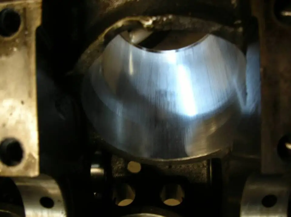

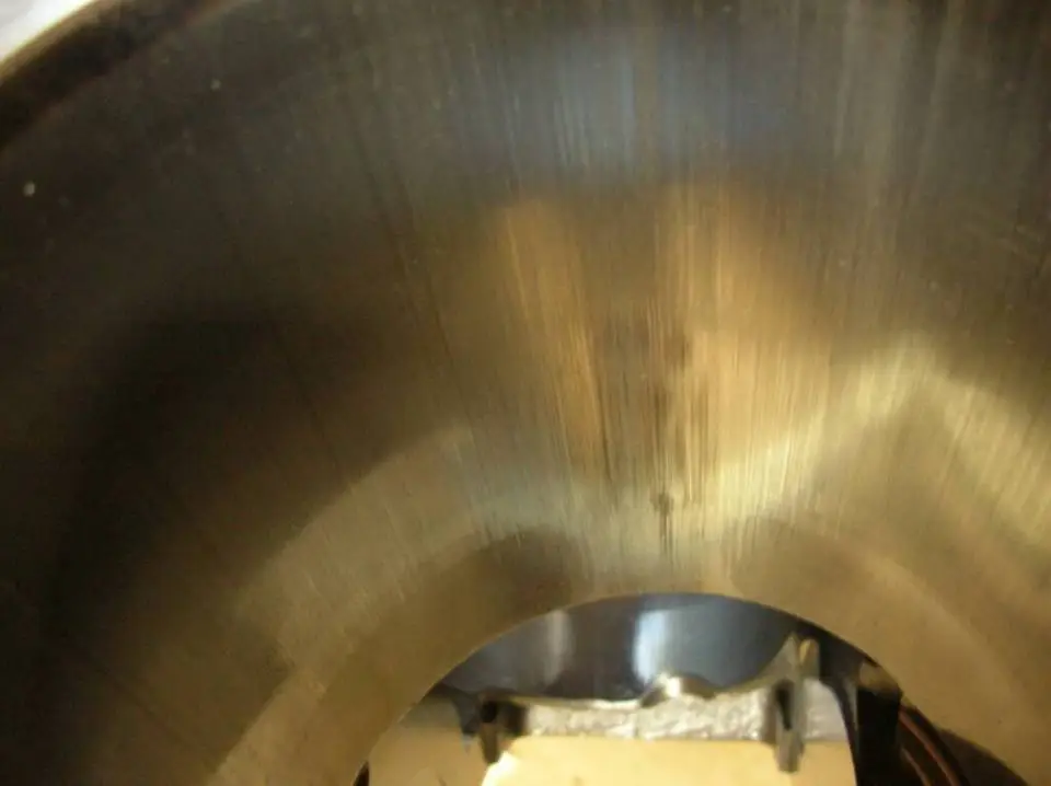

Apparently the cylinder walls were washed down so bad that there was literally no oil on the walls anymore causing metal-to-metal contact between the skirt and cylinder wall. That created too much heat and caused enough damage to the pistons to make reusing them questionable. He said I could possibly get away with using them if I really wanted to, but he's confident I would have issues down the road. The fuel content in the oil also contributed to the scuffing on the crank bearings. I never imagined washing the walls down for a few minutes would wreak so much havoc. Hard lesson learned from all this!

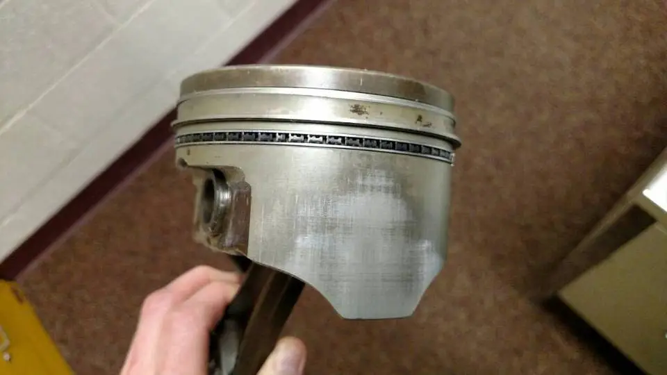

Here's the damage. Not pretty at all. The stock 100k mile pistons I took out of the original engine looked better than these. 100 miles and 8 pulls on them. They will make very nice ash trays. Too bad I don't smoke.
Stock 100k mile piston for comparison.

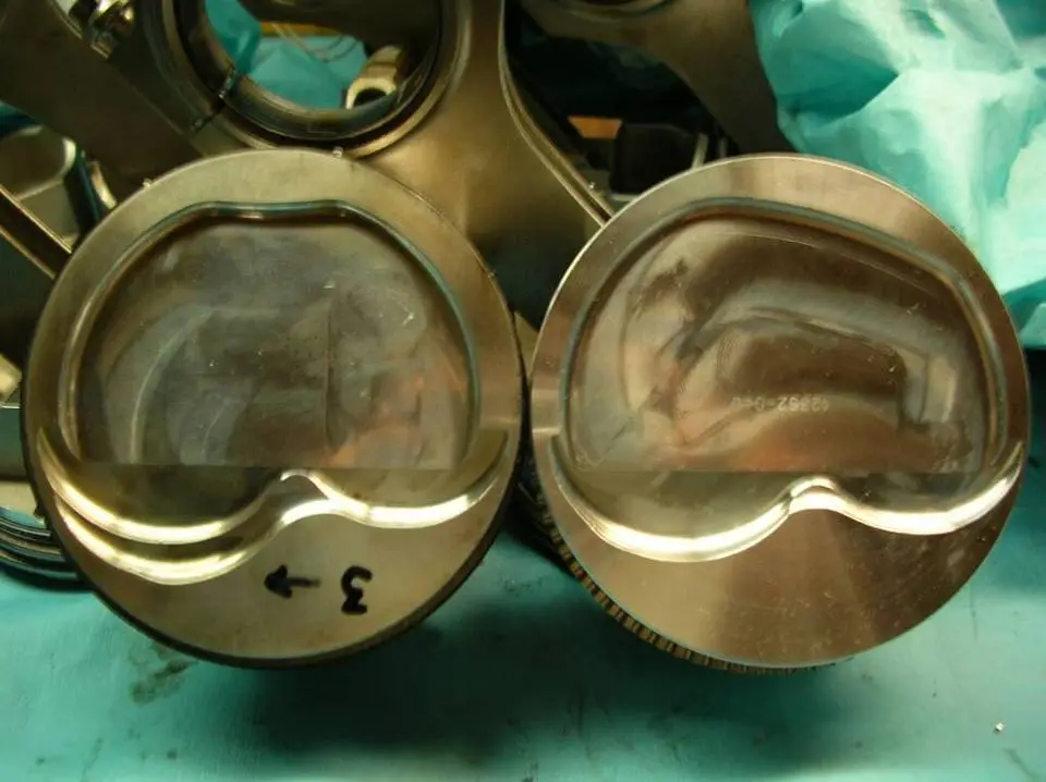

The pistons were on backorder from Probe. My builder finally got them. Probe changed the valve relief design a bit. The original pistons were a made at least 6 years ago. It should not be an issue, but I'll definitely need to check valve clearance. New piston on right.
He is going to confirm the piston weights and then put everything together. It may be ready to pick up this weekend.
