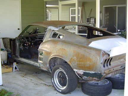

Im Going To Put Subframe Connectors On It Anyway
So It Should Be O.k.
The Car Was A 6 Cyl. That Was
Owned By A Surfer Kid. The 6 Was
Yanked Out And A Friend Cut The
Front End Off (firewall Included)
And Welded A New One On From A
Parts Car. Lots Of Rust Up Front..
So I Still Have A Long Way To Go
On The Car But Ill Post Some Pics.
Thanks Again For The Help , This Site Is Great
Pics.
