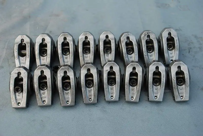

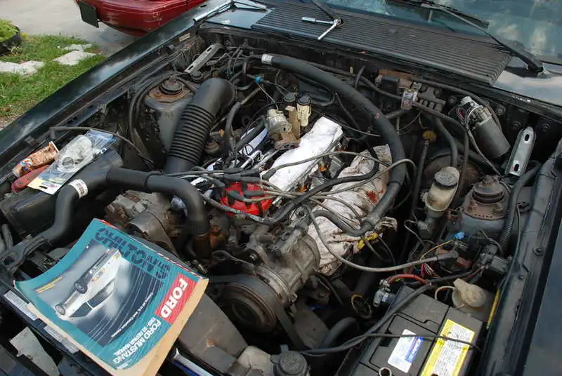

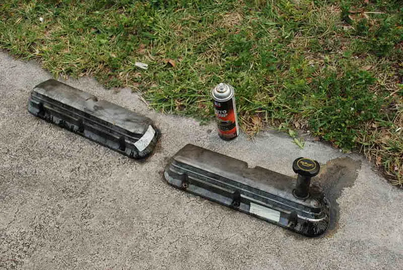

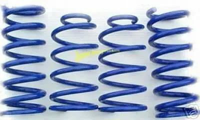

Well, here are a few pics of what I've been doing to the Admiral. I got my 1.7 Cobra RR. Im cleaning up my nasty valve covers and finishing up my intake. I haven't had much time for my baby cause of school, errands etc. But now im going to get new hoses (mines are cracking). Oh! I put on some ponies and i got 2" lowering springs (progressive) and subframe connectors. Should be coming in some time in the next 2 or 3 weeks. i wanted specific rate springs, like my lx has. i got 600lbs in the back and 660 in the front and its a 4 cyl. lol Stiff like a mother :nice:
Cobra RR (sorry for the missing stud)

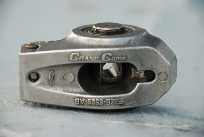

Close up
Dirty Valve Covers
Engine and my Chiltons book
Springs

Its looks as though you are using some used parts...which is fine. Be sure to check those rocker arms thouroghly for cracks in the arm. I bought a set of used pedistal mount rockers last year only to find 3 of the saddles had cracks in them, I was able to get a new set of saddles for $15 but i am glad I caught it befor they were installed, broke and rattling around inside the valve cover.

Yeah ive checked and so has my brother. I just need 2 pedestals and a stud

ok, so today i finished putting everything on. i put the dist. how ihad it before and when i go to crank it up......NOTHING!! :mad::mad::mad::mad:
I got so f---ing pissed. i checked for spark, had nice spark. Checked all the vacuum lines, all connected. checked the the fuel, getting gas fine. fuel pump working. tried priming it, no start. when cranking, muffler makes noise. sounds kinda like backfiring, but it might be cuz of the 1.7's giving more lift. not too sure. all cables plugged in. Starter works perfect. I have no clue what it could be. Anyone have ideas??? I was ready to take some video and pics, but nope, nothing. what a way to get disappointed. what do u guys think could have gone wrong? the only diff. from before the intake came off and now is the FPR, 65mm TB, MSD coil, 1.7 RR. Maybe the AIC is bad? TPS perhaps? i have no clue. PLEASE HELP!! i need to get the car running asao. my tranny rebuild kit came in today.
