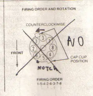

MikeROD16 said:
nope, i havent messed with wires. ill recheck just in case. why is there a problem in the chilton book??
Yes, they give you the wrong firing order... I would know.

WTF!?!?! what the real firing order then? and why would they do that??

i just looked it u on several websites, all say the same. including my chiltons

Well they have the firing order printed throughout different places in the book, and in mine they had H.O. firing order on some pages and non-H.O on other pages.
Edit: it was this diagram, WTF?

lmao wtf? mine looks diff than that. the firing order isnt like that.
