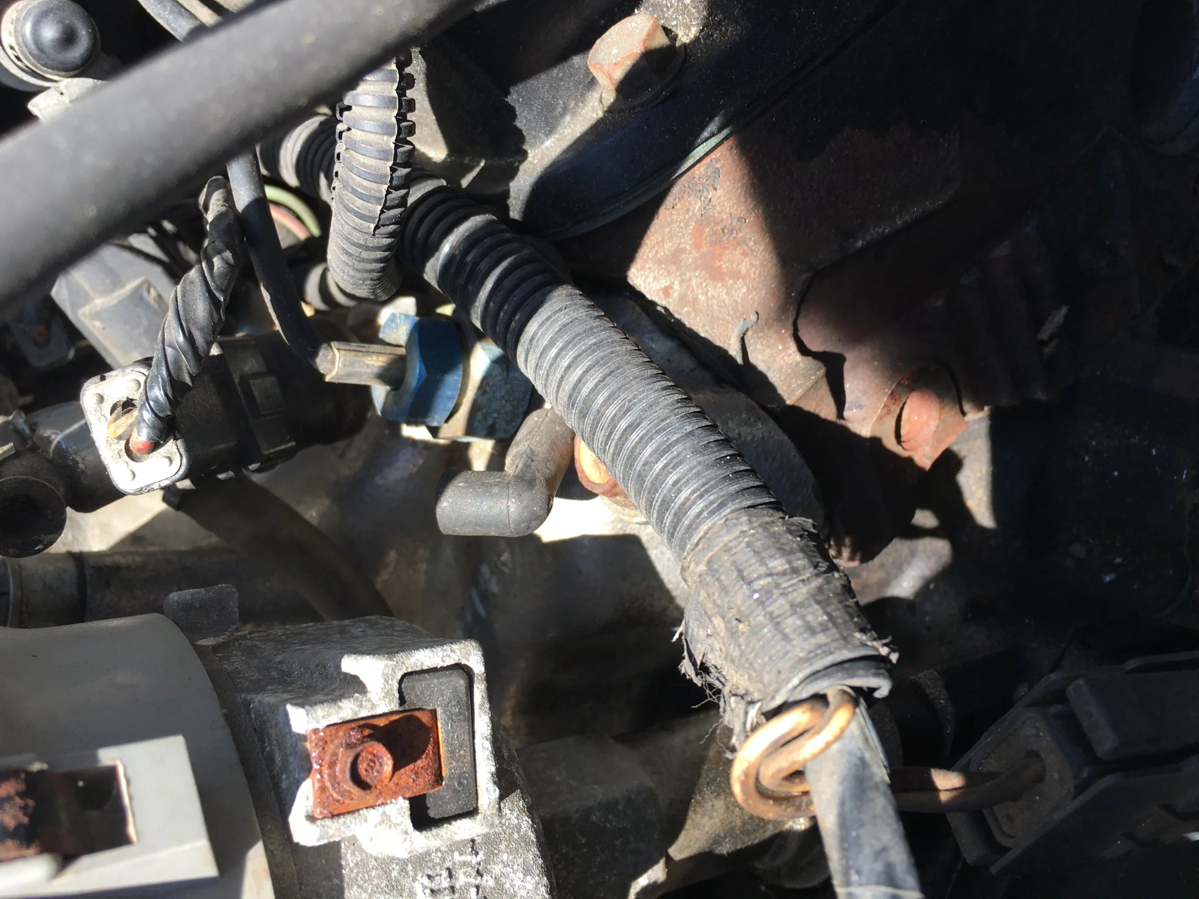

in got the car like this. It was unplugged on the manifold, and the gauge is connected to it.
This is what it looks like

No problem. I'm out of town but the engine coolant sensor I believe is on the other side.
