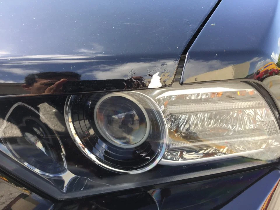

Good Morning to all,
Just wondering if anyone has had to take their car in for any defective paint issues. I have a 2013 GT that has some bubbling and peeling paint on the hood. According to their warranty online, paint is covered for 5 years for perforation due to corrosion. I have had the bubbling for a while now and recently the paint has started to peel. I am planning on taking the car to the dealer next week to see what they say. If anyone has had any similar issues, I would love to hear about your experience(s) and or any advice, Thanks!

What does it look like on the underside??

That is typical on all S197s. Luckily, Ford changed and went from steel to aluminum on the S197-2 (2010-2014) hood. Your hood is aluminum and I have heard Ford won't cover the rust Warranty on the paint because it doesn't actually cause "rust"... it causes "calcification". I had my hood individually re-painted for $300 because of this. I then noticed it started a little bit under the hood at the seal... looks like a poor sealing issue. I sanded it down and touched it up with black and clear paint and it stopped it.

If you're still under the 3/36 they should approve it after dealer sends them pictures of the bubbling paint. After that no dice, BlackBuggy is correct because it's aluminum it doesn't actually perforate.

I know that this is an older thread, but I'll add to it. The bubbling of paint on the front edge and even the sides of the hood was a problem that was fixed under a TSB. Something about water migrating into the hood under the seam causing the paint to bubble. It can get bad enough to affect the whole hood. I just got my '11 back from the second repaint, as it started bubbling again. If you are still under warranty, I believe that you can still get it done. Either way, you should have gotten a letter from Ford instructing you to bring the car in for inspection. It is the only way I knew about the problem.

The paint is covered under the 3/36 bumper to bumper warranty that came with the car.If your car is still under that warranty then you should have no issues getting it repaired. If your warranty is expired I would contact Ford Customer Service and ask for assistance with the repair, being that it is a known defect. If I recall correctly there was at least 1 person on this board that got some assistance from Ford and didn't have to pay the entire cost. If you end up having to pay for the repair yourself I would pull up the TSB and have the body shop follows the repair procedure to reduce the chances of it reoccurring.
