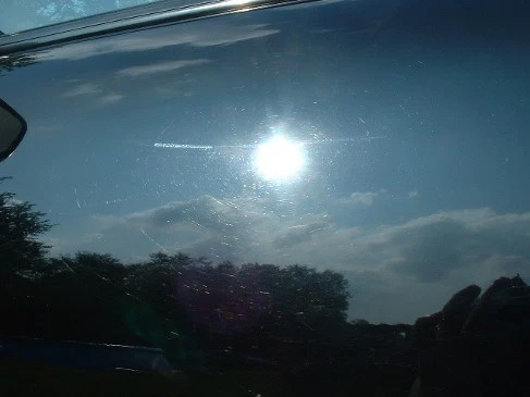

My car's paint/clearcoat need some work. In the pictures on my cardomain site in my sig, you can see that the passenger's side of my car isn't very shiny. It was probably parked in such a way that the sun hit that side of the car for extended periods of time. I would greatly appreciate it if those of you who have tried different wash/wax products would recommend something that would make the car shiny again. I know virtually nothing about washing/waxing cars; my first car wasn't even worth washing lol. Thanks in advance!

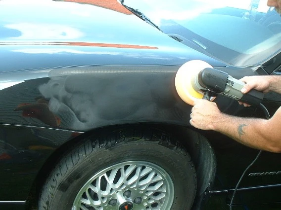

A great place to do research is www.autopia.org There is more info there than you'll ever know what to do with. I don't know how serious/how much you wanna spend on detailing products, so take this for what it's worth. The best investment you can make for your cars appearance is a Porter Cable random orbit buffer (got mine at lowes, but you can get em online as well www.properautocare.com). It makes any polish/wax job much easier/faster, and you'll be able to get rid of more imperfections and make is shine better than you could ever do by hand. I just started to get really into detailing last fall, so I haven't gotten a chance yet to use a ton of different products. I picked up some Menzerna Intensive polish and Menzerna Final polish II and it made my ten year old paint look incredible. I just ordered some Klasse AIO. Haven't gotten a chance to use it, but a lot of people really like it. It's a good all in one (hence the name) polish/wax. If you're lookin for somethin over the counter, Meguiar's NXT wax has been working well for a lot of people. I also have seen the work that a friend of mine did with 3M products and it looked amazing. I could go on and on, but your best bet is to go to autopia and just started readin through the forums. Good Luck
