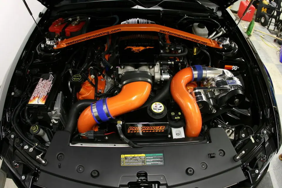

Best way ever is the following, take it for what it's worth, it's tried and true..
Products needed: Simple Green, Turtle Wax F-21 tire dressing, several rags.
Here's a link to F21 so you know what it looks like:
http://www.turtlewax.com/main.taf?p=2,1,3,5
Here's the simple green for those that have never used it:
http://www.simplegreen.com/products_all_purpose_cleaner.php
Start engine, get it warm, not hot, just nice and warm. As an example if the car was fully cooled, run it for 5-8 minutes. Turn off engine.
Cover the alternator and air filter on your intake, Aluminum foil works great since the motor is warm. Everything else can be subject to light rinsing type spray, including the covered fuse panel. All of these areas get hit by water when driven in the rain.
Lightly spray entire engine bay with water from hose, you will see some light steaming, this is good.
Spray the entire engine bay, including firewall, plastic parts, metal parts, loom, coils and hoses with Simple Green. Set the hood down, not fully closed, just to it's safety catch point, and go find something else to do for 15 to 20 minutes. Let the simple green do it's work. Closing the hood let's the simple green interact with the steam you created with the warm motor. This loosens the tough stuff up so you don't have to work so hard in those heavily soiled areas.
Open hood, look for heavily soiled areas, wipe them with a rag, use more simple green if necessary. Rinse lightly with hose.
Spray entire engine bay with F-21, it foams, coat everything just like the simple green coating you did.
Close hood again, walk away for 10-20 minutes or until nearly all the foam has dissipated.
Open hood, Wipe up any areas that water settled and such. Wipe up any areas that the F-21 didn't dissipate on it's own.
You will note that the F-21 restores the black plastic parts to the same oem flat black color they were when new.. It leaves the paint shiney with no streaks on the fenders and fire wall. Best of all, it is not greasey to the touch.
Hope it helps, I do it twice a year to my DD, and once a year to Eleanor.

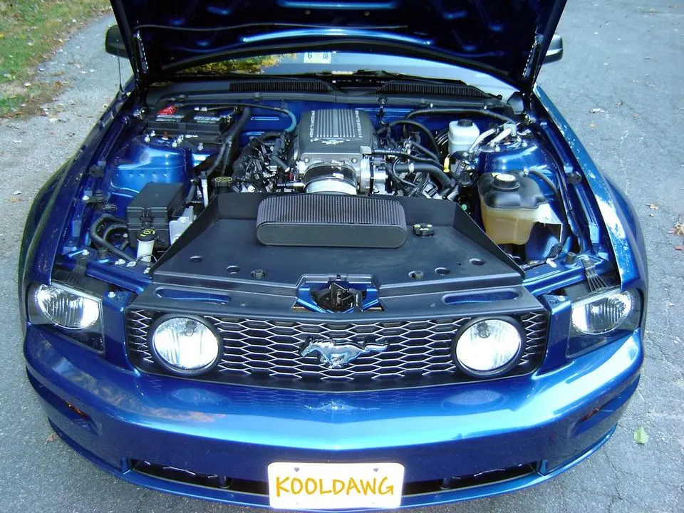

I've used the diluted cleaners a few times(never on the '06 yet), but mostly just the same car wash soap as the paint gets(seperate buckets of course )and rinse it off with a light spray from the hose or just take the nozzle off and let it moderately run over the engine. +1 on covering at least the air filter element. I then go over most of the plastic and rubber with Armor All Original and rags.
This is the most recent pic I have of under the hood(a few months ago). It's not as clean as it could be as there is some dust sitting here and there, but it did have around 35-37K miles on it and it gets driven in the rain, snow, whatever
