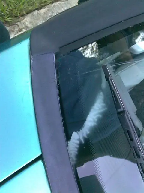

I've got the same thing. First started as a small white spot in the lower drivers side corner. A couple drops of water would appear on the inside corner of the dash after a heavy rain. FF a few years, That spot looks worse.. and now I have a very similar looking spot on the lower pass side that has become quite large. I don't know what the hell it is. It's inside the glass itself, not on the inside of the windshield, but between both sides and you can't touch it. Have a look.
Yours is the glass starting to delaminate. Time for a new windshield.
