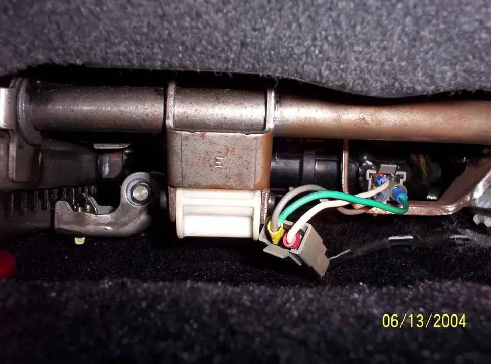

Why do I have two connectors under the drivers seat? I know one is for the power lumbar but WTF is the other one for? It looks identical to the wire that goes to the drivers side seat belt buckle.

Guess again ladies. In that picture, the seatbelt is still plugged in. The connector look EXACTLY the same as the seatbelt connector...but apparently I have two of them.

I have been reading about the seat swap and I understand that I need two power runs from the car for the seat....but this seat has 4 wires. 2 Green (hot I assume), black (ground), and a small grey/blue wire. I have no clue what that one does. Fortunately, when the seats were removed, they cut the stock SN95 plug out of the car....so I have the whole plug and about 10" of wire to work with.

There the power seat plugs for the GT cars. Thesmall gray/blue wire is the lumbar. I did the same swop on my LX.
Okay, so the power lumbar in the stock setup has two wires. I know that. So if I splice in the two hot runs from the new seat plug to the hot from the stock harness and then I have the ground. However, I'll end up with this 4th wire for the new seat that is not plugged into anything. My schedule has been hectic the past week w/ thxgiving so I'm hoping Monday or Tuesday to make it to the junk yard & cut out the other wires that I need. This needs to be fixed soon.
