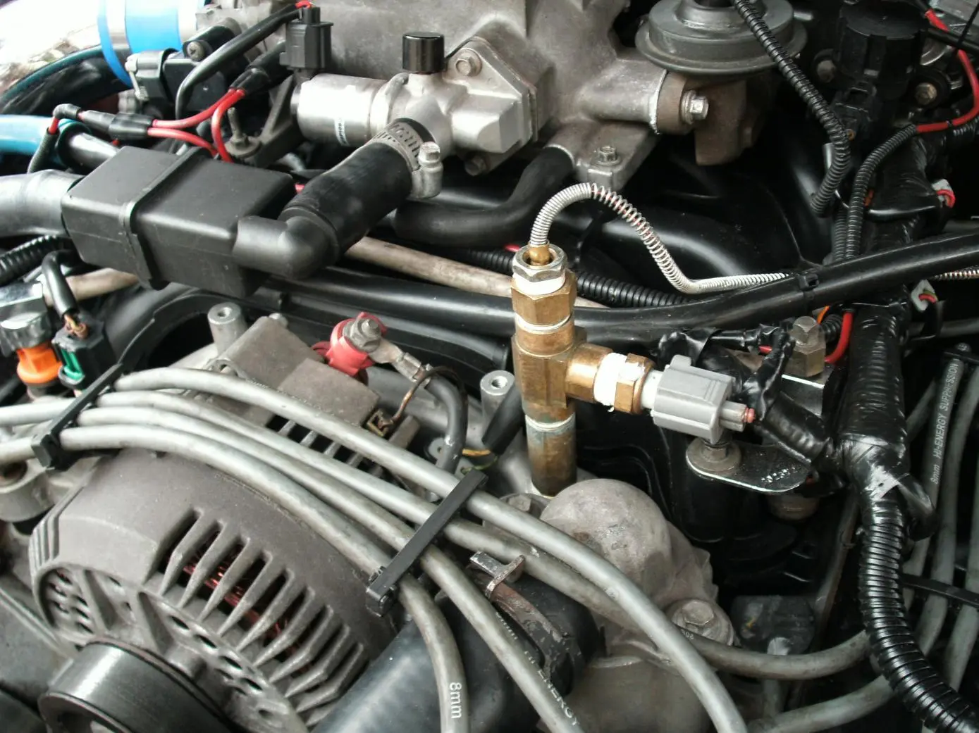

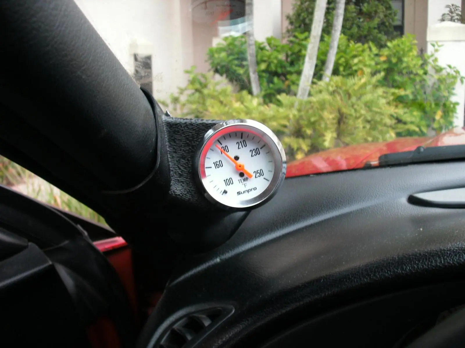

I live in Florida so altitude is not an issue. I have never seen the fan run with the a/c off, and I really don't trust the aftermarket mech temp gauge. It just doesn't seem to be very consistent. When it reads 180f I think it is warmer than that. As far as the stock gauge, someone installed white face gauges. and I don't think they inserted the needle to the temp gauge correctly afterwards. Also, it has a 170 thermostat in it, if that helps with information. I'm trying to insert some pics of the setup that is under the hood for the aftermarket gauge, so let me know if it looks like it was done right to you guys. Thanks for any help.

Oh, and as matters of safety... I would cover up that positive terminal on the alt. with something and you are missing the upper bracket that holds the alt. to the coolant cross over tube. I've heard of the lower bolts breaking off if you dont have the upper bracket.
I see a couple of issues here. The height of the tee is so great, there is a real possibility of air being trapped in the tee. This will cause the sensor to read the temperature of the AIR and not the COOLANT. Some method will be needed to ensure the sensor is actually touching the coolant or the PCM will never get a true read.
This may explain why it is coolant is venting at 180 degrees as the actual temperature is much higher. Consider under normal conditions, 180 is not high enough for the PCM to even call for the fan to run.
This also points out how all of this stuff has to work together. If a lower temperature t-stat is used but the PCM is not re-programmed, then the car will never reach the correct operating temperature. This has the t-stat opening too soon and the fan never runs. The results will be wild temperature swings depending upon outside temperatures and how the car is operated (AC on/off, how fast ect).

On first impression, my vote is the primary problem is air in the tee resulting in a chronically low sensor reading. The PCM never calls for the fan to run and a slow overheat is the result.
Consider using the drain taps on the side of the block for the mechanical temperature guage. Restore the PCM temperture sensor to its original location. This will have the tip of the sensor in the coolant stream thus ensuring an accurate reading.

Look on the side of the block under the freeze plugs. You should see a threaded hole with a plug. This is the coolant drain plug. This can be used as an alternate sensor location. Note, the temperature readings will be somewhat lower than the intake manifold cross over. However, any sensor installed will be in direct contact with the coolant and provide a reasonable reading.
