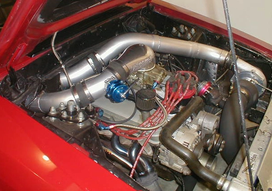

Not my car and I hope this cat don't mind me linking to it....but it would end up looking somethig like this.

I just went through this. You'll need a stadard rotation pump from a 79-85 and an ASP 6 groove water pump pulley. The belt length depends on the pulleys you run. Check my site on the photo page for a pic.
I put a pic in "my garage".
