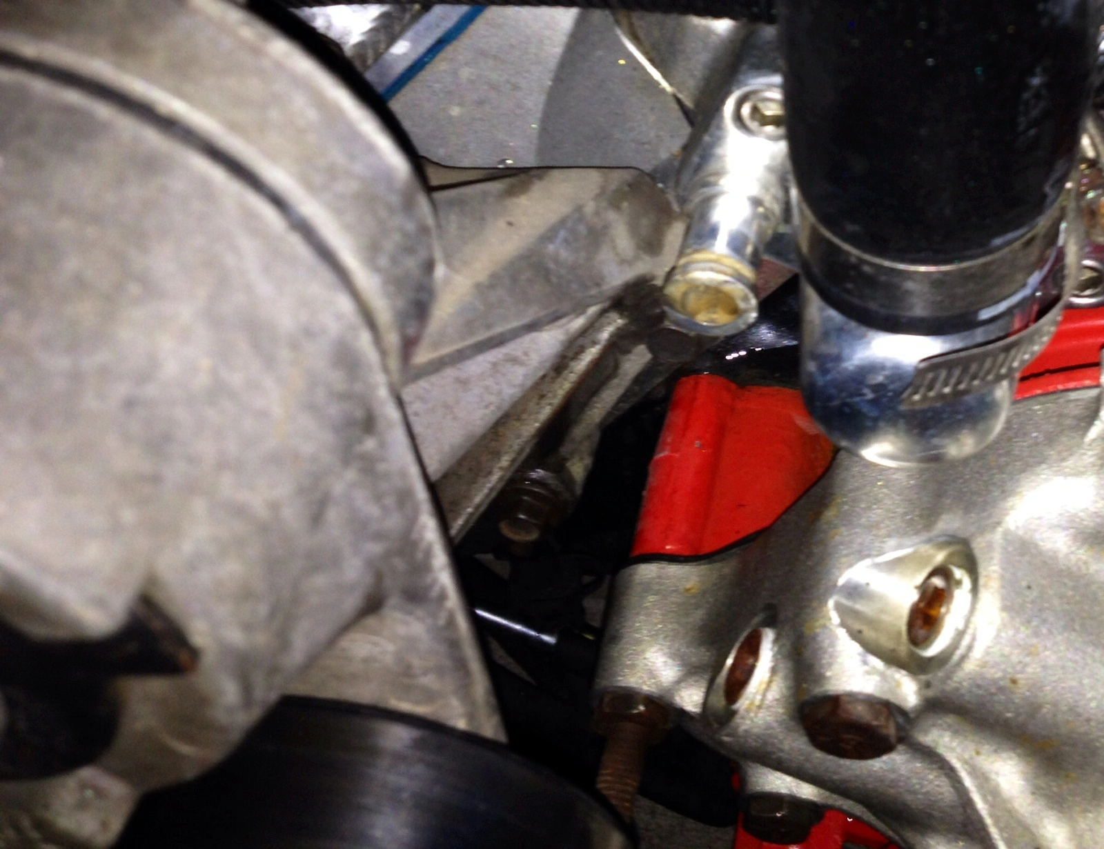

I got a 347 stroker with eldebrock water pump in the 2nd picture that has holes plugged in thermostat housing and plugged in the water pump.

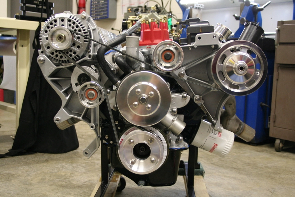

Then the first picture I have found on Internet that this 347 stroker has a hose running from water pump to thermostat housing to water pump. Which is correct? And why would mine be plugged?

The picture you have here shows to hoses coming out of your water pump, the one on the right going into the thermostat housing and where does the second one go? Mine has to hex headed plugs with teflon tape on them and plugged off on the water pump. I'm confused why it was done this way. Can anyone tell me why they would plug the holes off and plug the thermostat housing off also? I'm just trying to get everything fixed correctly or can I run it with the holes plugged off? Thanks in advance
The hose leading to the thermostat housing is a bypass to the thermostat. The other hose leads to the heater core via a black steel tube that runs the length of the intake manifold. I have seen people block them off to eliminate the heat in the car. I personally would like to see the bypass installed back at the very least. Whether you reinstall the heat or not is up to you.

Ok. My car does not have heat, nor does it have a thermostat in it so I assume that is why it is plugged off wouldn't you think?
Yes. You should have a thermostat and at least one of the hoses. If you don't have the heater hose, then you should have the bypass hose. Ask for a bypass hose for your car at the parts store. They are a few dollars.

Throw a stock 192 FORD thermostat in it. If you use an autoparts store one test it first by putting it in boiling water to make sure it opens and at the proper temperature. Get a Felpro thermostat gasket with the sticky on both sides. Use blue RTV as well on both sides of the gasket. There is a right and wrong side to install the thermostat. Pointy end to the radiator, spring side to the engine, small bleed hole on top. Make sure it is seated in the little ring in the thermostat housing, if not when you tighten it down you will crack the housing, Check the housing for signs of pitting or rust. Make sure the mating surfaces are clean and straight on both the housing and intake side. Torque down the two bolts and do not overtighten- I use blue loctite so they don't back out. The little bypass hose is a PITA to put on. Use some WD40 or silicone on the end to slip it on.
