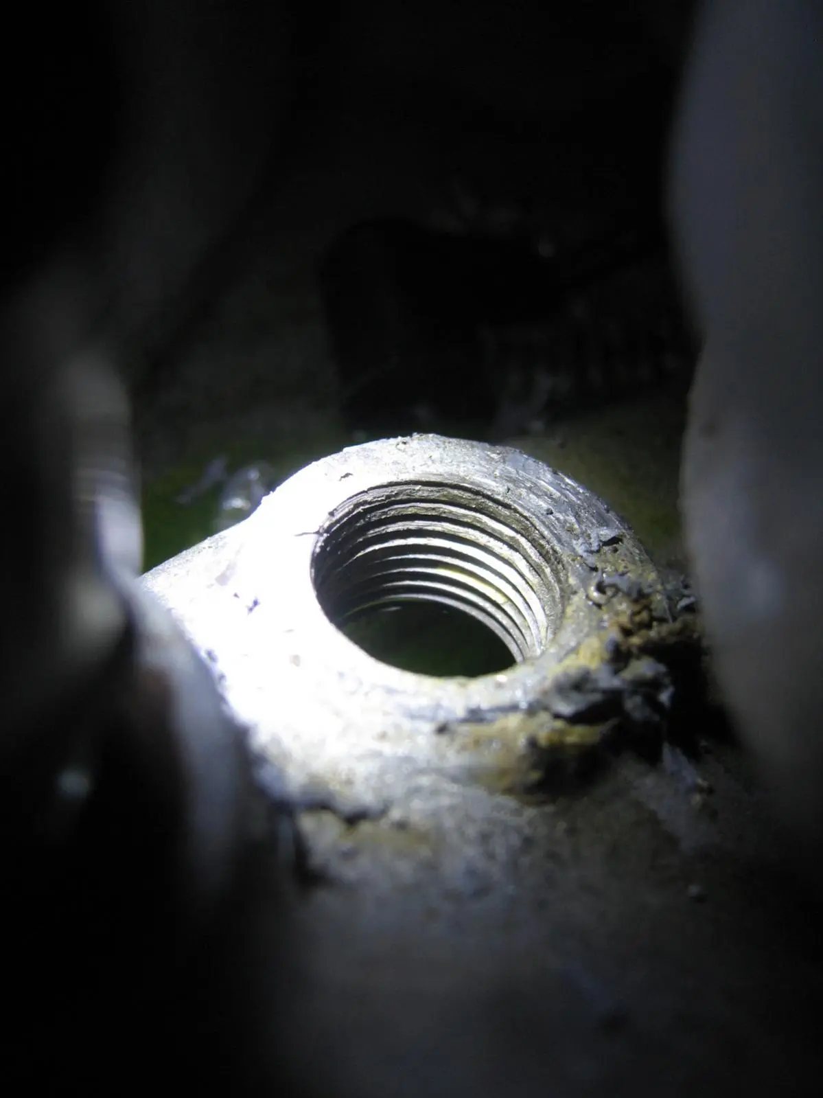

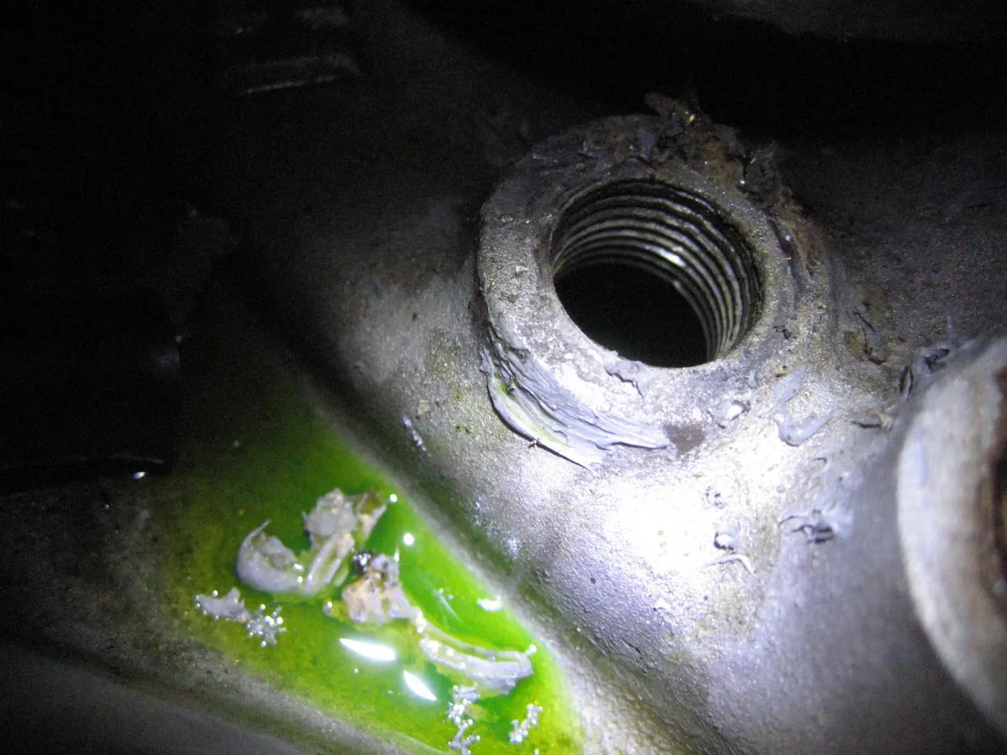

Here's the issue, the Stang is my daily driver for one more week and the shop is about an hour and a half away (it's normally at my parents house closer to the shop but I grabbed it for a couple weeks for fun). After looking at it, the threads don't look completely destroyed, but here's some pics for your viewing pleasure.

Those threads don't look bad at all. Ford used an adaptor on the later EFI intake manifolds to get the coolant sensor in there so there is no reason you should be affraid of an adaptor.
The threads look just fine down lower. Run a cleanup tap on the threads to fix the munched ones and use some teflon tape when you put it all together.
Just remember that the unthreaded/sensing probe end needs to be in the path of the water flow for it to work right. Adapters seem to cover the end that needs to be in the water. I did use an adapter but I modified it to allow the sender to protrude into the water flow.:nice:
If you do end up running a tap through the manifold, you may want to consider puting in a Ganno radiator filter. It wouldn't be a bad idea either way actually.
I can't readily tell from the pictures, but if that's an aluminum intake you could try cranking a steel pipe plug in/ out several times if you're reluctant to use a tap. May just smush 'em back in shape well enough to seal up. Agreed - threads up top look more mangled than the lower stuff. Just make sure the plug (or tap) bites in square when you get it started.

Thanks for the help guys, I ended up using some Permatex liquid gasket on the threads and put it back in. No leaks over the last couple of days so I think I'm in the clear. My goal is to totally redo the engine, so it's more of a quick fix to last in the time being.
