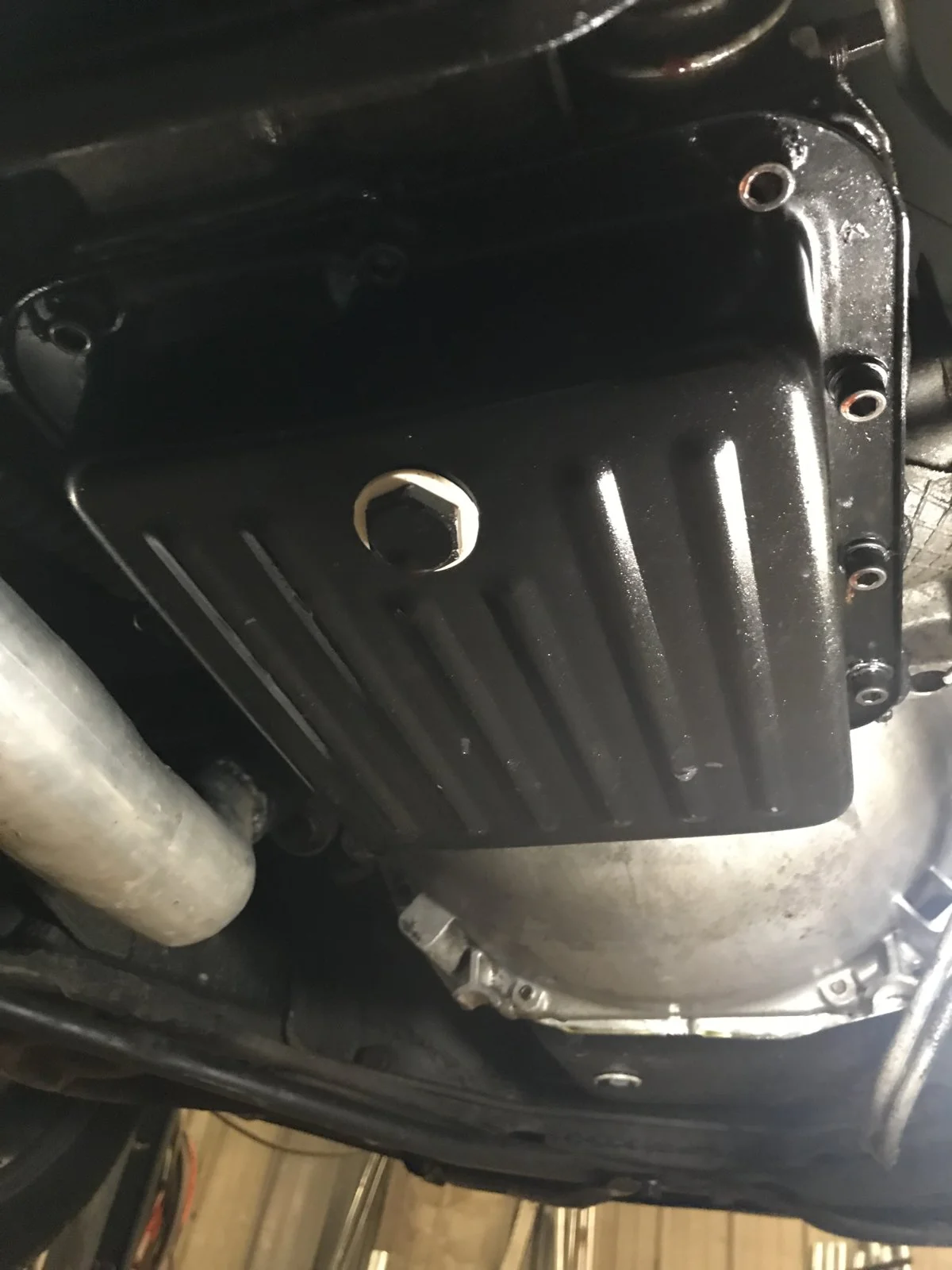

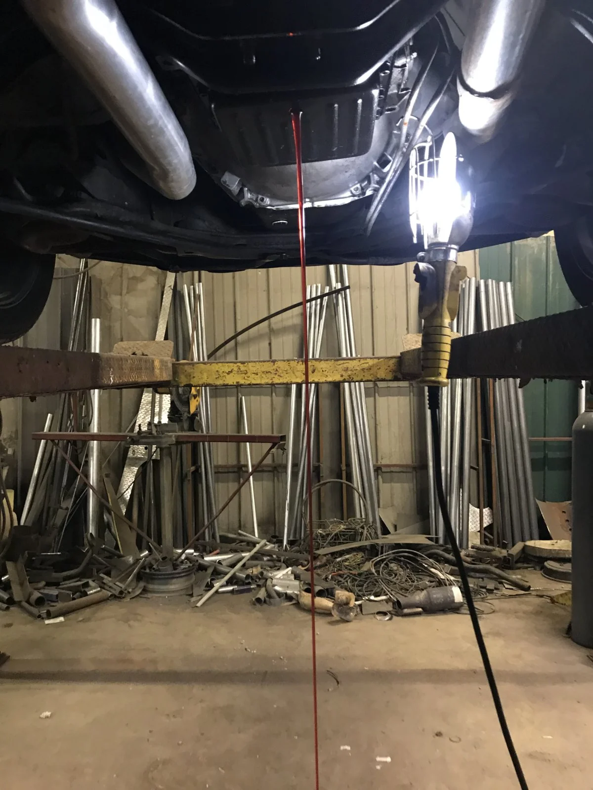

Started leaking again.
Don’t understand it.

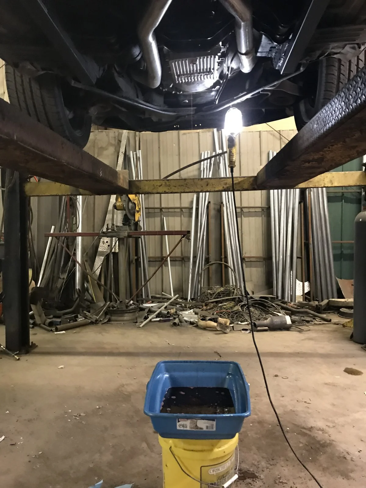

Spent this afternoon until late tonight working on it.

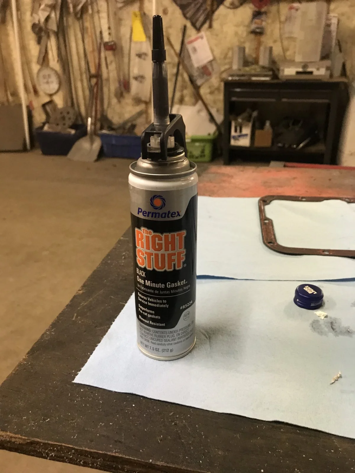

1st tried “Right Stuff “ thought it was gonna work.
Couple of hours later started dripping.
Went full blown psycho for awhile, then decided to drink several adult beverages, and think about it.
This was about my 5th - 6th hell I don’t know times of pulling pans.

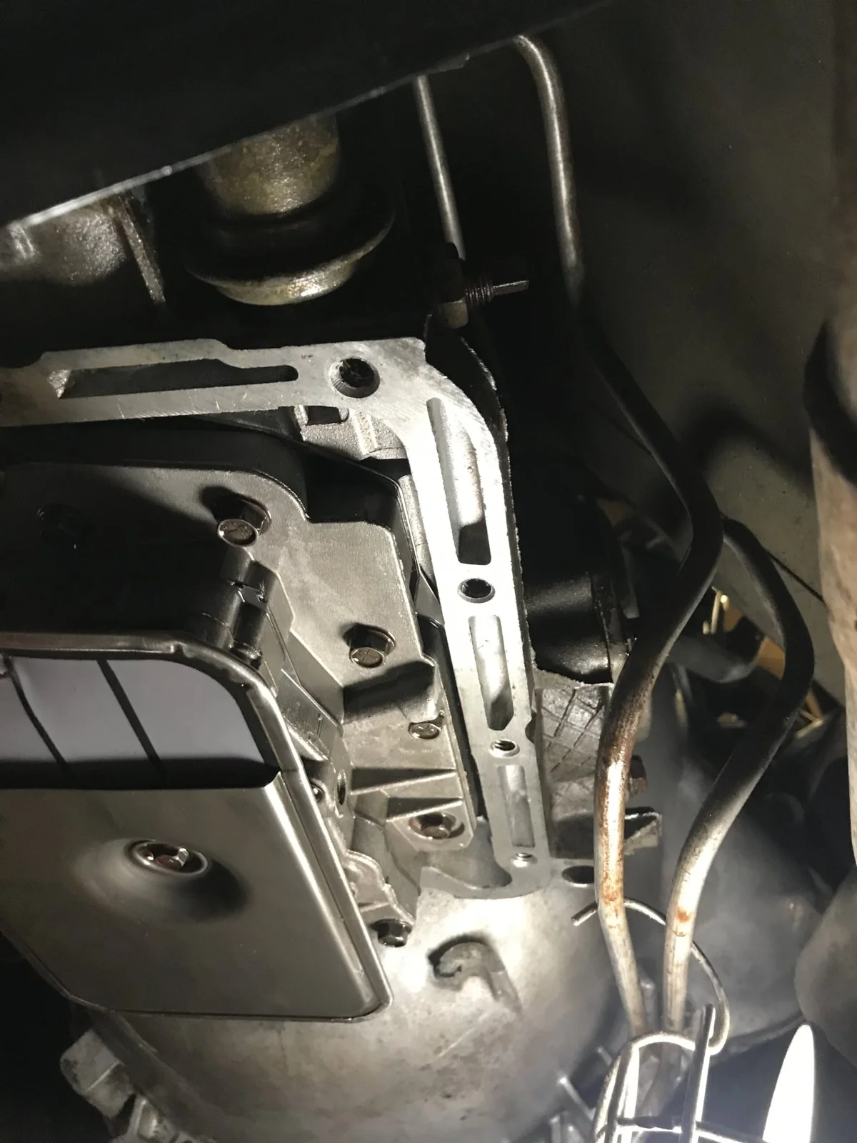

Jerked the pan, and gasket off, and studied them for awhile.
Gasket still looks great.

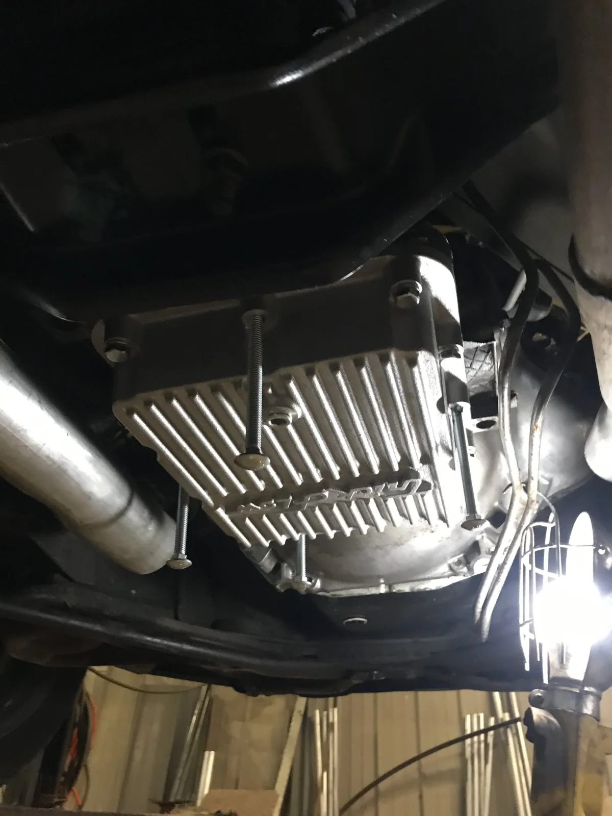

Looked around the shop and found a couple tubes of “ Mega Black “ gasket maker.
Used this once before on another pan I bought.
Decided what the hell—smeared the
all over the pan—placed the gasket on top of that—put some old bolts into the holes, and let it set for awhile.
Then smeared the
all over the top of the gasket and bolted it up hand tight.
Followed the instructions 100%.
Bolt it up hand tight until the stuff starts squeezing out of the sides, wait an hour then tighten.
Now it is sitting for The recommended 24 hours before adding fluid.
My beautiful Daughter picked me up and brought me home.
Tomorrow while it is still curing I’ll change the power steering pump, then wait until about 11pm to fill the transmission.
If this doesn’t work— I’m just gonna live with it.
