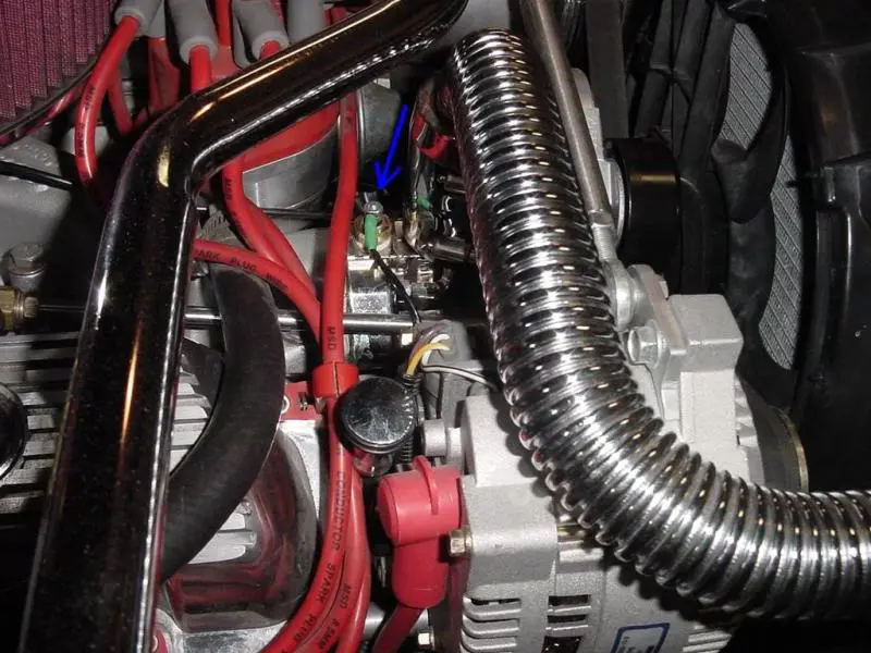

you can also get a thermostat housing with a threaded opening after the thermostat where you can install the fan switch.
+1
This is what I am using and am running electric fan etc. Here is a pic:
