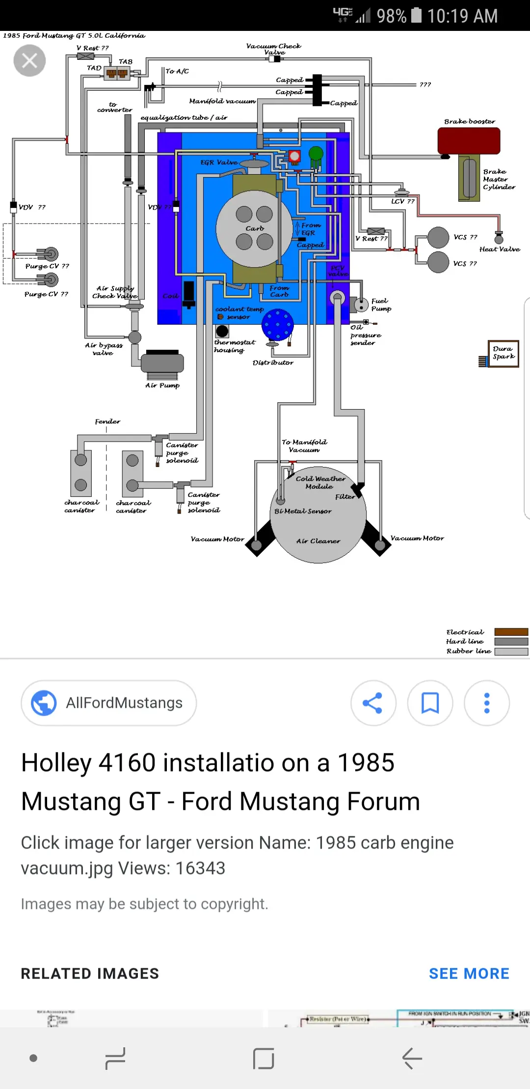

okay, vacuum leak... I installed the carb myself and since an edelbrock is a different design than the factory holley, to be completely honest I wasn't 100 percent sure I hooked all of the vacuum lines up correctly. Not to mention I noticed vacuum lines sitting completely open even before my installation, so trying to trace to vacuum lines and see what the previous owner messed around with is very challenging. And if I find open vacuum lines, I'm unsure if I should plug them up or hook them to something..

Dang.... it's alot of vacuum lines on that car....jeeeesh !
The vacuum lines and changing the fuel regulator are a good start. Good Luck... any issues dont hesitate to post. I'm not the smartest guy here.... but, eventually, one of the geniuses will chime in.
