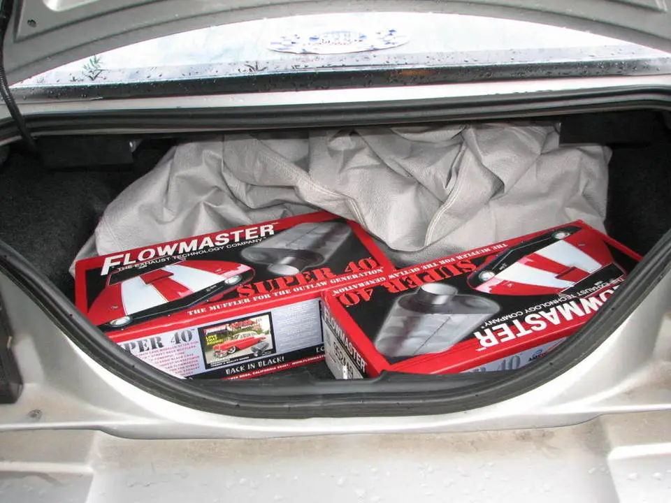

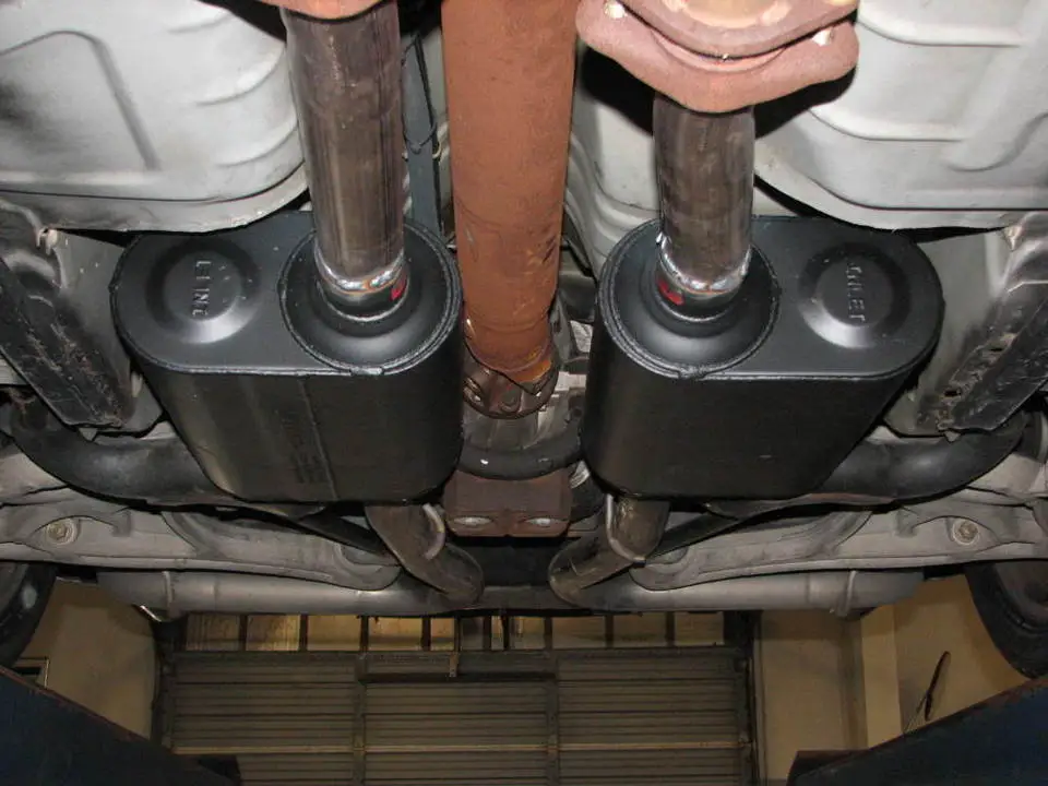

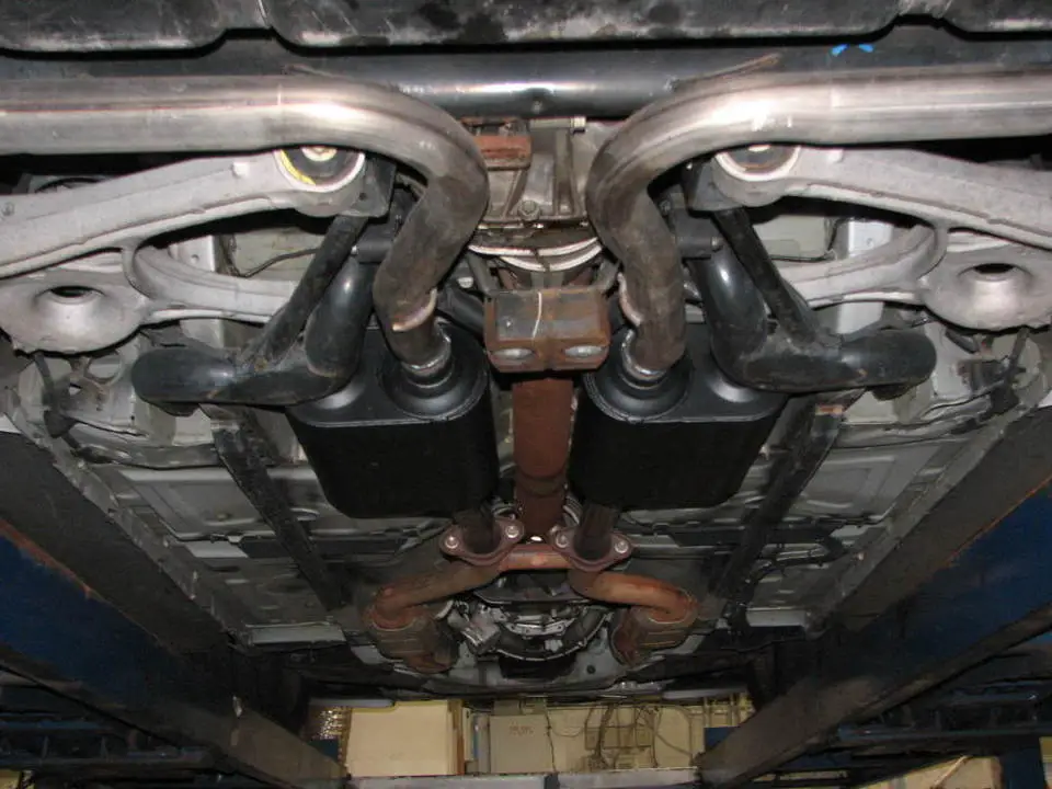

Ordered Super 40s in the 2.25 size from Jegs, 2-3 days delivery.
They're slightly longer than the stock mufflers and the installation was done in 30 minutes or so. The guy who did the work said it was one of the easiest he had done.
The sound is nice, but fairly quiet, you can see I'm using the stock H with cats: good rumble up to the drone zone at 1800, then a nice snarl starts around 3000, something the stock mufflers did not have. At 4500+ they don't seem that much louder than the stock mufflers. Trying again tomorrow for a recording, the first tape deck was not working today.
I didn't expect much but there does seem to be a small pickup in horsepower under 2400, useful for a daily driver.
