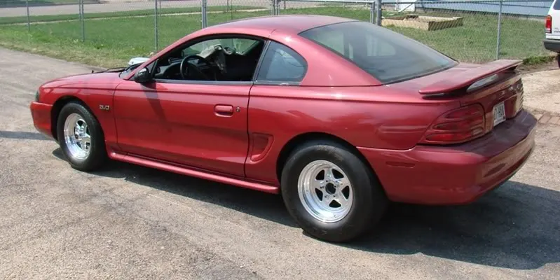

I have 15x10 with 295 50's....they rub when turning in a driveway at and angle but all I did was remove quad shocks...i'll try and find pics later..but i agree with the above post you don't want a 28" tall tire if you don't need it then you'll lose atlittle gear.
I have the 15X10 Prostars on my car with 28x12.50x15 ET Streets.
I had to do a little pounding with a hammer on the edge of he inner fenderwell to get enough clearance to be comfortable. Plus I don't have any quad shocks on the car.
