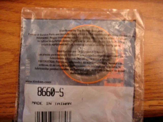

Does this look the the correct seal to you?
It was listed under "wheel seal" in the autozone computer.
Timkin 8660-S

Yeah that looks right! You might as well replace the bearing at the same time, and it might have been the cause for the seal to fail anyway.

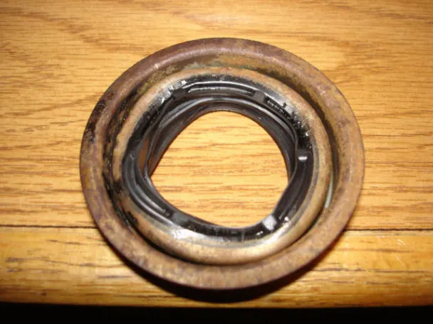

I just used the end of the axle to lever it out. I couldn't get between the bearing and seal with the slide hammer i had, so i just levered it out with the axle. It was easy as hell, took about 3 tries and 10 seconds. Mangled the old seal up a bit though.

I'm guessing it's been like this for a while. At my last autoX i drove the car hot and smoked the brakes. I guess the sticking caliper may have heated that brake up even more and it compromised the seal as judging by the amount that oozed out, the timeframe seems to fit as to when it started (and the last time i cleaned my wheels).
So that makes me feel better than i have a reason to why it failed other than a bad bearing. I checked for play and there was none in the axle.
