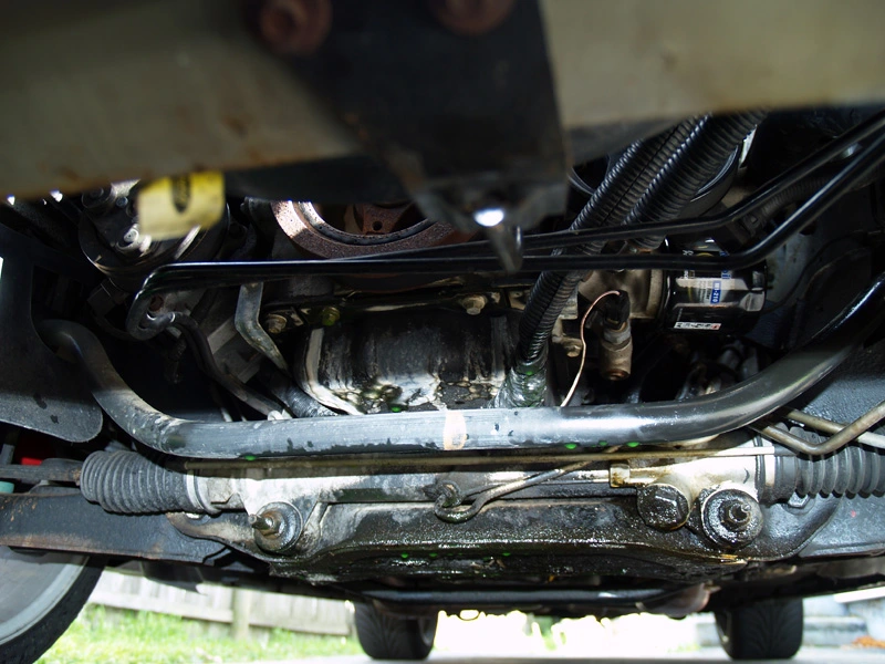

So I was at the store today, I parked my car go do some shopping, and come back. LOW AND BEHOLD there is coolant fluid all over the area I parked my car in. I do a cursory examination under my car and I see no broken or ripped hoses.
I drive to a Oil/Lube place down the street, leaking fluid :( and I ask the guy there to just change my oil and help me locate the leak. he changes the oil and tells me the fluid is coming out somewhere in the bottom of the water pump or gasket. He tells me i need to replace it.
when I get the car home I look at it, and take these pictures. So what exactly is it I need to replace? is this a 10 minute fix, or is it gonna be really involved?

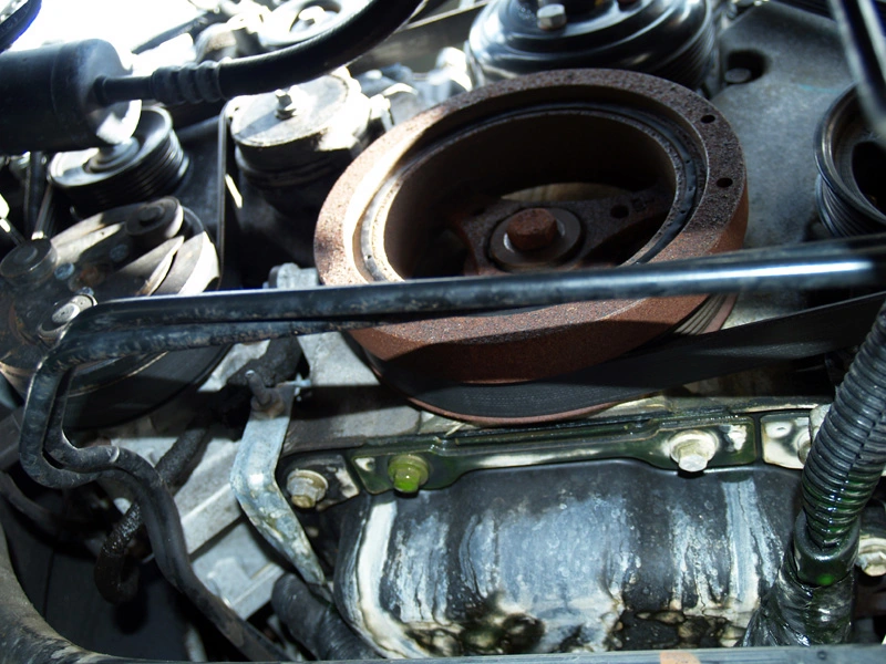

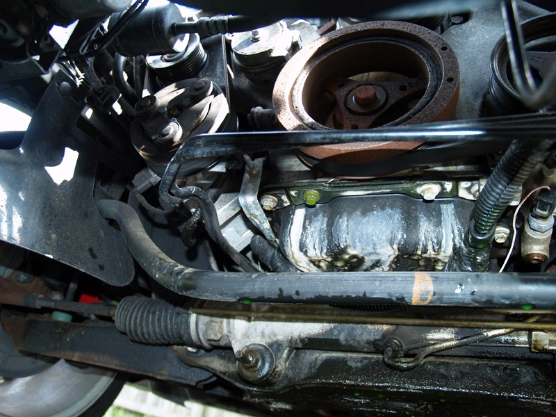

actually looking behing the water pully, i see no coolant. it actually appears to be coming from beneath the crank between a gasket somewhere. see the pictures, i added them to the original post
The water pump doesnt take much time to do, Just remove your serpentine belt, undo you battery first if you want. Then remove the alternator. Undo the 4 or so bolts and pull back on the pump, and the ring will be on the back of the pump. its a 3 dollar o ring from a discount store, autozone or oriellys. or 30 from ford.
ok, so based on the photo graphic evidence..... can we assume the water pump is at fault? I see no green colored coolant anywhere else on the car. even looking under the intake manifold, to see if there are cracks and puddles which there are not. and all the hoses in and around the radiator perfectly dry.
