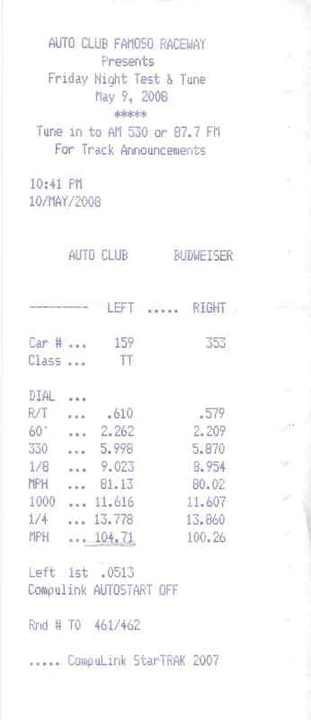

Visited the local track last weekend on friday night grudge. Did a lot better than the first time out (best was a 14.5).
Managed to cut a 13.7 which I was pretty excited about. Still a bit of wheel hop but the new BFGs really grabbed compared to the pirellis I had on there before. Check out the time slips!
My 13.7 was up against a honda hatch. The guy said it was fully built running 13:1 compression, 110 octane, straight through exhaust, no interior, and drag radials up front. No turbo, no nitrous. I told him I still had my seats in the car. lol
My car is #159

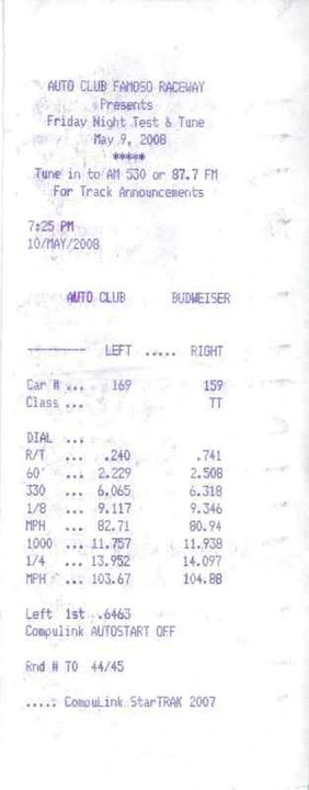

First run of the night I ran against a brand new charger SRT8, he beat me but check out my MPH compared to his... wierd. I was talking to the guy most of the night, nice car but thought those things were a lot faster.
Good improvement! Tire spin off the start usually adds MPH at the traps.
I see the Honda left on you, but it didn't take you much past half track to catch and pass him for the win:nice:
The SRT8s are nice/powerful, but lead sleds. They are much better suited for highway speeds than dead stop launches(at least in stock form).
Your R/T's are Horrible!
Practice on getting the pedal to the floor half a second quicker.
Thats a whole half a second Off your final slip! Which is killer in any car.
Its looks good though. Your running fairly well.
Doesn't look like your loosing any time through the gears.
+1, Just keep up the quick draw

While the R/T is bad, he's just trying to get some better times right now... and the R/T has nothing to do with ET. So your RT could use some improvement (wherever you're starting right now, start at the light before), the short times are the real area of opportunity. When you say BFG's, do you mean drag radials? Those are not good short times for drag radials. I know you're running 3.31's, and that kills 60's, but after just a few runs, I'm hitting 2.0 60s with my new DR's, and with a bit more practice, I'm sure I can get down to 1.8. Right now I'm bogging off the line. You get your 60's down to even 2.0, and your 1/4 time will come down to 13.45 or so. Your MPH is there for 13.4 and 13.5 runs. Just work on launching.
Yeah, I said BFGs. They are just the stocker 18" BFGs that come on the optional mustang wheels, not drag radials. They bark instead of squeal like the pirellis.
I wasn't really going for reaction times, as my times show. The timeslip I didn't scan was a 14.8 @ 103, with a r/t of .318, so I can do it just not all together. lol I know that r/t has nothing to do with elapsed time too.

But in you're Case its You're 60 foots need improvement Gash.
Play w/ tire pressure, heat the tires a bit and if in stick leave hard.
Practice ;D

Yep. You can sit at the light for 2 minutes, it's not going to affect your ET. Eventually you'll wanna work on that, but one thing at a time. Launching is what you need to work on right now. And with those 60's, I'd deep stage to try to get those down.

Oops. I always confuse those 2. You'll want to stage shallow for a better ET and 60'. It'll give you 5-8 inches more before the clock starts.

RT's don't mean jack until you get consistent. RT's only matter in a competition, and without being consistent, you really aren't ready to compete. Work on the launching and 60's, then worry about RTs. So for now, you want to shallow stage.
