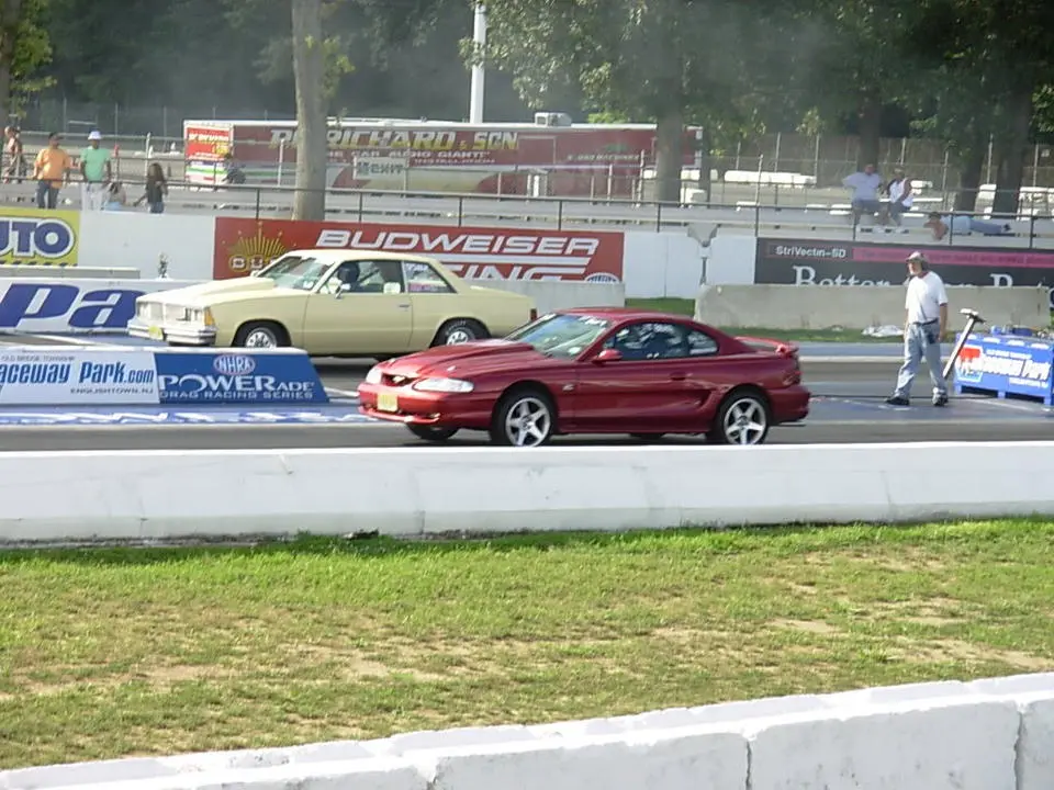

Ok, so today i went to Etown to give the nittos a go, and see if i couldn't break 13's...im gonna go through each of my 4 runs, show some pics, and ask for some serious advice on what i should do for next time. Keep i mind, i know i was "asleep" at the tree...i was more concerned about the launch. Thanks :SNSign:
1st pass:
r/t- .535
60'- 2.225
1/8- 9.37
mph-75.17
ET-14.55
mph-95.39
This pass i was the first car down the track all day, so there was no rubber down, i had too much water on the nittos, i did wayy too small of a burnout in 1st gear, and i launched at 4 grand, basically letting the clutch fly, causing me to spin all the way through first.

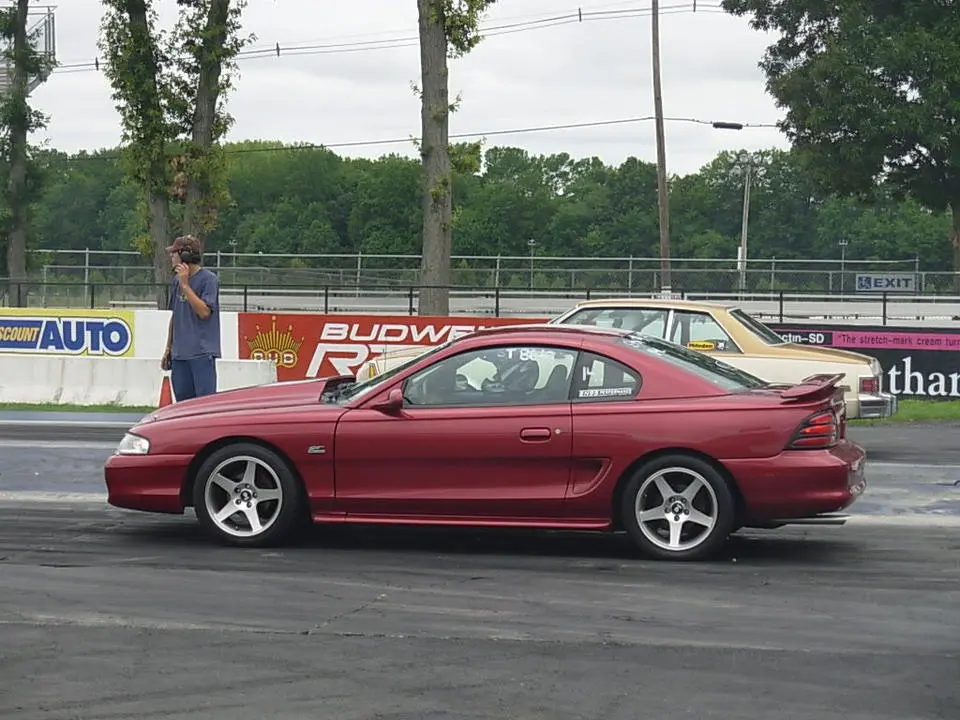

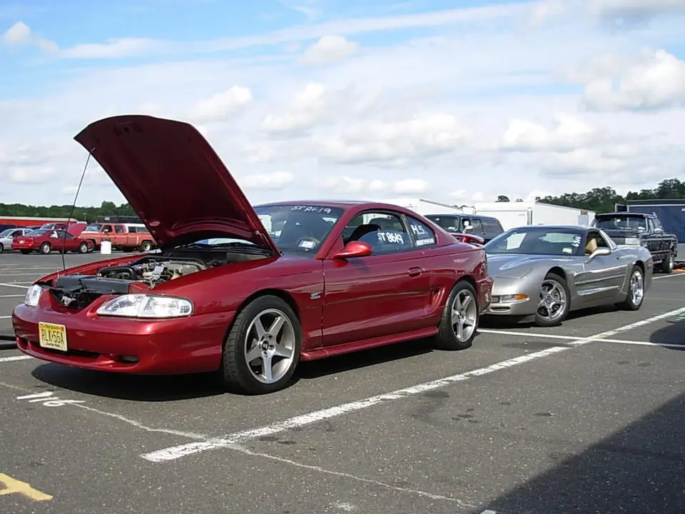

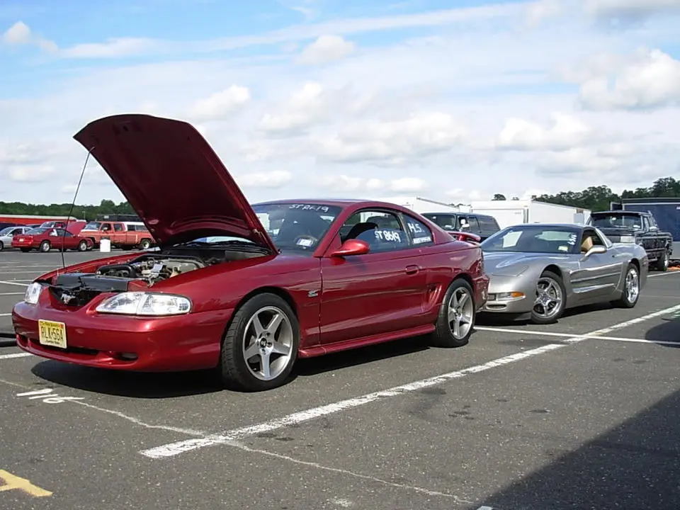

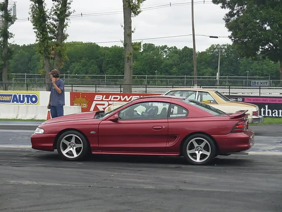

Overall, I had a really fun day, and all my runs (if you look at the 1/8 mile time for the 3rd pass to compare since i got on the brakes at 1000 ft) were within .07, so i think i ran pretty damn consistantly. Now its your turn. What should i do next time that will help me out. And dont tell me more mods, cause i already know that HAHA:mad: I really wanna max out on what i have, cause im not gonna be able to get any mods for a while. Any help is appreciated. Heres a few pics to part with. :D
And a pic i bought in a frame from the track photographer for my dorm room in the fall:nice:

i agree with the gears but that is a mod so....
try to launch at a higher RPM as to not bog down. you might be able to get better 60' times. work on the reaction time. all things you already know.

Who's vette is that parked behind yours? Is it the one that couldn't get past 1st eliminations? :hail2: Mustangs :hail2:

thanks guys, ill be getting 3.73's eventually but i think i needa raise my launch rpm at least 1000 rpm's...i think that me launching at 4 grand the first pass and spinning deterred me from doing it again, but then i thought about it and i had so many reasons why i didnt hook....ill let you guys kno what happens next time
