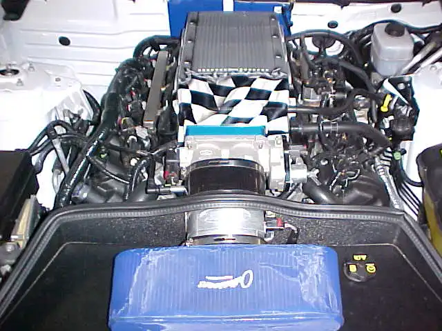

Hey all, had to join here to voice my opinion on the WMS. BTW..long time reader, first time poster.
By far...the truest CAI out there. Hands down the lowest datalogged Inlet temps from any brand, not by a small amount...but a drastic one. With these cool temps on the east coast, my ram/heat tray,MAF,TBS,TB, and upper intake are ice cold to touch, gotta love it. Ambient inlet temps are easily obtainable with the WMS, try that with ANY other "cai" out there...not happening.
Other "cai's" that use the OEM location due nothing but suck in heat, tons of heat, datalogging proves that fact, but some do look pretty good, and some make power as well.
Im not affiliated with WMS in anyway, but I have playing with this CAI since SEPT, so I have plenty of real world experience with them. Up next...testing the 95mm Billet MAF.
Heres just one link with tons of good reading on the WMS..
http://forums.bradbarnett.net/index.php?showtopic=33814&hl=wms
THE GREEK
There are two things about the WMS intake that bugged me... First that their product did not include an extended wiring harness for the MAF sensor, instead requiring wires to be cut and spliced. Second is the fear that with the loosely fitting hoods on some 05's that a good driving rain storm would fill up that Ram air box with water and provide a path for water to get into the engine. :bang:
The WMS very well may be a better design but I think I'm gonna stick with my hella cool looking MRT intake! :nice:
