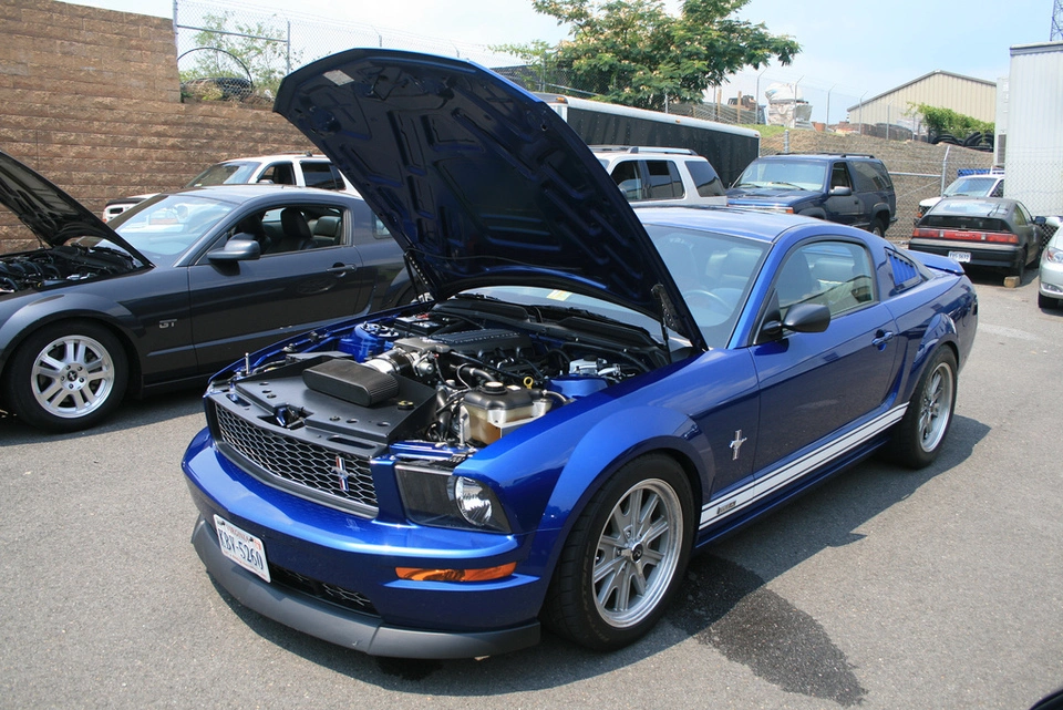

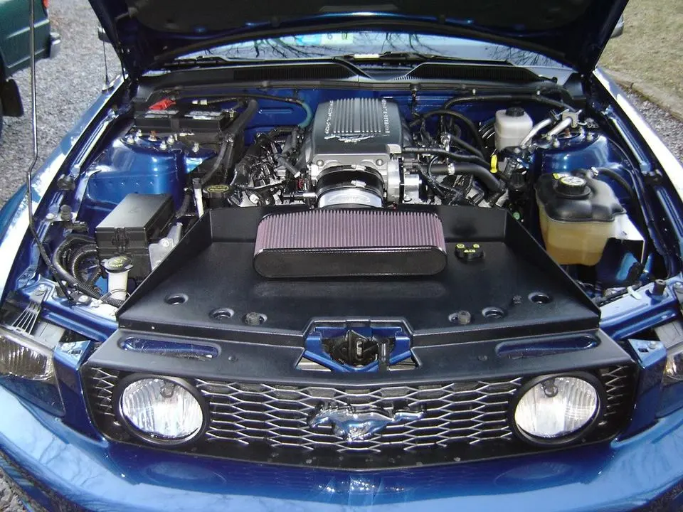

I've had my WMS CAI for nearly two years now. I love the look, BUT recently found out that it's not the best design for our throttle bodies from Doug at Bamachips:( I had asked him if it be worth my time/money to upgrade to their larger MAF and he said ditch it all together...
The ram air tray is designed to work with the factory hood, not ram air hoods as the tray wouldn't match the contour of the raised hood. To aid in the air department, I swapped out the OEM grill that the fogs blocked the openings in the tray with the Bullitt grill and cut out all the holes in the honeycomb. I'll be switching out to a C&L CAI soon-ish for some more power.
I think Doug @Bamachips is just trying to sell you another CAI. I have had the WMSracing CAI on for almost 4 years with never a problem,Started out stock with no tune,then mail order 93 tune from another vendor, no prblems ran great.Stepped up to a Saleen Series VI SC upgraded to the WMS 95mm tube, 39 lb injectors and 3.6 pulley along with HI flow catted x-pipe, dyn'd on a Mustang dyno last week 4/2/2009
442wrph and 424 tq. 8.6 lbs boost Max'd out the fuel pump at 5800 so back acouple degrees of timing outand settled for 424 wrhp. All this with the WMS racing CAI.I would not use any other personaly.

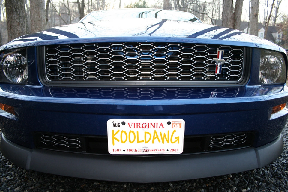

I guess it's hard to dyno the WMS as it really should have the hood closed and the air forced through the grille to maximize its ram air design. That was part of why I ditched the GT fogs. The fogs were blocking two of the three ram air openings.
After I got the Bullitt grille and opened it all up, there were no restrictions!
