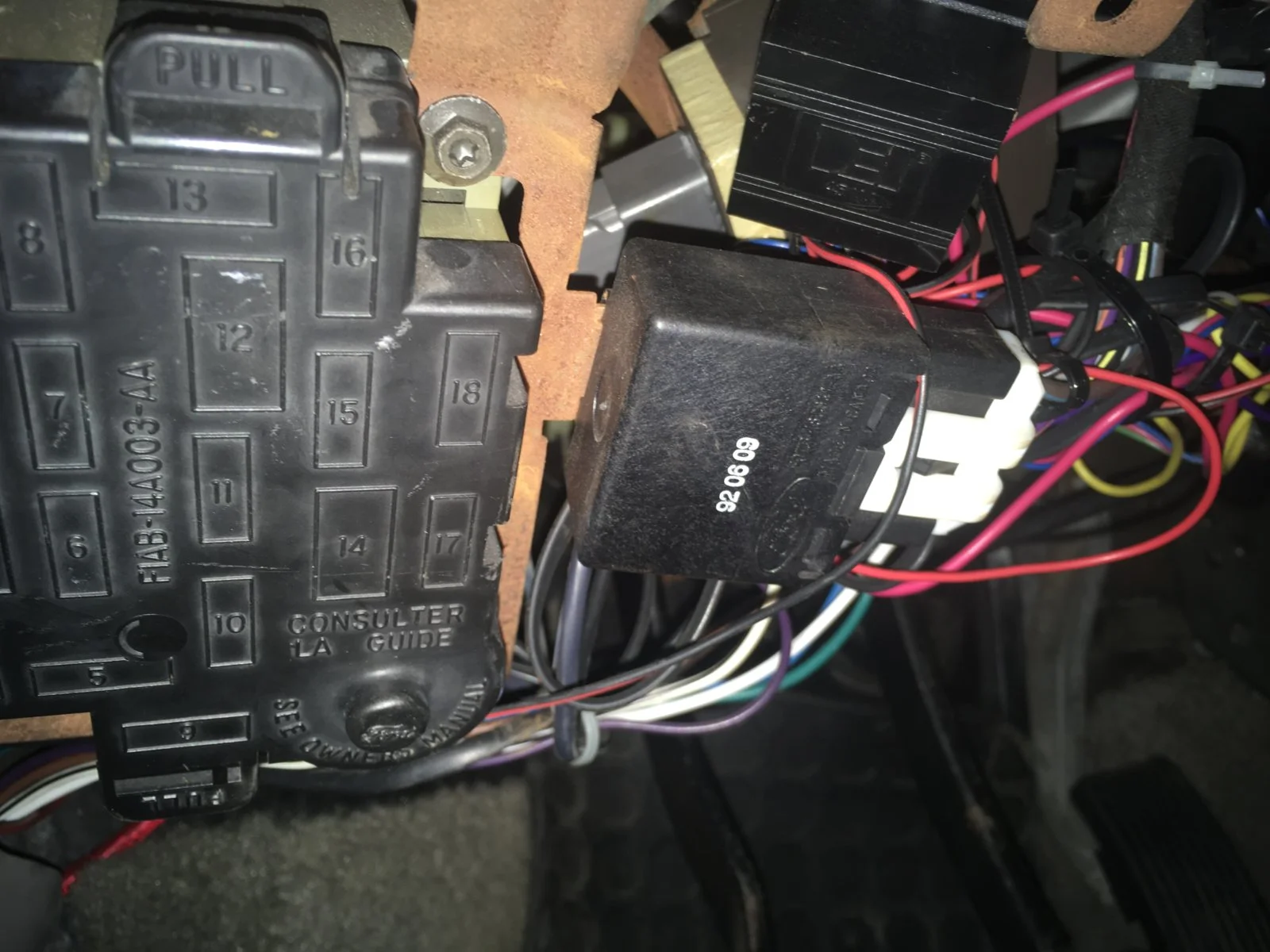

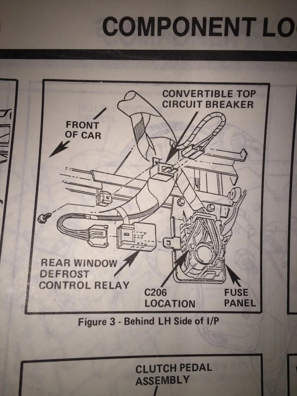

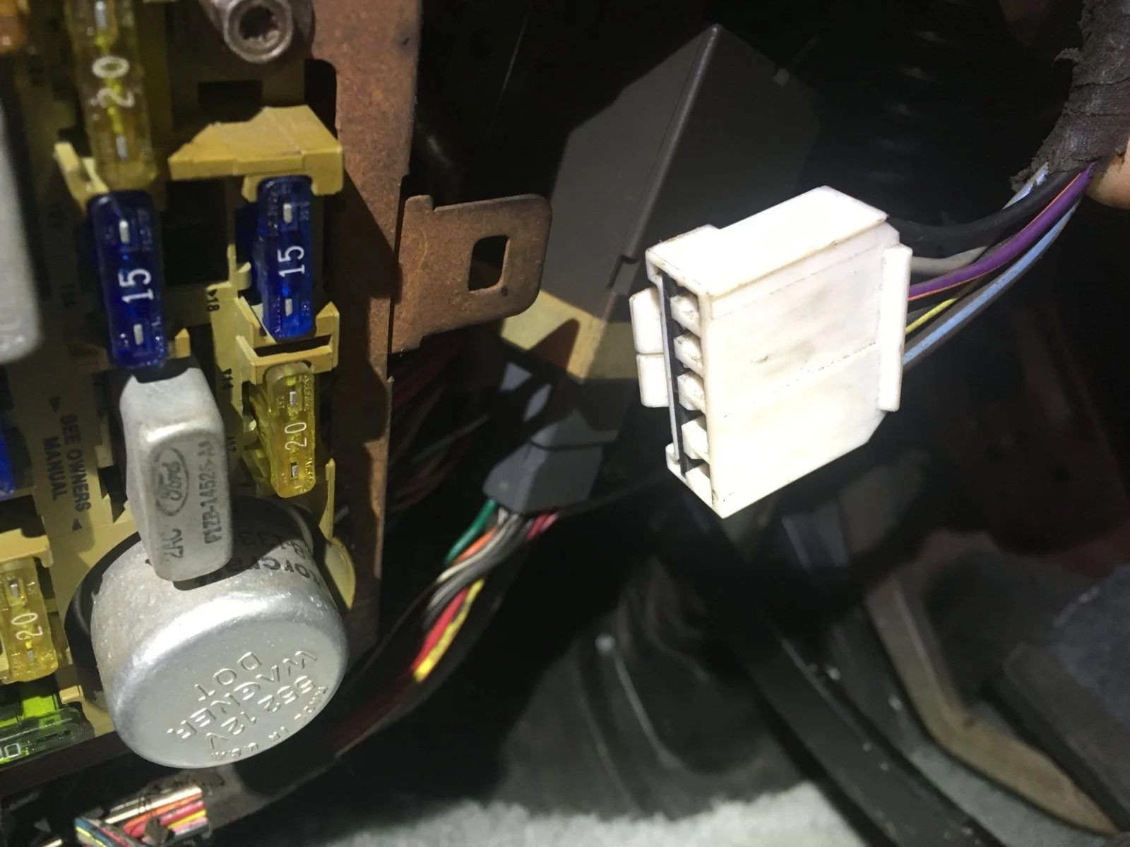

Under the dash on the 93 I have an orphaned connector. I looked at my 92 and this connector is hooked to a little black box which is mounted on the side of the fuse panel frame.
What is the little black box this connector hooks to?
The 93 is a convertble. I assume that verts did not have rear defrost. Thanks for the quick answer.

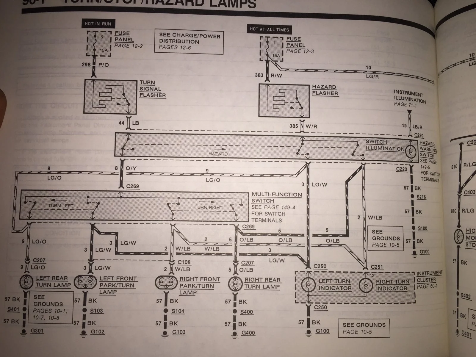

One other question. Is there a different flasher for the hazards and the turn signals? My hazards work but the turn signals do not. Both worked before i took the dash out for painting. Now the turn signals dont work.
