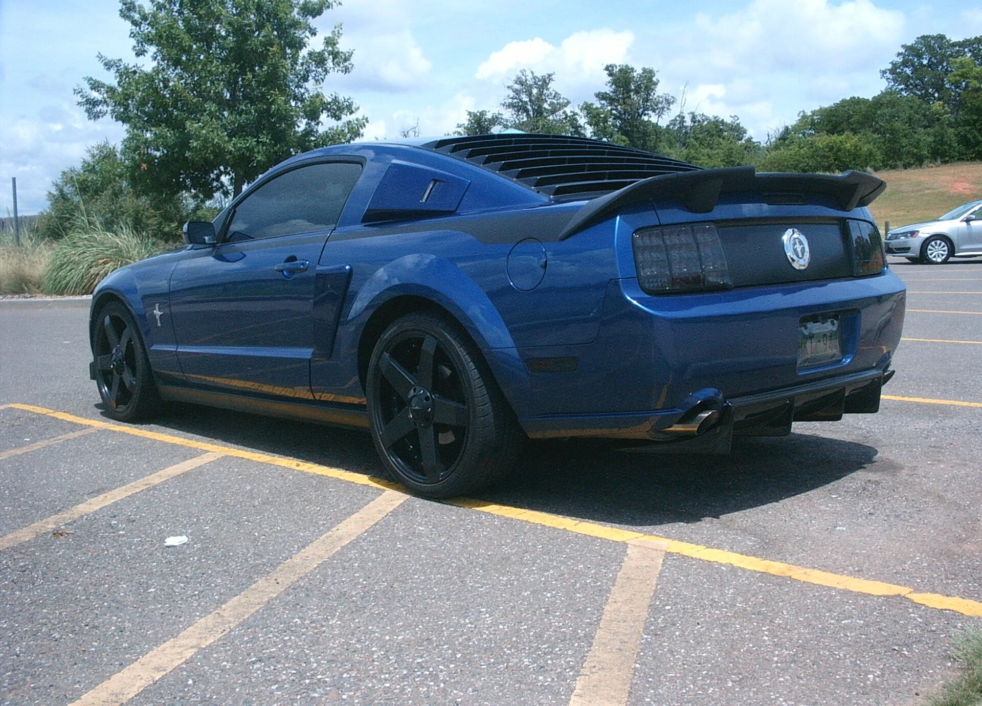

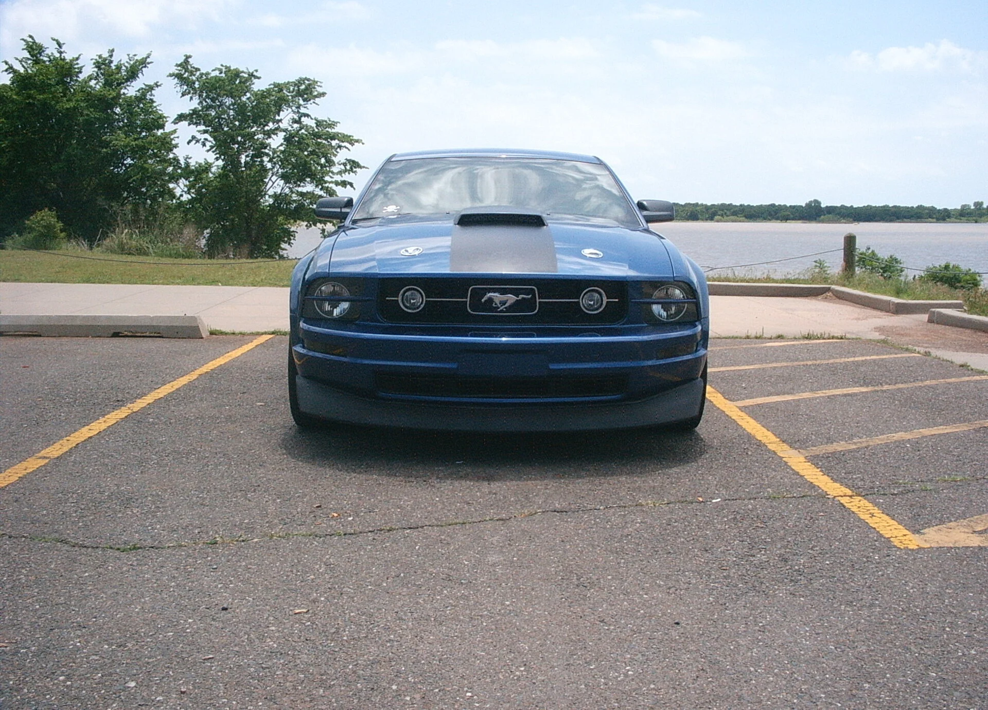

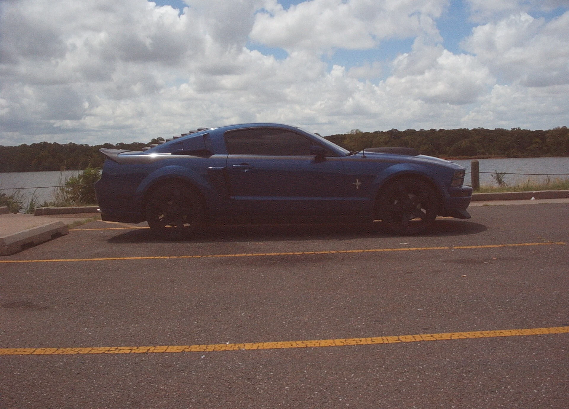

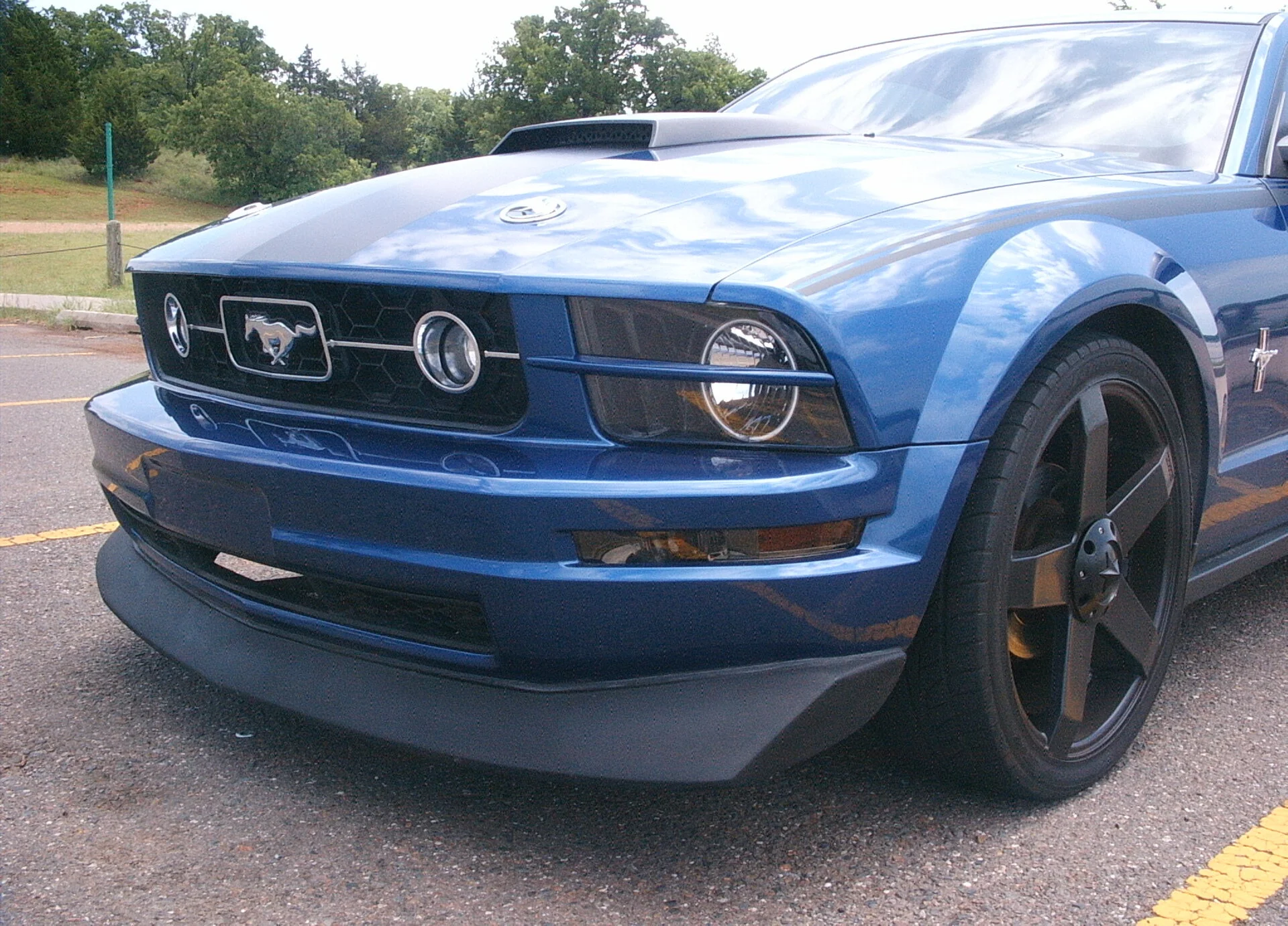

Promised new pics with the new tail lights, smoked front corners, smoked led third brake light, head light splitters and hood locks. Also like I said couldn't find any smoked rear marker lights. So I blacked out almost the entire things except a little trapezoid in the center where the bulb is. Can't really see them now, but that's the point.
Hit that front spoiler for the first time yesterday leaving the local Ford dealer. Didn't break, minor ding on the lower surface. I suppose for a large low hanging front spoiler like that, it's to be expected. Couldn't avoid it. Exit from the dealer downhill, street goes uphill at the same point. Double edged sword. I was like, Oh :poo:, it's broke! LMAO!

Excuse the dirty fender behind the tire. As is typical around here, clean your car, and some business cleans their parking lot. End result, water in the street you cannot avoid. GRRRRR!!!!!

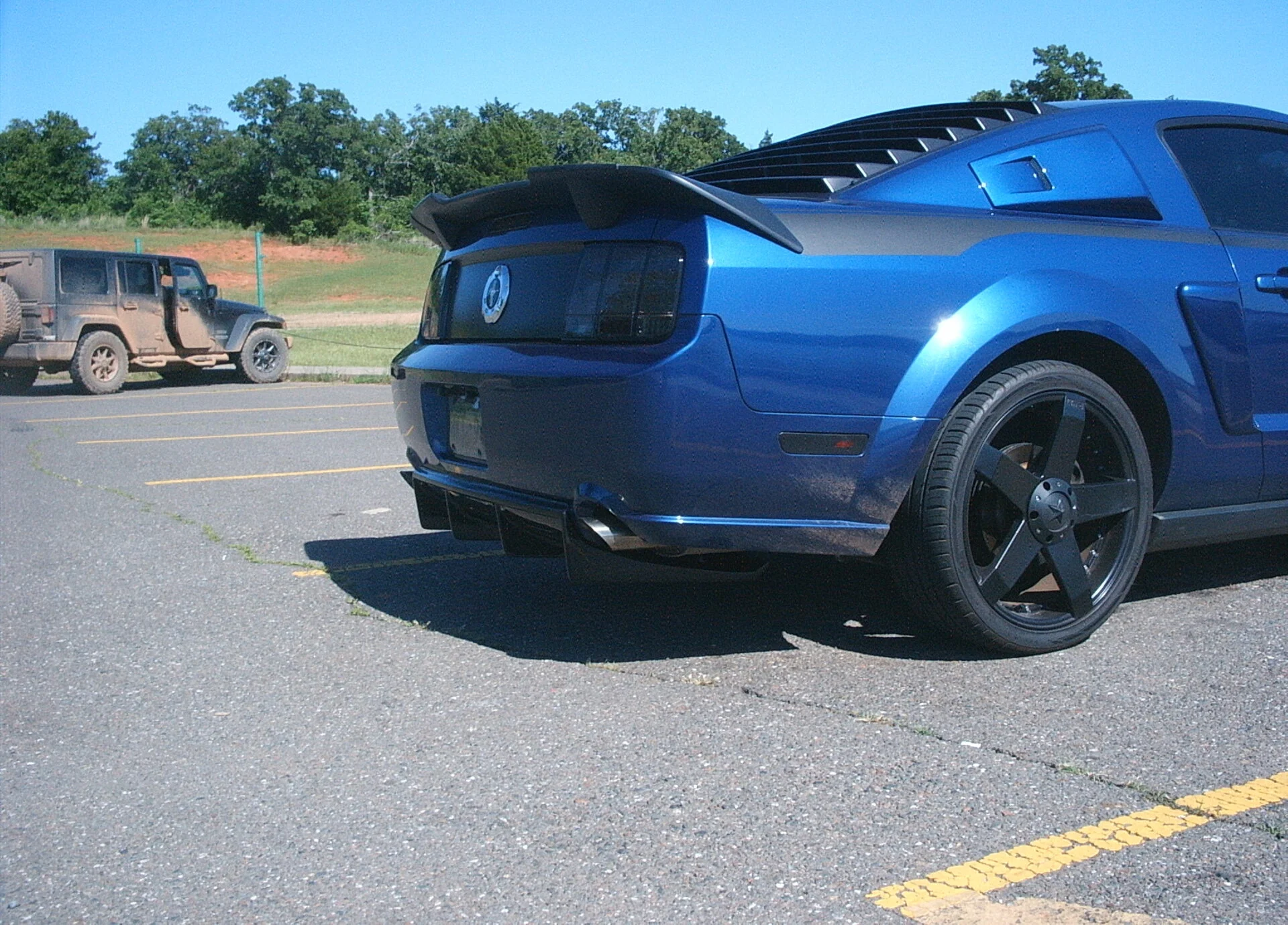

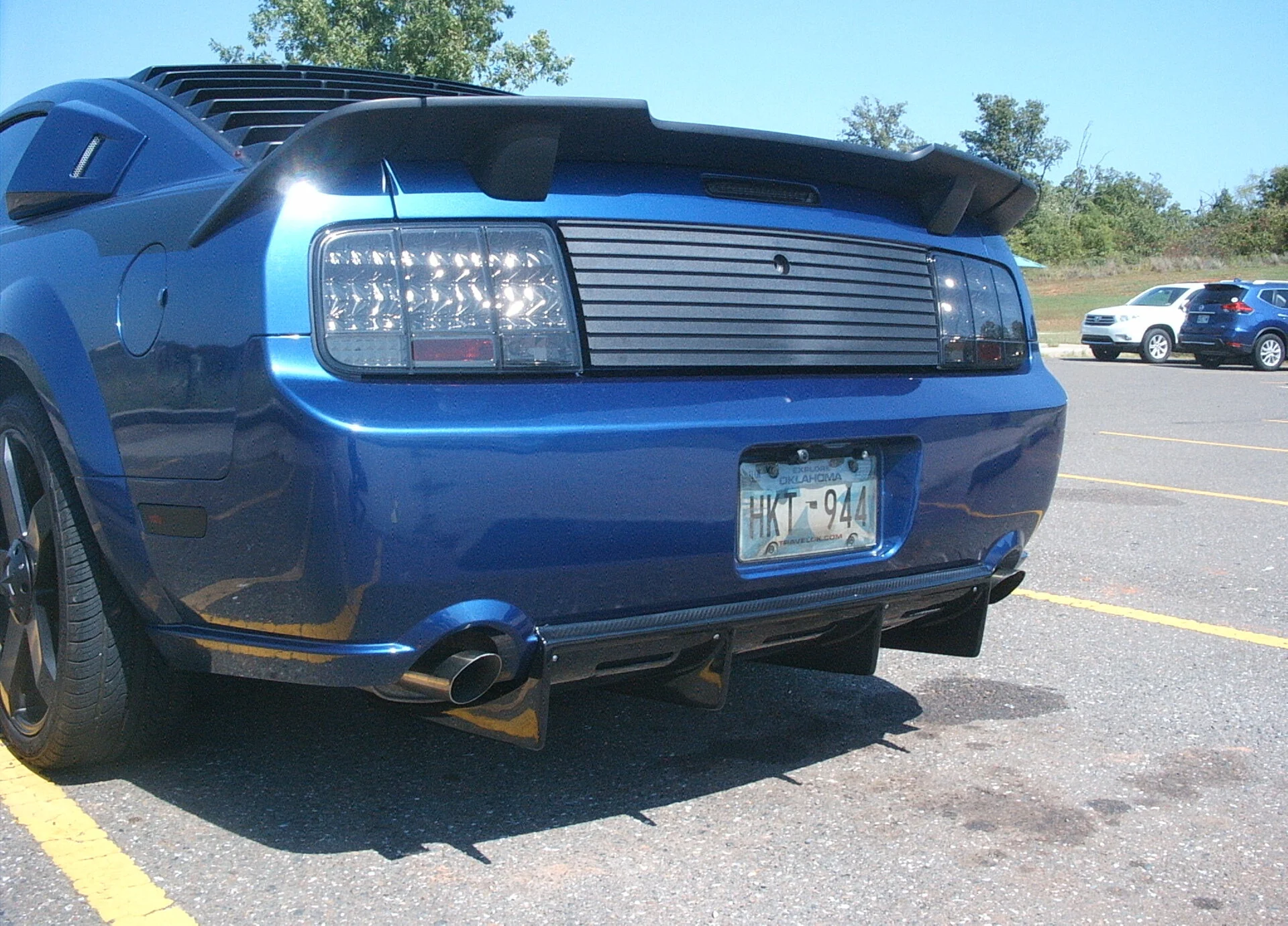

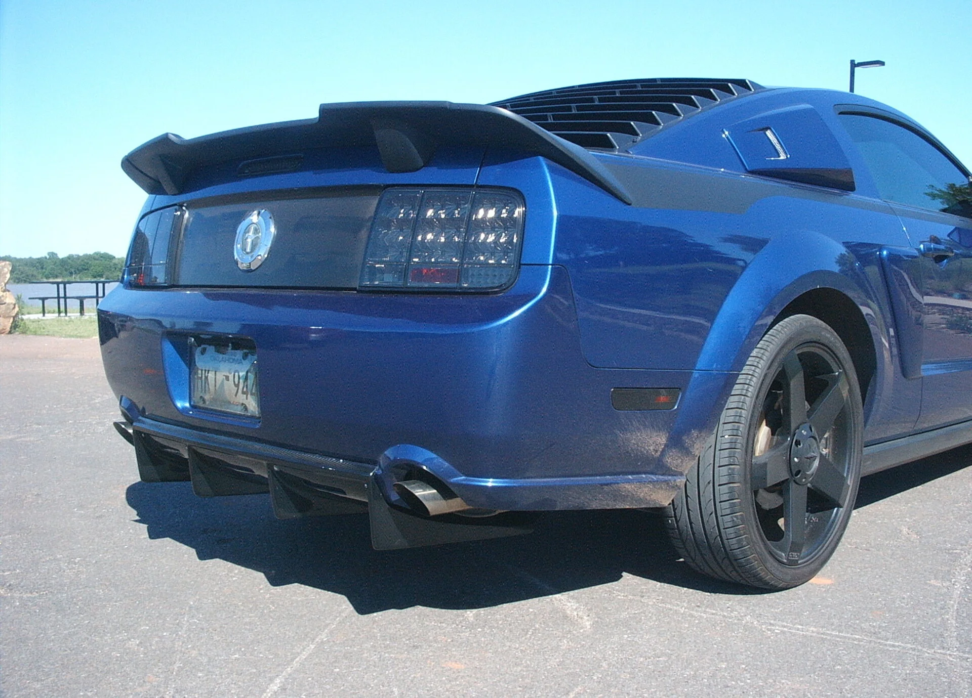

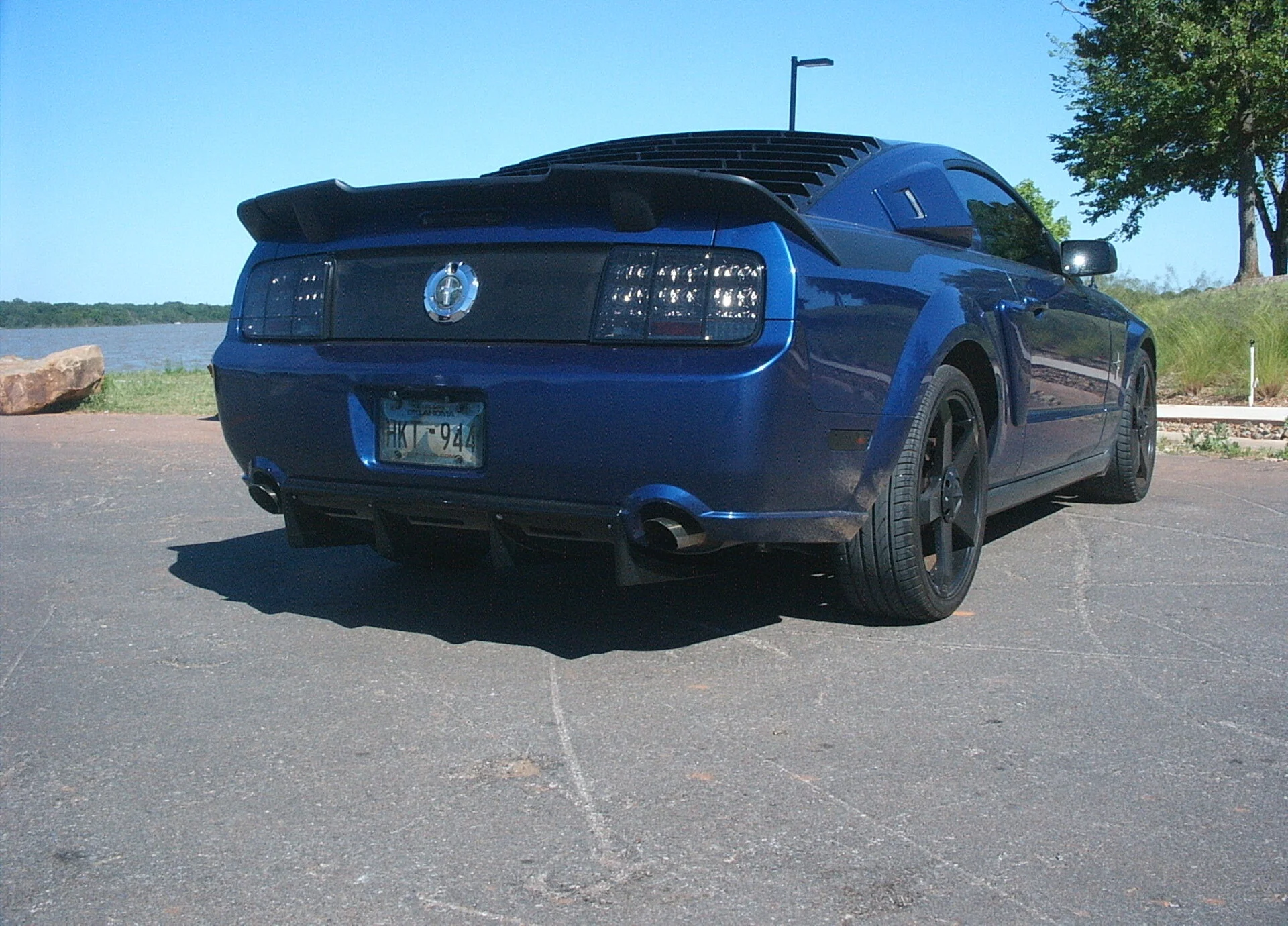

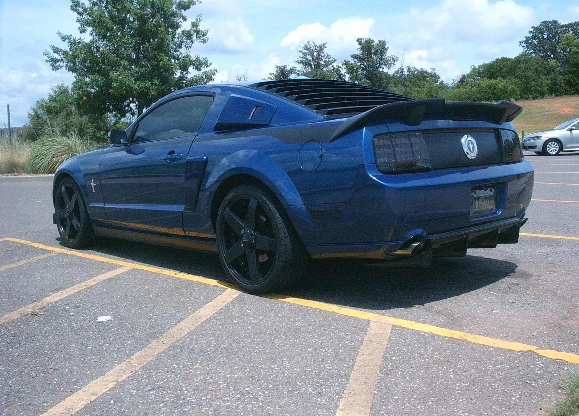

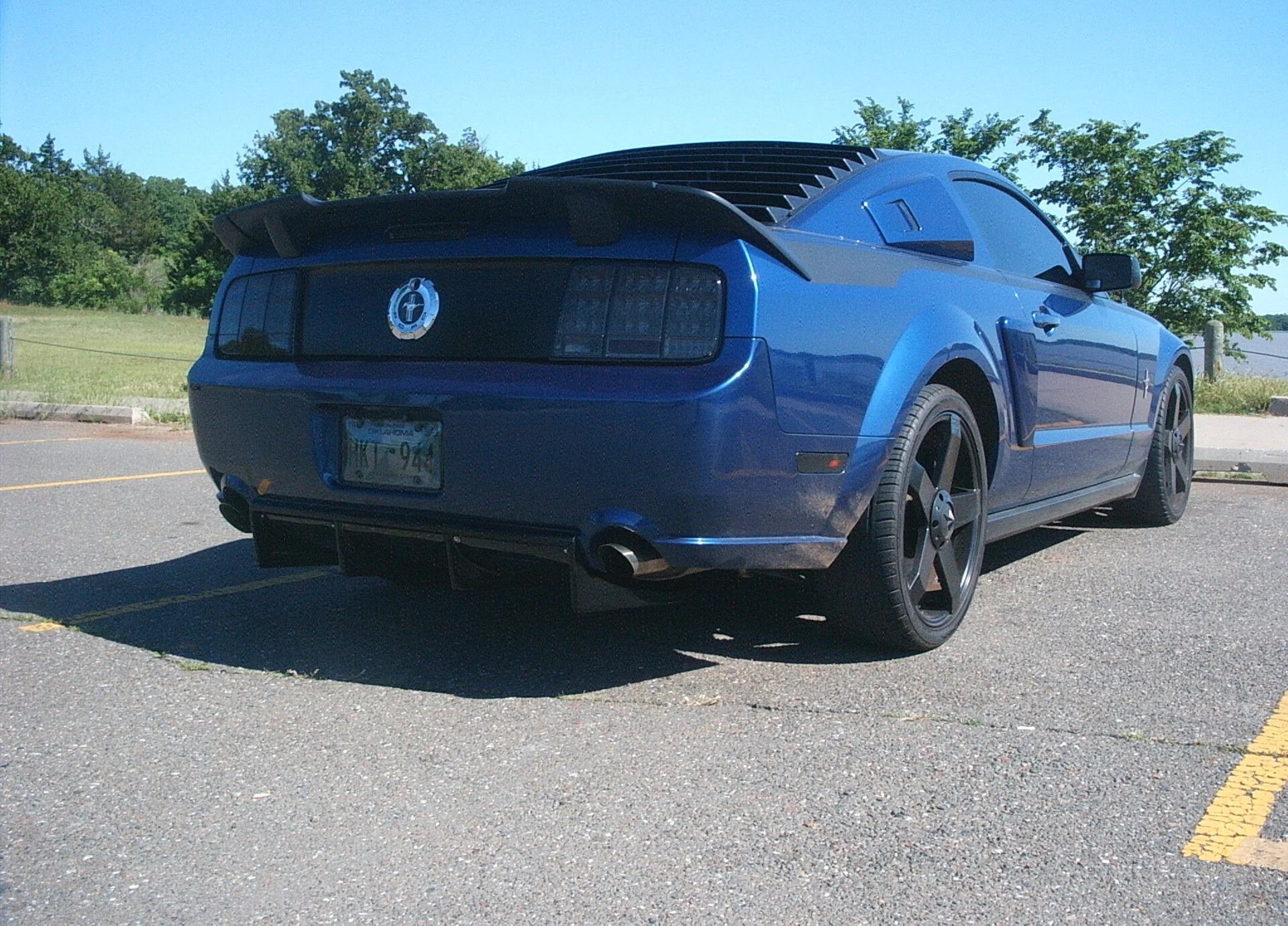

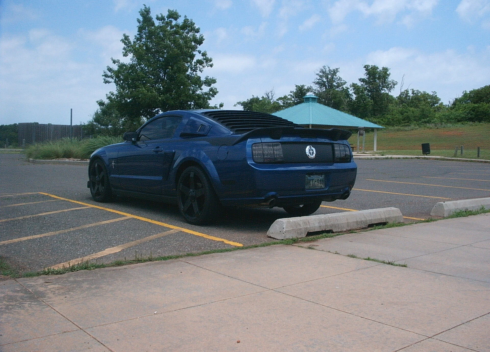

This is the APR Performance carbon fiber diffuser for the 2005 - 2009 Mustang, GT bumper only. Fits exceptionally well, kind of a PITA to install for six bolts. The back four are drilled in the carbon fiber. The forward two you have to drill. You need a 1/4 inch Brad Point Drill to drill it without causing splintering. ACE has them.
APR also has some "skirts" that fit under the doors and under the rear bumper. They are also carbon fiber. They're next. ;-)

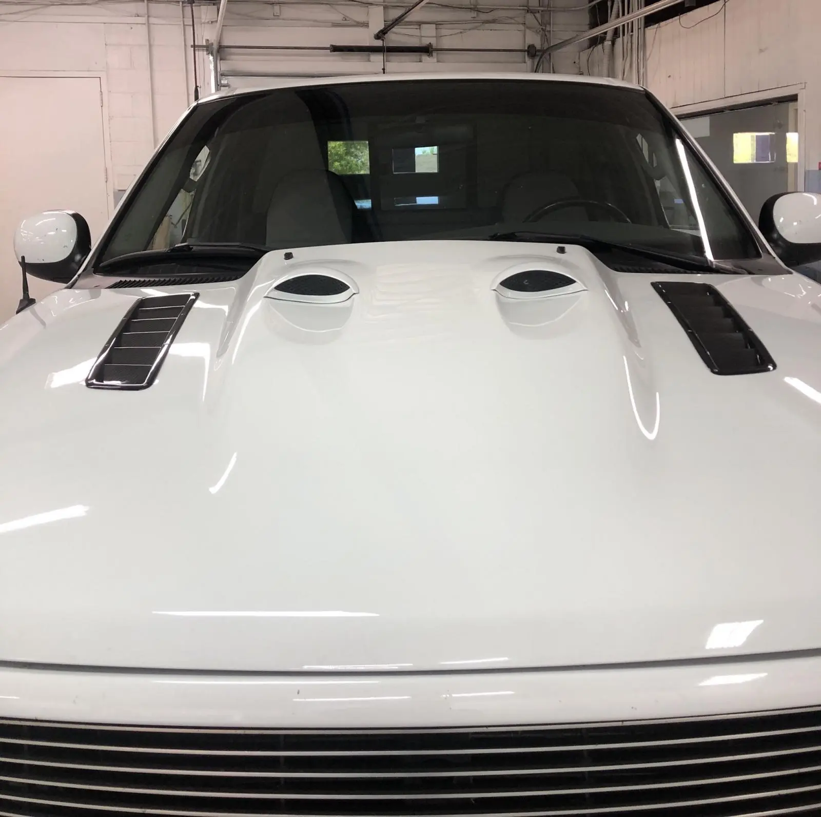

Then there is the 2013/14 carbon fiber hood vents. Like the ones in my Lightnings hood.

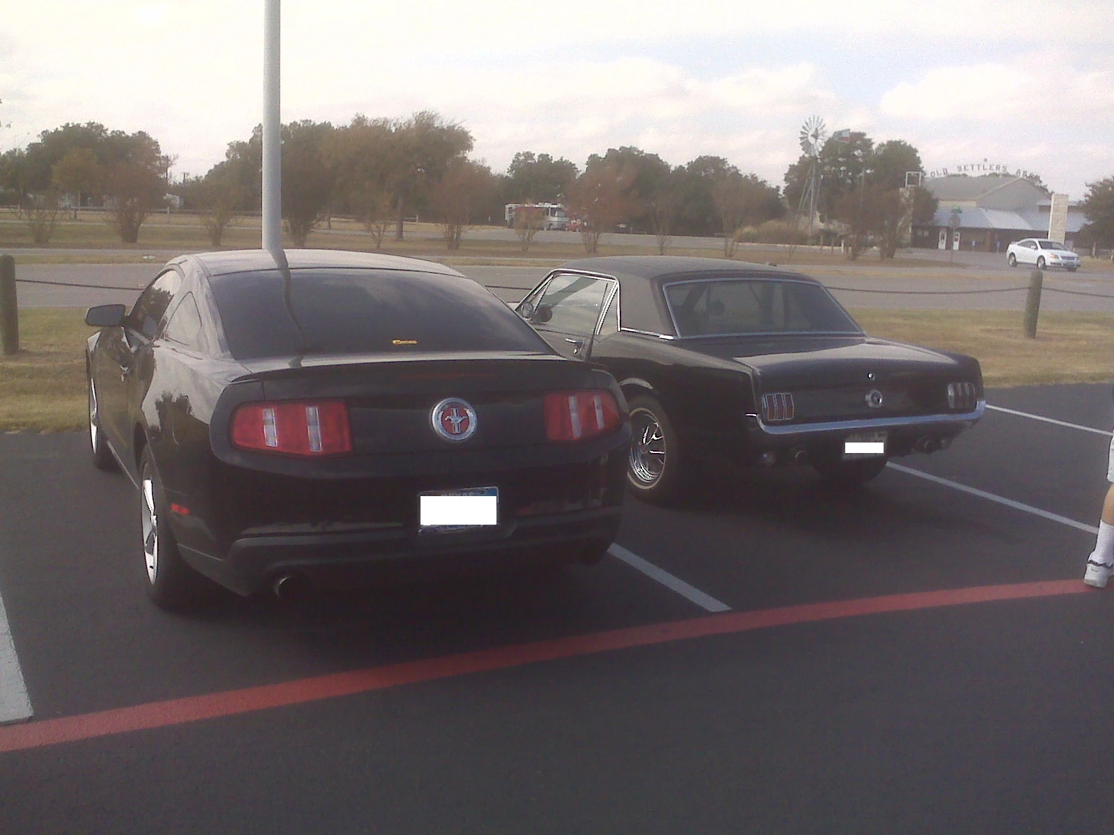

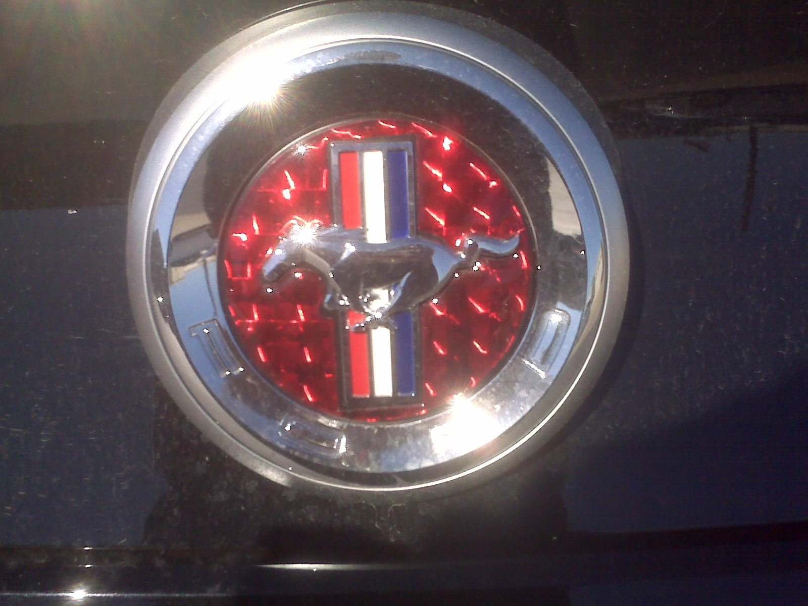

When I had my 2010 GT, this was the first of two appearance mods I did, and was my favorite, because it got a LOT of attention.
I ordered the V6 "faux gas cap" from the Ford dealership I worked at, and put the reflective red vinyl inlay in it to make it more reminiscent of the old gas caps from the 60s cars, combined with the cool look of the red center caps from that era.
I think it worked pretty well, here it is next to the 1968 GT of one of the other members of the car club I was in back then.

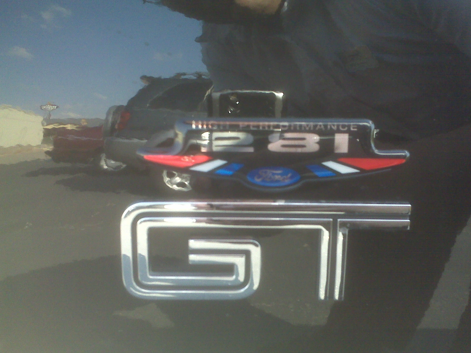

The other appearance mod I did was these fender badges:
While I liked them at the time... I'm not sure I'd do them again.

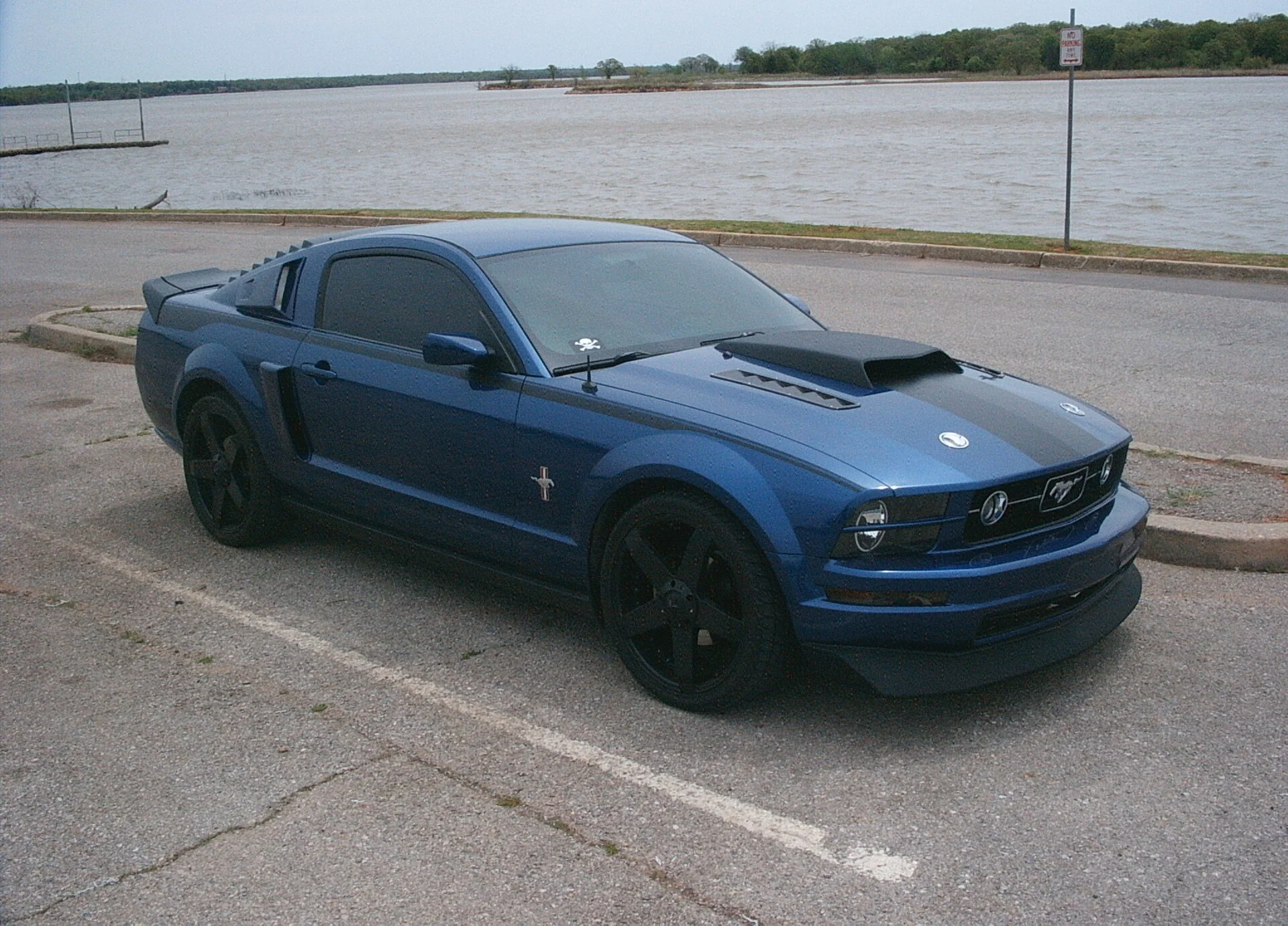

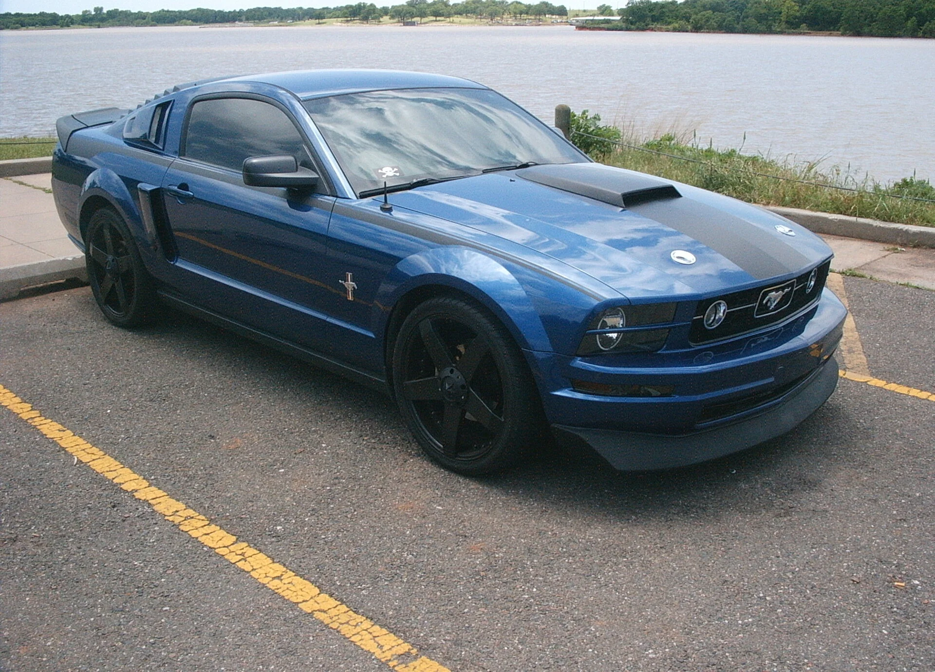

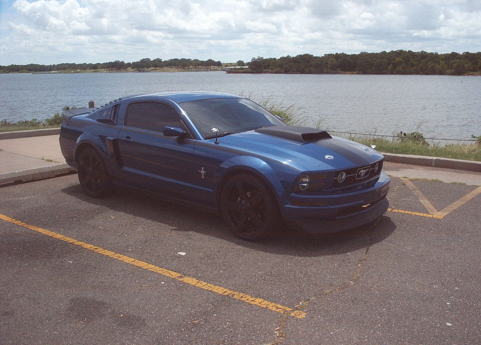

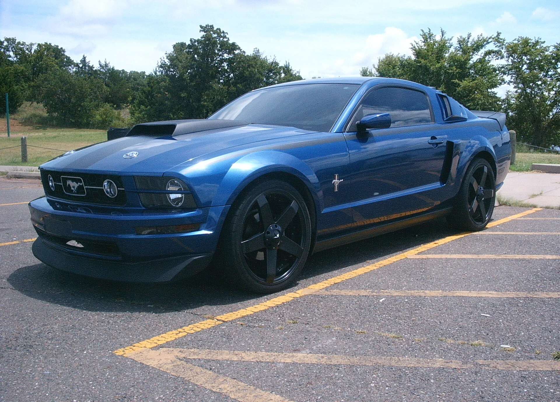

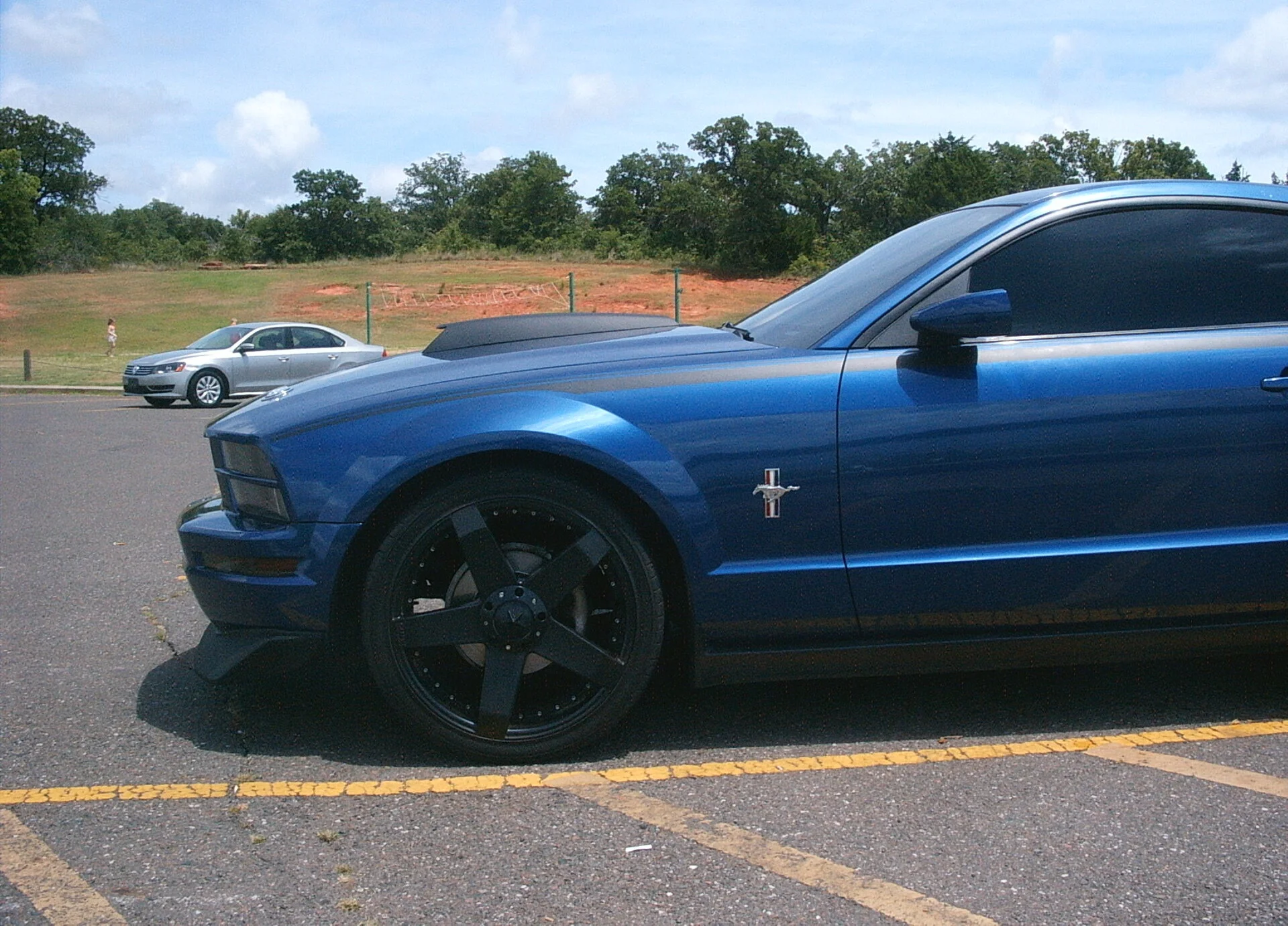

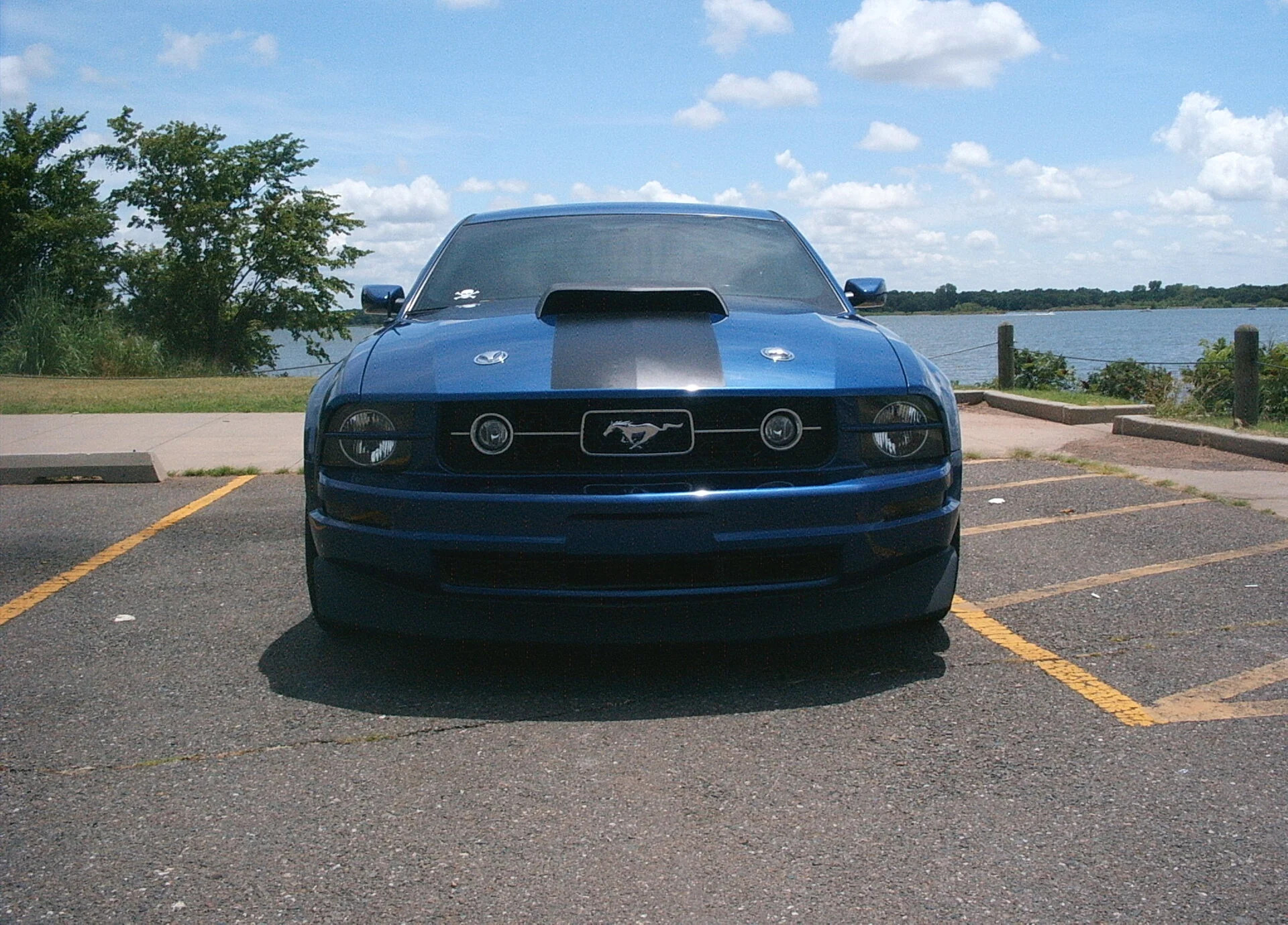

As promised, new pics with the Boss 429 hood scoop and the new sport car mirrors, MMD Classic Style Mirrors. On the way to the picture taking site, a little boy told me "really nice car". Hopefully he grows up to like hot rods.

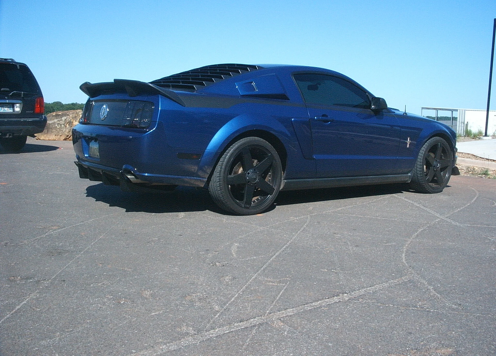

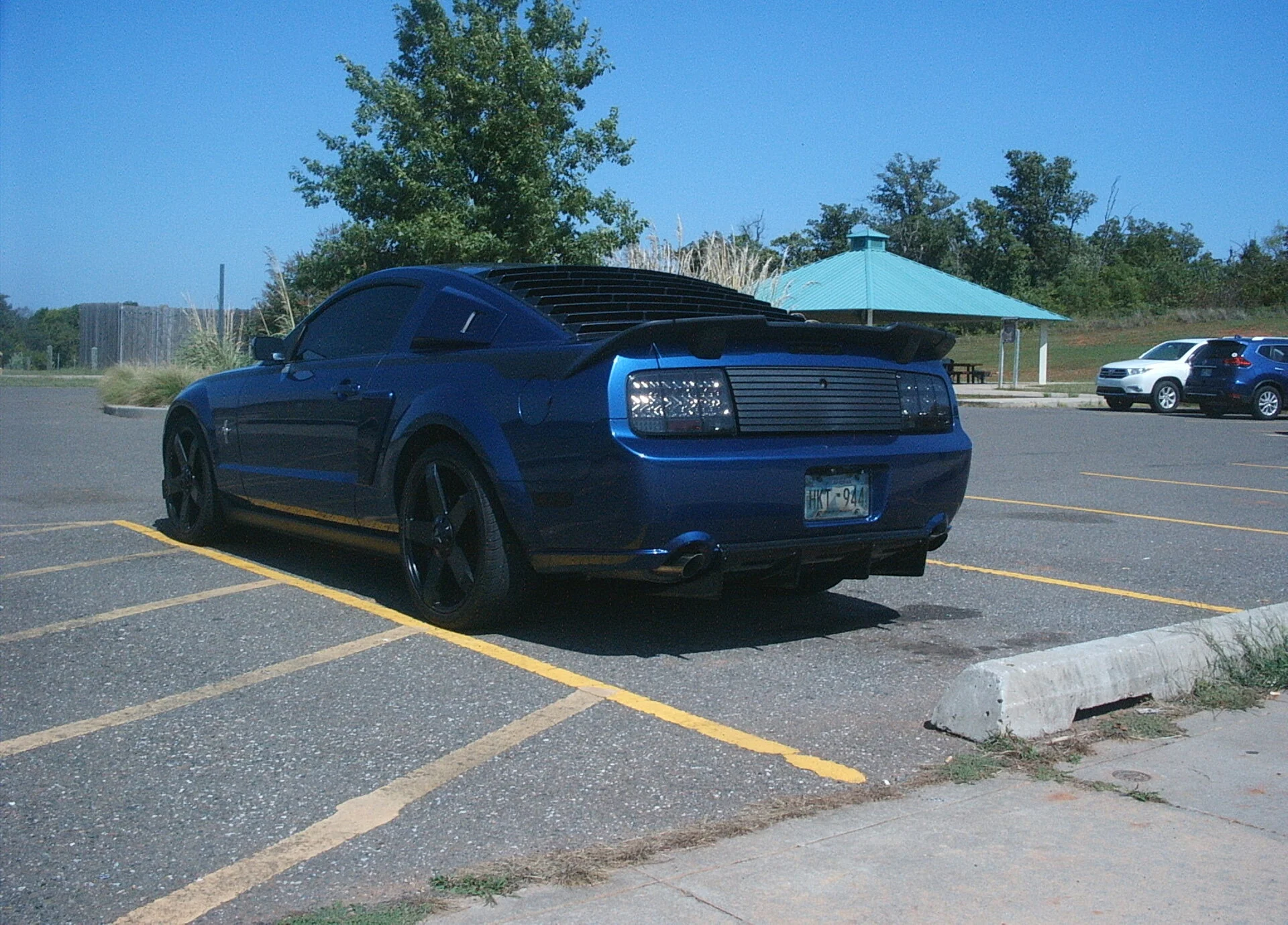

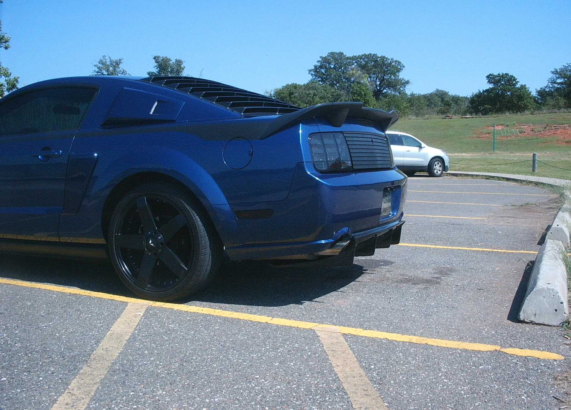

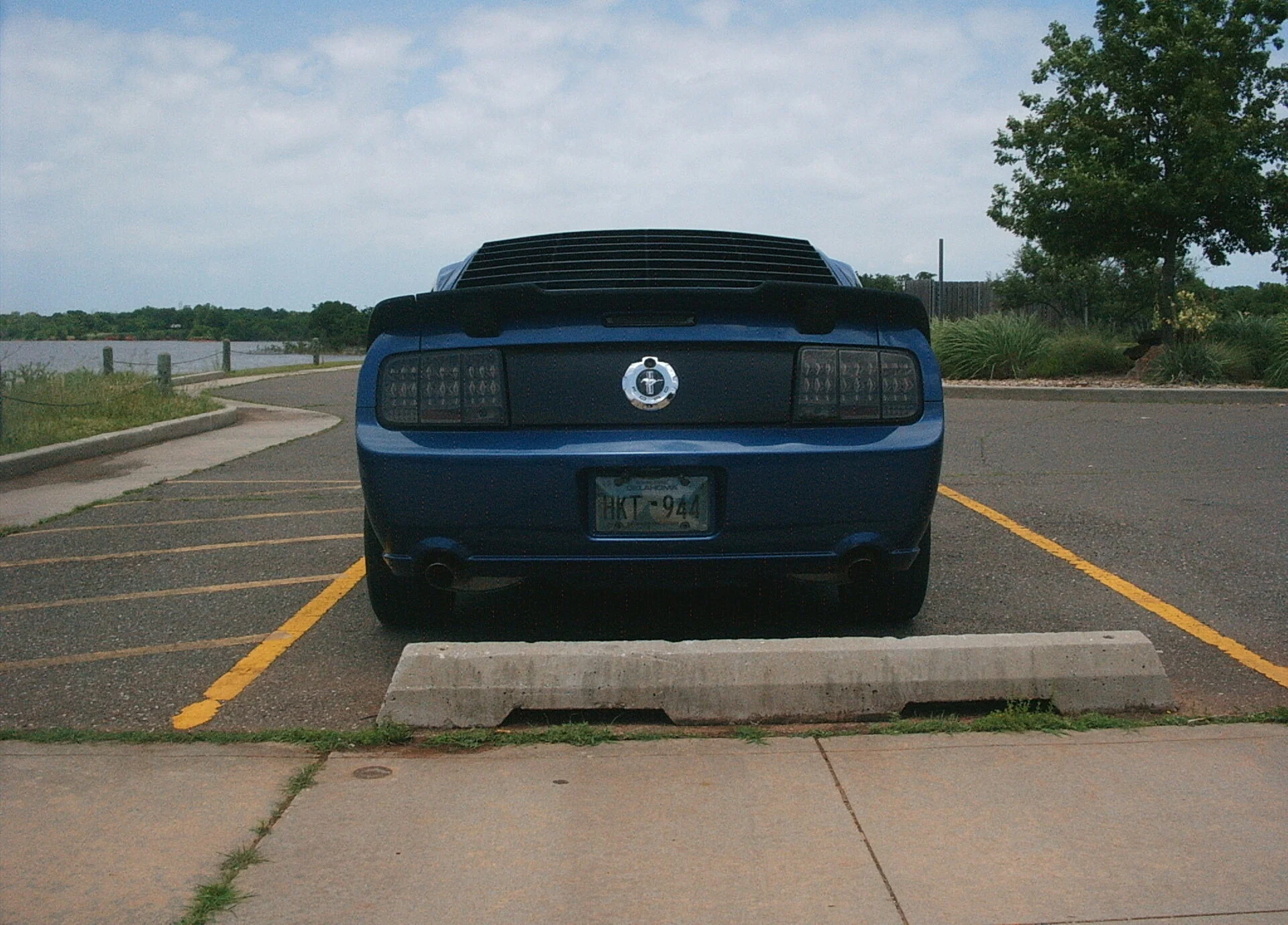

Deleted the fake rear gas cap this weekend. Mine was kind of grungy anyways, and couldn't find a replacement. So I went another route. They provided a black circullar sticker to put around the key receptacle, but it didn't fit well. So I just used black RTV around the key hole after the install. Also faired a layer of black RTV along the entire top edge to eliminate what I thought to be an unsightly gap there. Much nicer having done that.

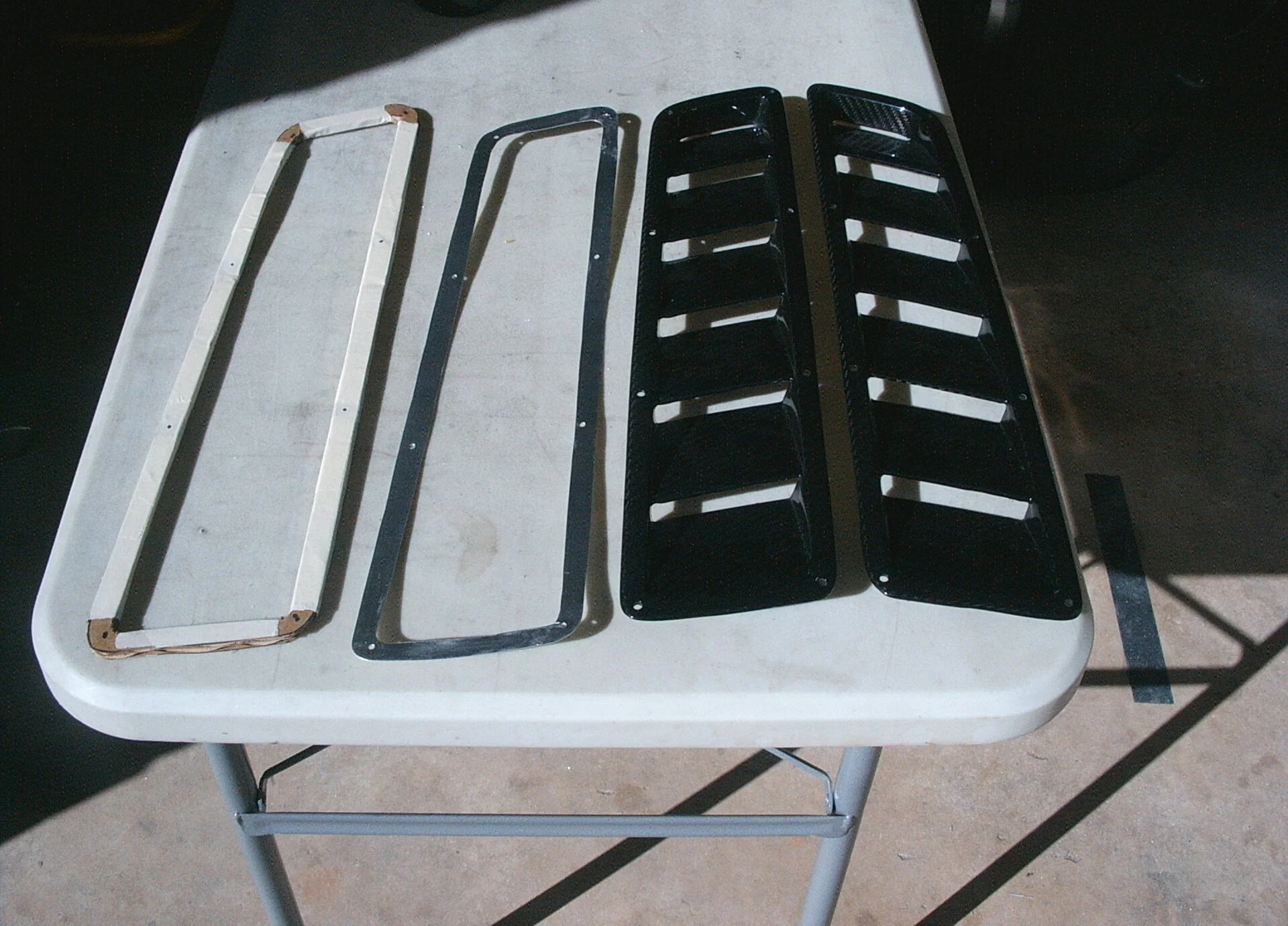

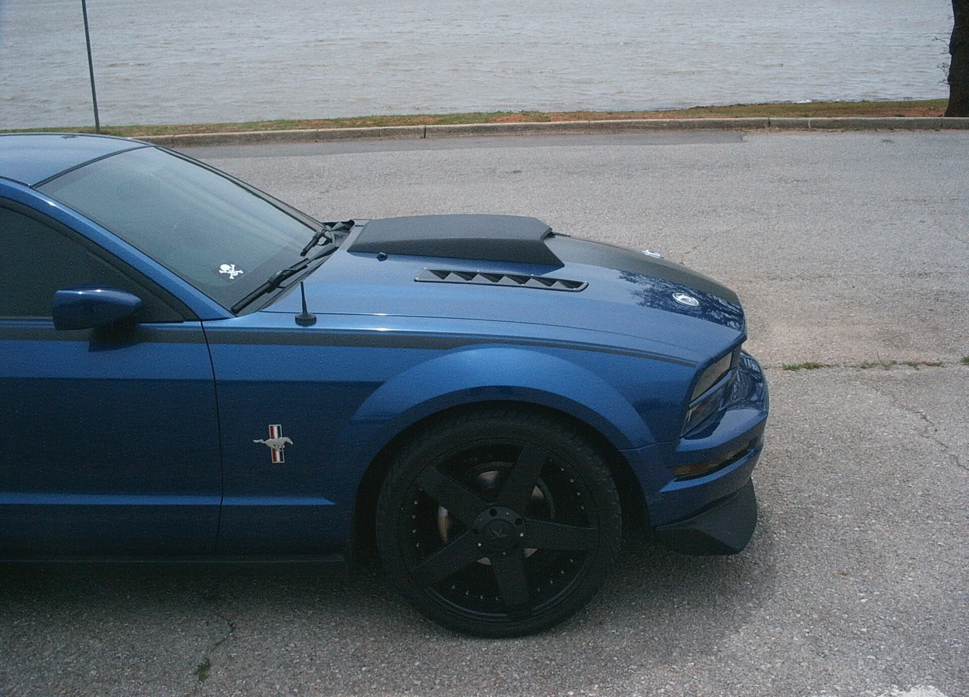

I got the carbon fiber hood vents installed. Finally. Car had a transmission failure, so it was out of my hands for 3 weeks. Got them done Sunday the 25th of April. I had made an aluminum template to transfer the inner outline to the hood. When I finished cutting the hood, the pieces I cut out were mirror images. Couldn't have turned out better if a pro had done it.
Sorry, no pics at this time. I'll get out to the lake tomorrow and take some good pics. Do have a pic of the cardboard and aluminum templates I made to mount them. I will keep the templates, since I took the car out on cruise night Sunday evening, and already have two others that want me to put some on their cars. Not holding my breath, these carbon fiber parts are $400 for two.

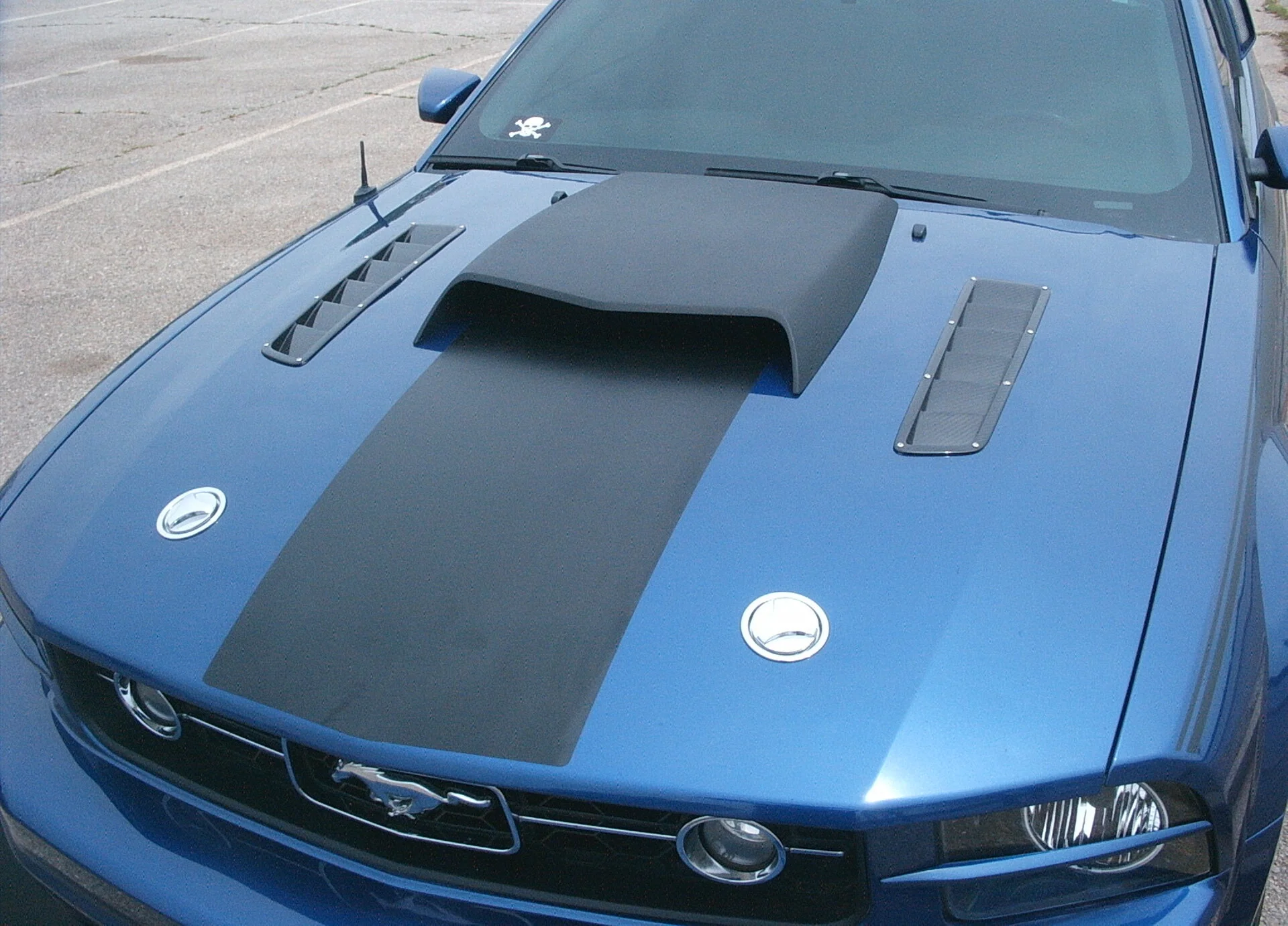

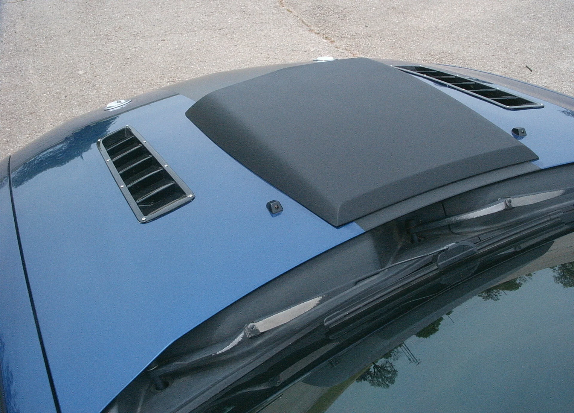

As promised, here are pictures of the installed carbon fiber hood vents. They turned out Bitchin! l already have another guy in town that wants me to install some on his 2013 Mustang. Fortunately I made that metal template.
I think that next weekend, I will remove the shiny screws and replace them with flush black screws. ACE Hardware has a nice selection of black hardware. I'll have to lightly countersink the holes, but that's not a problem.

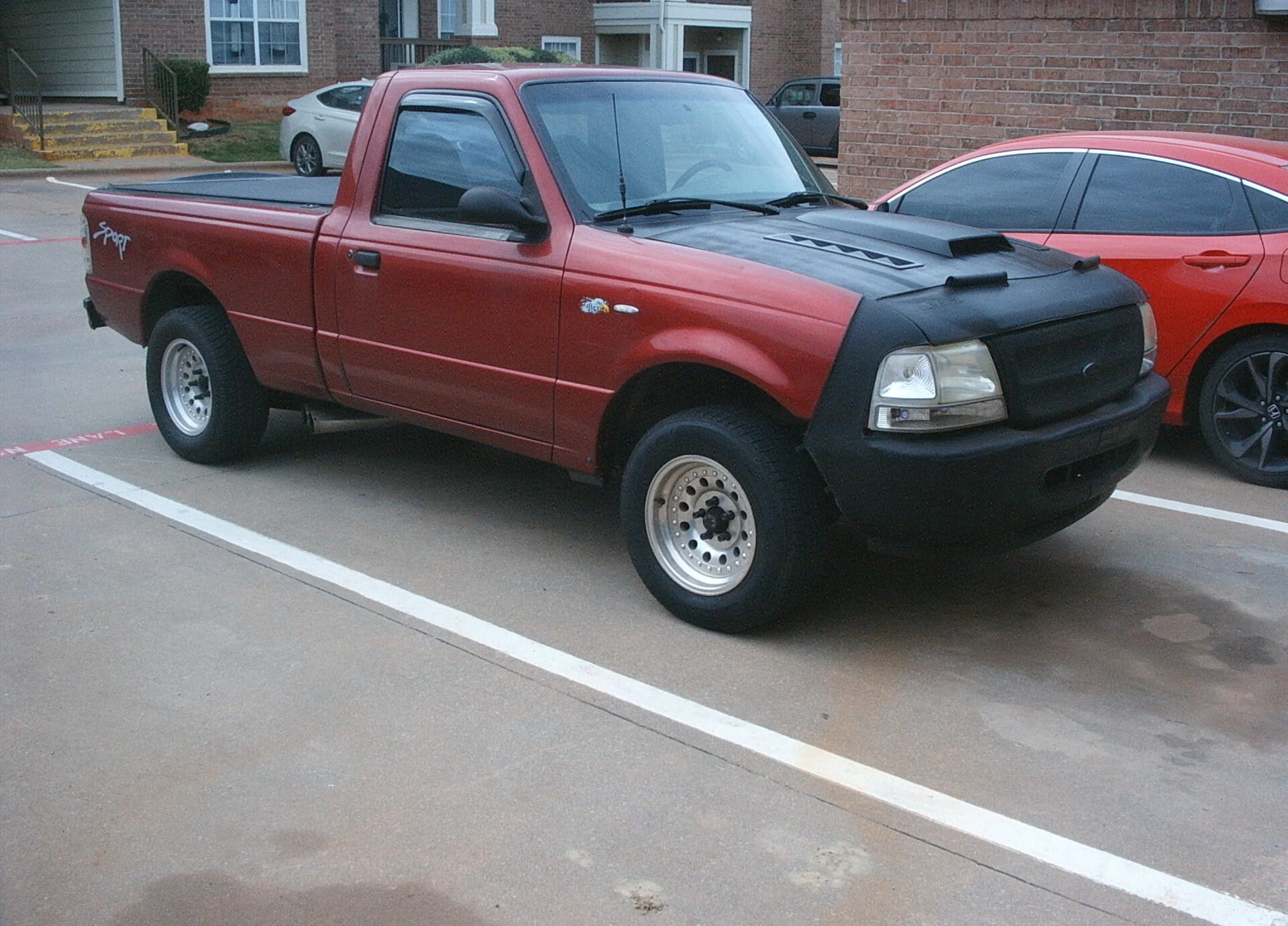

They are far enough out to the side that there is nothing underneath them to cause issues. I have some on my old 98 Ranger, did it first to see if I could do this successfully. Been driving it in the rain ever since sometime in the summer of 2020. Even has an open hood scoop over the center of the engine. Never had an issue. Oh, I don't drive the Mustang in the rain. It stays in a garage, as does my Lightning, which also has the exact same hood vents. The Ranger is the vehicle I keep for when the weather is bad. Rain, sleet, hail, snow, the Ranger is out on the road.
Little story about how well those vents work. It had snowed for a few days in mid February. When I needed to go somewhere, I brushed all the snow off, except the snow in the vents. When I was out driving, at around 45 to 50 mph, all the snow in the vents suddenly came flying out and hit the windshield about halfway up. It would take a lot of force to do that.
There's an aerodynamic engineer on YouTube, Kyle Engineers, works for Mercedes. He has a video on hood vents. Says the advantage is twofold, to let all the hot air out on top, rather than under the car. And also, due to all the pressure building against the underside of the hood, it actually produces life on the front of the car. The hood vents give all that pressure somewhere to go, and it's best if it comes out on top, rather than under the vehicle. He also addresses the water issue in the vid.

Nah. The Ranger is my daily driver beater. I've owned it 21 years, not much I haven't done to it maintenance wise. I use it as a guinea pig. Did the hood vents on it first, just to see if I could do it. A friend with a shop is going to change the axle gears from 3.73 to 4.1 here soon. If I like it, I will be doing the Mustang and Lightning with the same gears as well.

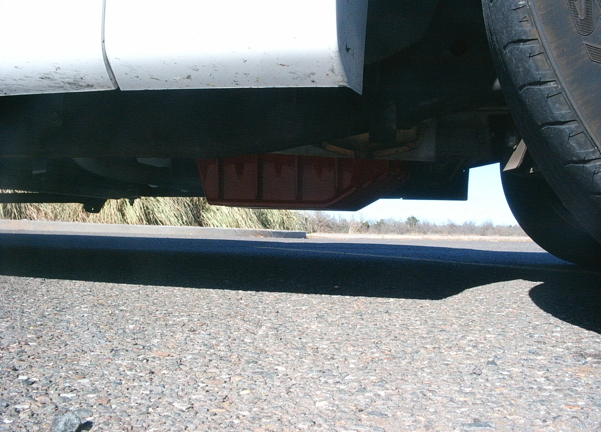

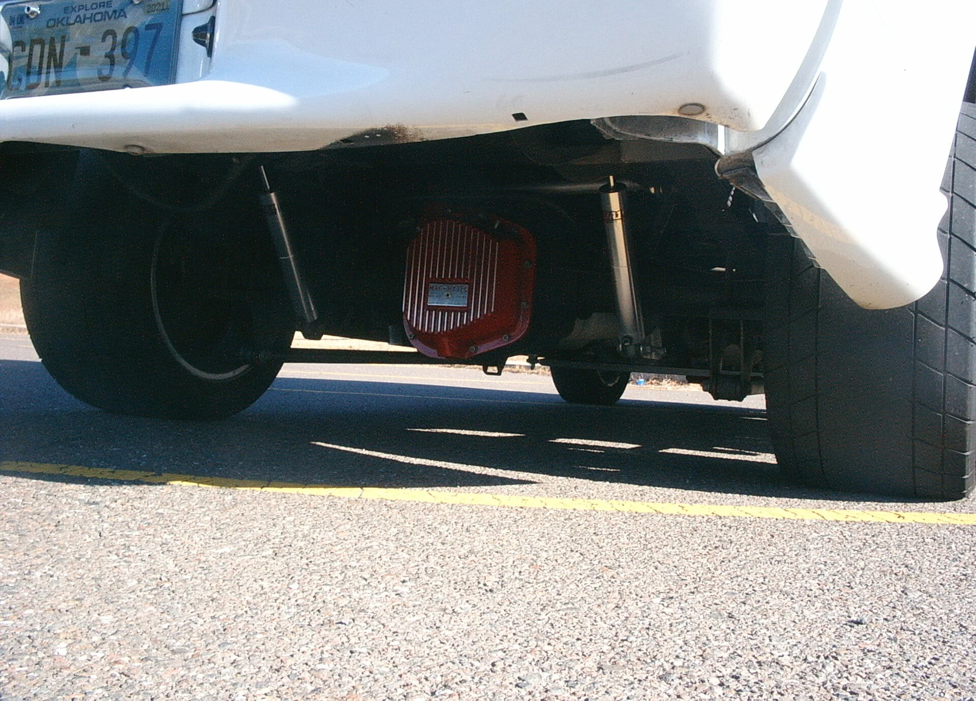

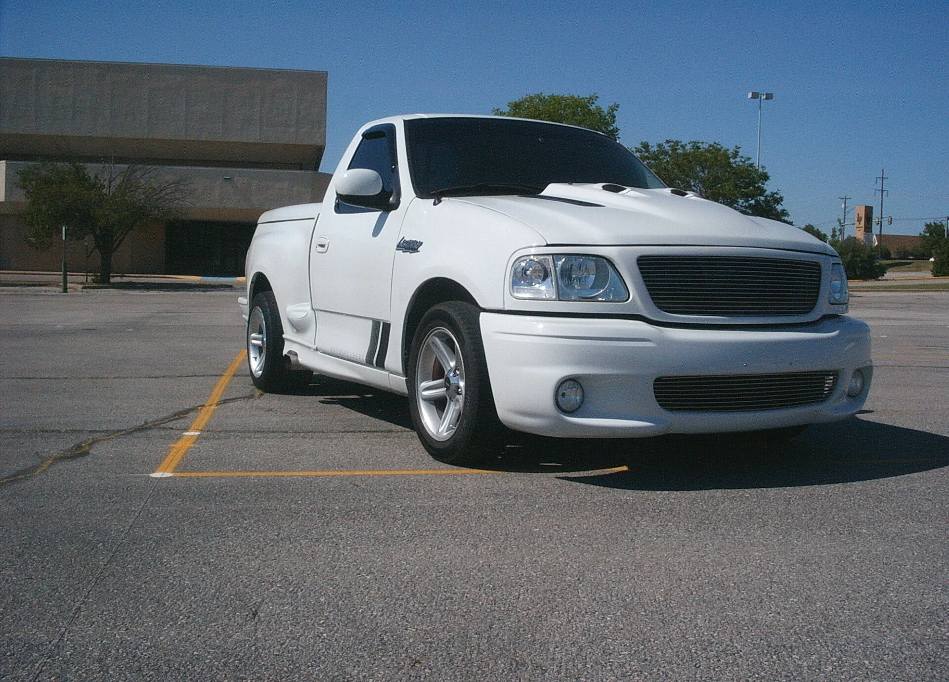

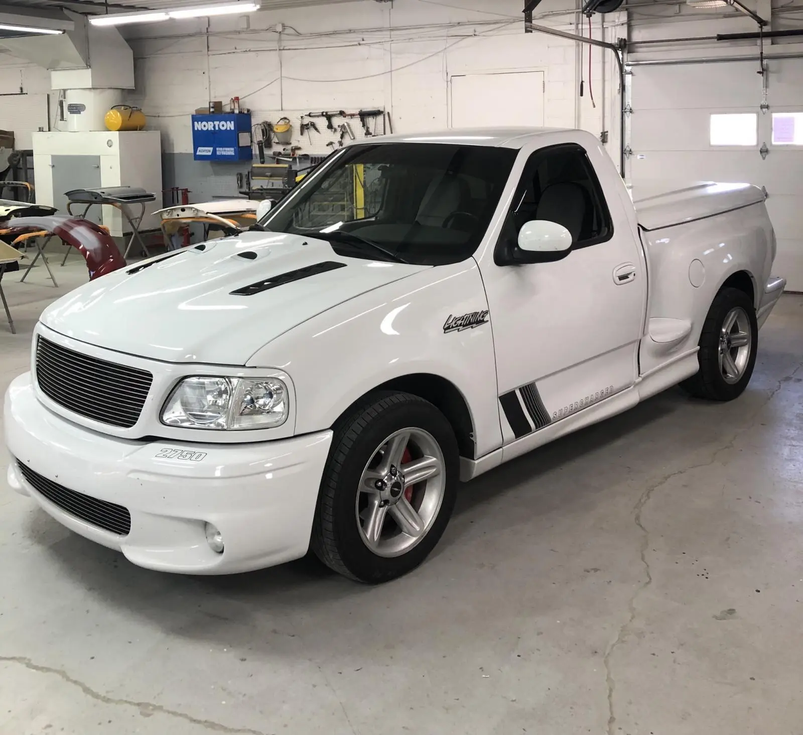

The Lightning is a whole nother story. Owned it a long time, and not much of it is stock anymore. For instance, the rims may look stock, but they are much modified. Stock they are 9.5 inches wide with 295/45-18 tires. I sent four rims to Weldcraft Wheels in Michigan. Had them, cut three inches out of one set, and put that three inches back into the other set. Final result being I now have 12.5 inch rims in the back with 345/35-18 tires, and 6.5 inch rims in the front with 215/60-18 tires. It has a Mag-Hytec differential cover and transmission pan. Both hold significantly more fluid than stock. JLP Long Bars, and a custom made panhard bar. Drive shaft safety loop and a custom made chrome-moly tubular transmission cross member. Stock Eaton blower ditched and replaced with a Magnum Powers blower, with a custom made cog drive and three pulley idler bar arrangement, with a manually adjustable tensioner. I could go on-and-on. But I'll stop here. LMAO!!
