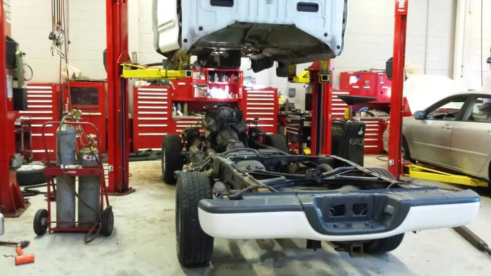

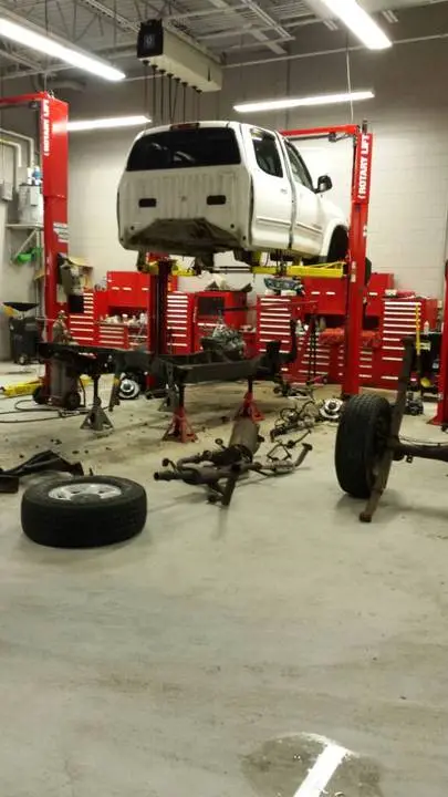

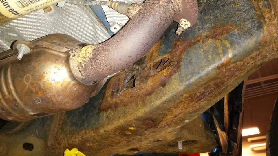

They rot pretty badly. So we change them. 40-60 hour jobs.
