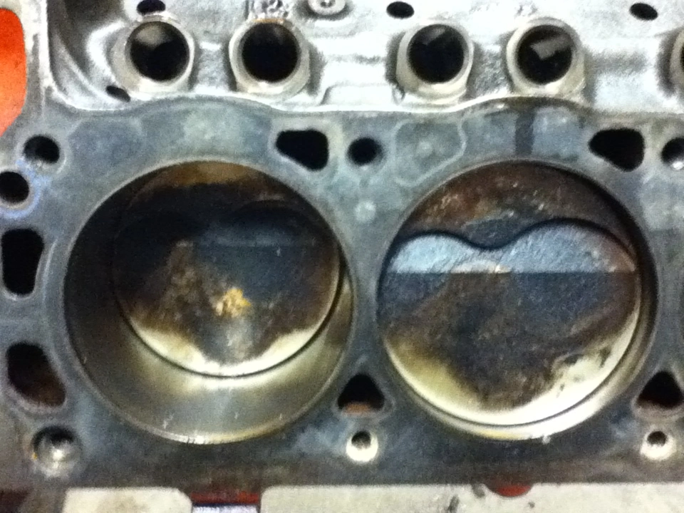

003-jpg.86977
THIS^^ Says to me that there was probably nothing at all wrong with the components used but that the entire assembly grenaded due to being WAY too lean.
Some of you guys that build and tear down motors like Legos can confirm or deny.
003-jpg.86977
that is a possibility, Would being lean lead to a valve dropping down? cuz thats what happend

003-jpg.86977
yeah it does seem like the mixture was rather lean. as for it causing the issue, no. he said he dropped a valve, which means either a bad valve spring, or the valve itself broke, and unless the motor was running really lean, that wont be the cause of his broken motor.
that depends on what you consider high mileage. a properly built 347 should go about 100k miles before you should have to go through it these days. i also agree that a 331 would be a better combination if you want a long lasting engine, and it doesnt lose much to the 347 in the area of actual useable power output.
I've seen detonation break valve stems a time or two. Not saying that's exactly what happened but I think I recall the OP indicating that one of the valves broke in a peculiar spot.

how can you guys tell it running lean? because the pistons or what?
if you look at the coloration of the pistons, you will see that towards the edge of the piston a white coloration. this indicates a lean condition in that area of the flame front. that indicates an overall lean condition. what you are looking for is a consistent color across the piston, and you want a dark charcoal look.
