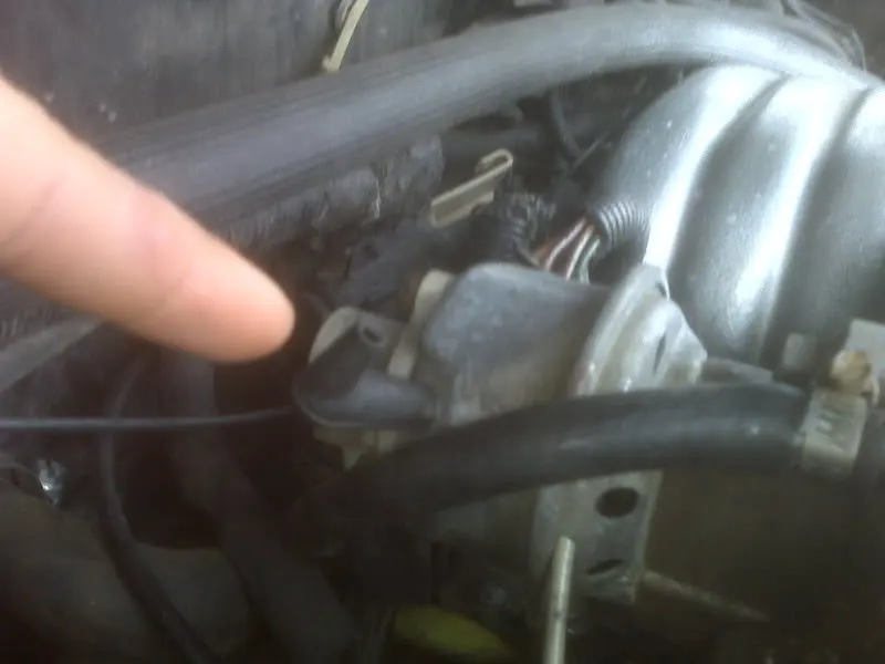

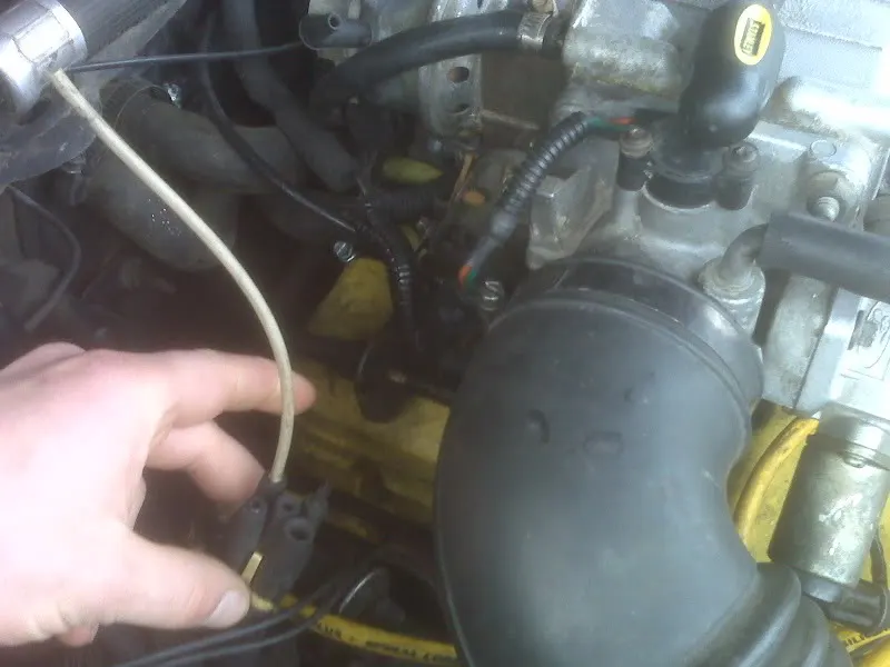

Hey guys, I bought this car about a week ago, and the previous owner told me he thought it might have a small vacuum leak because when the engine is cold and you first start the car, it will act like it wants to die, then the RPMS will pick back up then it sputters again. After the car gets warm, this problem goes away??? He said it could be from a vacuum leak but wouldnt it run crappy all the time if it was vacuum? Or could it be that since he doesnt have the fan shroud/overflow bottle on it anymore that it could be the coolant temp sensor thats not there anymore so the car doesnt know that its cold? Im just throwing ideas out there. Anyway I opened the hood up and was looking for possible vacuum leaks and I found a couple of thing that I have NO idea what they do or what they are. I have supplied 2 pics in hopes that someone could tell me if these could be my vacuum problem "if there is one..."
This 1st picture is me pointing at a rubber boot that looks to me like one of these vacuum lines is supposed to plug into. What is this boot for?
This 2nd picture is my holding a tiny cluster of what looks like small vacuum lines that have been cut. What are these for?

That is the EGR valve vacuum line.

Thanks for the indepth response! I appreciate it!!! So is this a big problem that he for some reason has these cut? Could it be because something IS bad and instead of trying to figure out and replace what was bad he just cut it out of the equation? One of my pics I posted you can see there is a longer white vacuum line coming out of the cluster. It will reach to the boot in the other pic. Do that need to be plugged in? Sorry Ive never dealt with EGR related issues before and alot of the info posted is in greek for me. LOL Am i hurting my car or it performance any by the way he has it set up now?

I noticed that thereis no list of your car's modifications or year. One of the simple things to do in StangNet is to update your sig. The wiring and other things changed several times between 79 & 95. That's why it is a good idea to use the sig under the user control panel (User CP) option. It allows you to post your car year & mods, which help greatly when troubleshooting things.
The line may have broken on its own. The hard vacuum lines are very brittle and over time they will break. Replace the broken lines with common rubber vacuum hose from your local auto parts store.
You may be able to re-connect the white vacuum line by simply pushing it bact into the rubber elbow on the EGR valve.
There are 2 white vacuum lines in that area: one is for the EGR and the other is for the Thermactor Air System (smog pump) diverter control valve. The rubber coupler in your picture has different line colors on each side. Push the plastic cover over the vacuum lines back so that you can see the line color before the rubber coupler. The EGR line will be green. The smog pump diverter control valve line will be white.

it's definitely not helping performance. A lot of people delete the egr when they put a cobra intake on (because the cobra intakes don't have the egr port). The correct way to delete the egr is by tuning around it. I had a faulty egr sensor and my car ran pretty crappy until I replaced it.
The diagram jrichker posted shows the whole vaccum line things and should show you where everything goes with a little study. Basically the vacuum from the intake goes to the the evr which is on the passenger strut tower, then goes to the black piece which ur white line is coming out of.
So u should connect the white line to the boot.
As the diagram shows there should also be lines connected to the smog stuff, which is the tube that runs under the intake tubing and connects to the back of the heads
