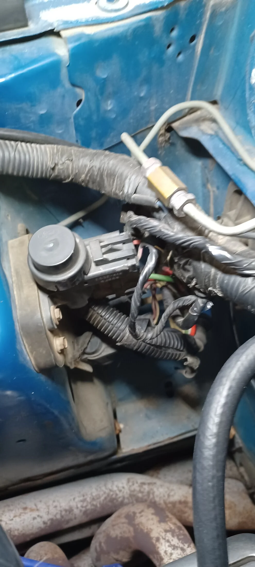

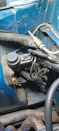

DemonGT Founding Member May 24, 2002 871 51 49 Sparta,WI Jan 8, 2024 #1 Jan 8, 2024 #1 What are these for on passanger side, back of strut tower? Attachments 20240108_135015.webp 132.3 KB · Views: 122

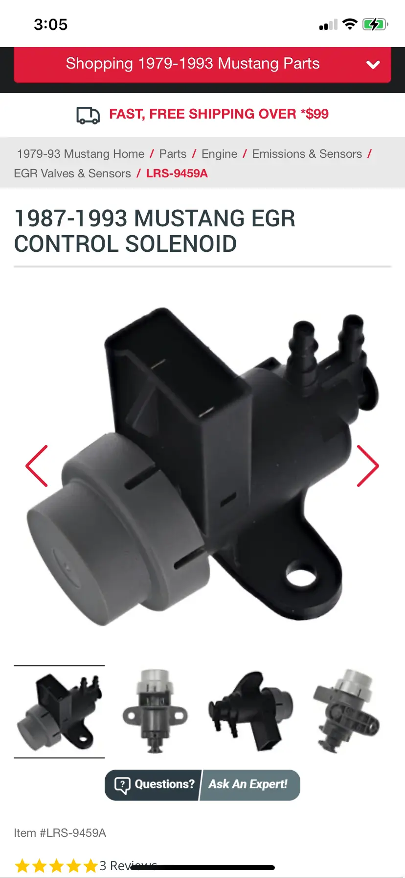

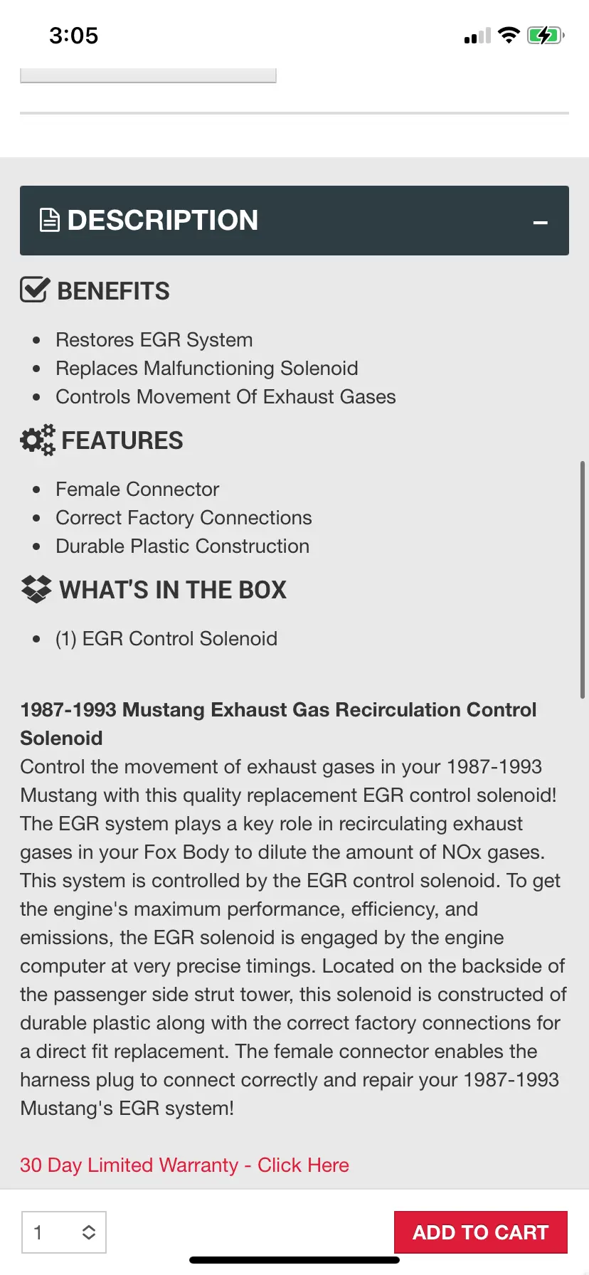

91AOD5.0LX I have a slight sag in my rear 5 Year Member Feb 20, 2021 1,086 1,028 133 Lake George NY Jan 8, 2024 #2 Jan 8, 2024 #2 EGR control Solenoid…. LMR gives a good description of what it does. I will post their write up: Hope this helps…. https://lmr.com/item/LRS-9459A/1987-1993-mustang-egr-control-solenoid?utm_source=google&utm_medium=cpc&adpos=&scid=scplp&sc_intid=&gclid=CjwKCAiA1-6sBhAoEiwArqlGPp7xsXW-3EZM0p8UzE7E3o_uRMhDiX6HzMPZMiK25uLFnaPNllMznRoCtIMQAvD_BwE Attachments IMG_2037.webp 47.3 KB · Views: 153 IMG_2038.webp 85.4 KB · Views: 155 Reactions: DemonGT
DemonGT Founding Member May 24, 2002 871 51 49 Sparta,WI Jan 8, 2024 #3 Jan 8, 2024 #3 What about all the junk under the EGR solenoid? Is any of that needed? My EGR is long gone along with the A/C.

Mcmahst 5 Year Member Jan 19, 2021 700 280 83 Laguna Woods CA, fort Mohave AZ Jan 8, 2024 #5 Jan 8, 2024 #5 Under the EGR control valve are the TAB/TAD solenoids. Those open and close vacuum valves that route air from the air pump. Reactions: Mustang5L5 and DemonGT
Mustang5L5 That is…until I whipped out my Bissell Mod Dude Feb 18, 2001 43,345 18,074 224 Massachusetts Jan 10, 2024 #6 Jan 10, 2024 #6 If your stock H-pipe and cats and air pump are gone, you can delete the TAD/TAB solenoid. I remove it all and cap the vac source line. Reactions: Mcmahst and AeroCoupe
