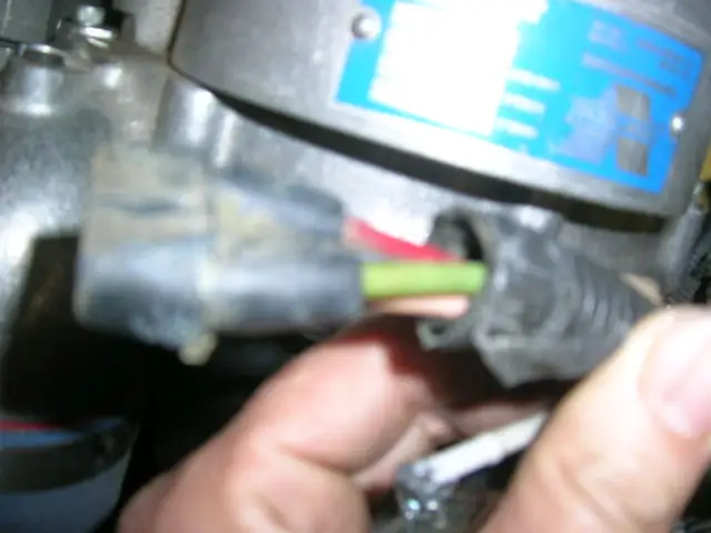

Y YELLOW 94 Founding Member Nov 19, 1999 428 0 17 Rio Rancho NM Mar 9, 2008 #1 Mar 9, 2008 #1 I have these vacuum lines coming out of the passanger side fender by my vortech. Does anyone know what they are. later Orlie Attachments DSCN2862.webp 12.7 KB · Views: 124
HGFireHazard Member Apr 10, 2005 460 0 17 Michigan Mar 9, 2008 #2 Mar 9, 2008 #2 They look like the smog vacuum lines.
earleys94gt Active Member Aug 31, 2003 1,223 16 49 Ashley, Ohio Mar 9, 2008 #3 Mar 9, 2008 #3 They are for the Air Injection(AIR) system, they go from the solenoids in the passenger fender to the componets of the Air Pump system.
Y YELLOW 94 Founding Member Nov 19, 1999 428 0 17 Rio Rancho NM Mar 9, 2008 #4 Mar 9, 2008 #4 So since I dont have a smog pump im thinking I can just plug them and not use them. Is this correct. later Orlie
HGFireHazard Member Apr 10, 2005 460 0 17 Michigan Mar 9, 2008 #5 Mar 9, 2008 #5 Absolutely, same thing I did
ronstang94 Member May 10, 2007 204 1 18 Phx, AZ Mar 9, 2008 #6 Mar 9, 2008 #6 two are for the smog pump, one is for the egr, and the other gos to the upper intake manifold. If you still run the egr you will need one of those, and im not sure of the purpose for the one to the intake manifold.
JJ95GTID Active Member Sep 22, 2003 1,141 4 49 Phoenix, AZ Mar 9, 2008 #7 Mar 9, 2008 #7 Red is supply for EGR. Goes to a part in the fender. Green is dithering line from part in fender to the EGR valve. You need both to run EGR valve. Orange is AIR bypass supply line. First part after the smog air pump.
