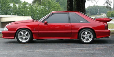

I already have 31 spline axles, had my rear built about 4 years ago when my posi went, So I need to find a 5 lug drum. Not really in a huge hurry so I am collecting parts, I think i am going to go with the sn95 spindles and such for the front, and keep drums in the back. ITs just a weekend car, I have draglites on it now, looks great, but I LOVE!!! The way the simmons fr17's look on a mustang. Trying to clone the car in the link below.. Just need the rims now..
