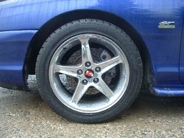

Baer brake package..
Baer M2300K kit..
SS braided brake lines Front (2) Rear (1)
Slotted rotors up front, stock drums in rear with new hardware
Hawk street+ pads front and shoes in rear
Stainless caliper bushings
93 Cobra MC
73mm calipers
New non adjustable proportioning valve
Stops better than stock 5.0 GT but right front locks up too early. Could use a bigger power brake booster but is ok around town but needs a lot of effort. Needs a 93 Cobra Booster unit for a cure.
